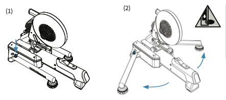

    Place your KICKR MOVE on a stable, level surface and open the legs by (1) pressing down on the blue leg-lock tabs and (2) pivoting the legs outward until they snap in place.
    (NOTE: Ensure the leg-lock tabs have popped back up and secured the legs in an open position.)
    Pinch Point Hazard. To prevent serious injury:
    ALWAYS keep your hand away from moving parts.
    NEVER reach into KICKR MOVE.
    ALWAYS lock KICKR MOVE when not in use.

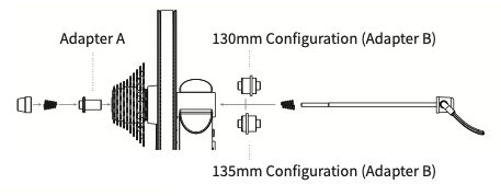

    For 130mm OR 135mm Quick Release
    Adapters Needed: A and B
    KICKR MOVE comes pre-configured out of the box for bicycles with 130mm quick release spacing. If you have a bicycle with 130mm spacing proceed to “Attaching your Bicycle”. For 135mm spacing, remove quick release skewer, reverse Adapter B and reinstall quick release skewer.

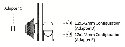

    For 142mm or 148mm Thru Axle
    Adapters Needed: C and D or E
    To be used with the 12mm thru axle supplied with bicycle.

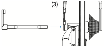

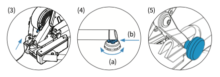

    For bicycles with quick release - Secure your bicycle by tightening the quick release acorn nut and clamping the quick release lever shut. The quick release lever is “open” when it curves away from the bicycle frame (1); the lever is “closed” when it curves towards the bicycle frame (2). The handle of the quick release skewer is always on the non-drive (non cassette) side of the KICKR MOVE. Only use the provided quick release skewer while using the KICKR MOVE.
    For bicycles with thru axle - Secure your bicycle by reinstalling your bicycle’s thru axle (3) and tightening to manufacturer specifications (4).
