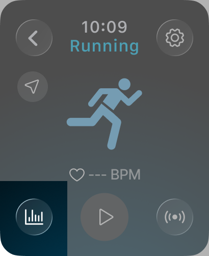

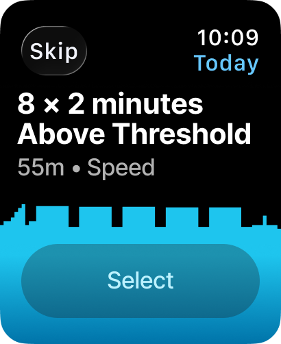

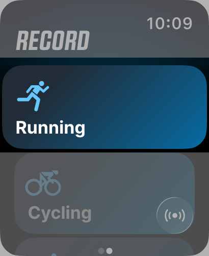

To access Planned Workouts, select the workout profile from the Home page for the activity type you want to start.
If you have a Planned Workout scheduled for today, it will appear before the Ready to Workout page and you can Select or Skip it, using the provided buttons.

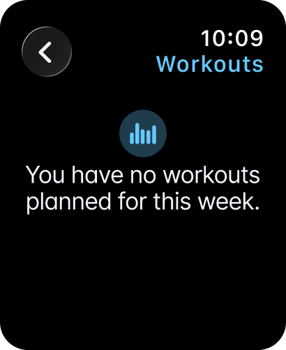

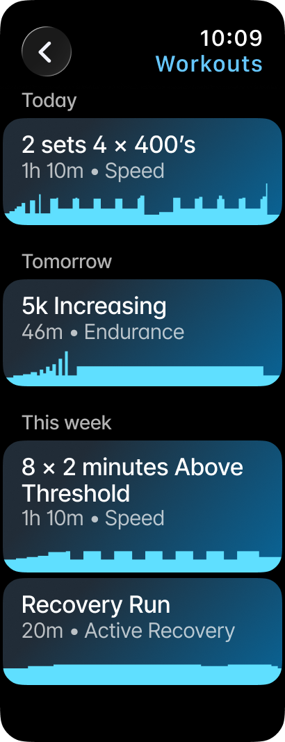

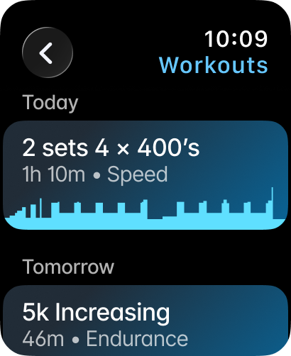

If you skip it, or you do not have a planned workout scheduled for today, you can still access all Planned Workouts for this week by selecting the Planned Workouts button from the Ready to Record page.
recordhighlighted.png Plannedworkouttoday.png readytorunplannedhighlighted.png

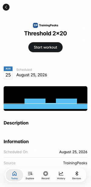

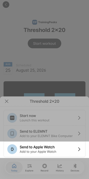

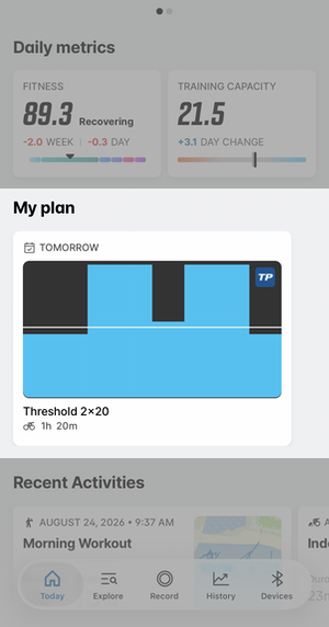

Planned workouts can also be loaded from the Wahoo app on the phone paired to the Apple Watch.  For any planned workouts scheduled within the next week:
  1. Select the planned workout from the My Plan panel on the Today tab
  2. Select Start Workout from the page that appears with the workout's details
  3. Select Send to Apple Watch

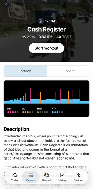

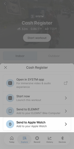

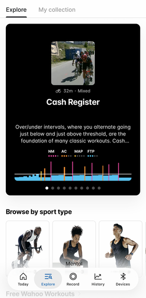

For Wahoo Pro subscribers, in order to load a SYSTM workout that has not been scheduled for this week.
  1. Open the Wahoo app and navigate to the Explore tab
  2. Select the workout that you wish to send to the Wahoo app on Apple Watch (supported types are Cycling and Running)
  3. Select the Indoor or Outdoor version of the workout and select Start Workout
  4. Select Send to Apple Watch

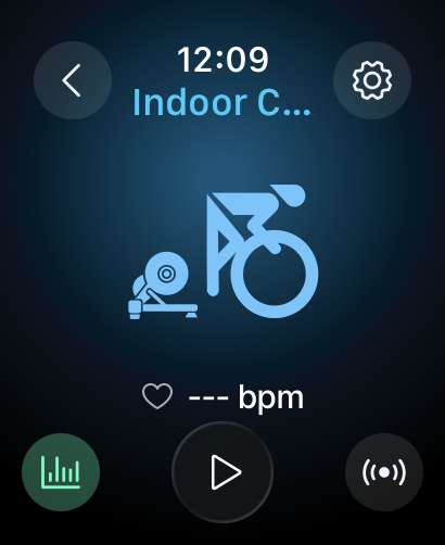

When a Planned Workout has been loaded to the Apple Watch, the Start page will display the Planned Workout icon in green.

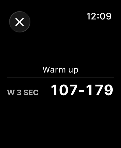

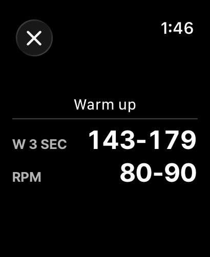

When the Start button is pressed, the workout will begin and a panel with the Planned Workout target (pace / power / hr / RPE) will appear.  This will auto-dismiss in ~6 seconds or can be manually dismissed by selecting the X in the upper left hand corner.
Once dismissed, you will still be able to see the target at the top of the Planned Workout data page.

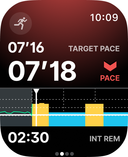

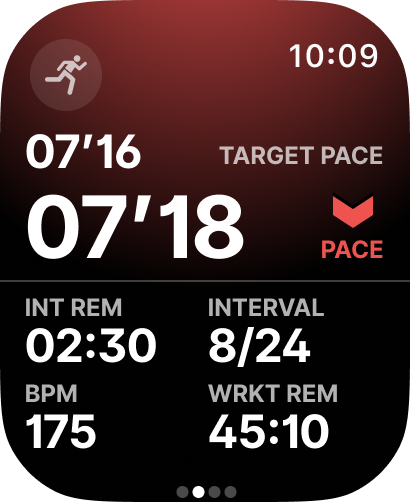

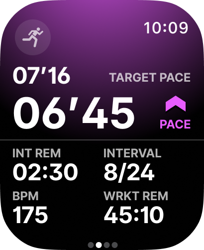

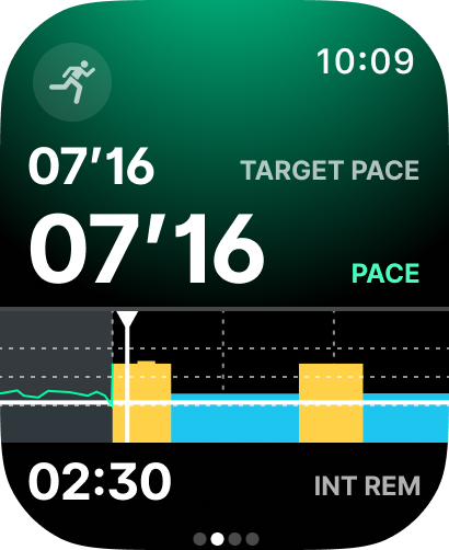

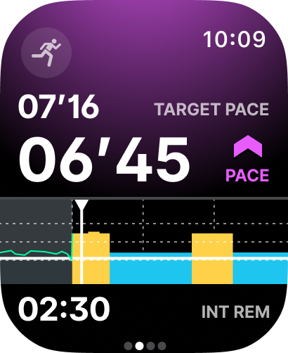

The background color of the Planned Workout data page will be colored accordingly to how you are performing based on the workout target.
  1. Red: Behind/below target
  2. Green: On target
  3. Purple: Above/over target
These settings will persist when scrolling down on the page to view the laps of the loaded Planned Workout.

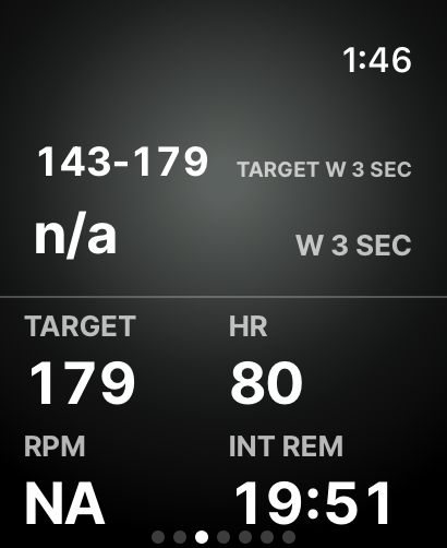

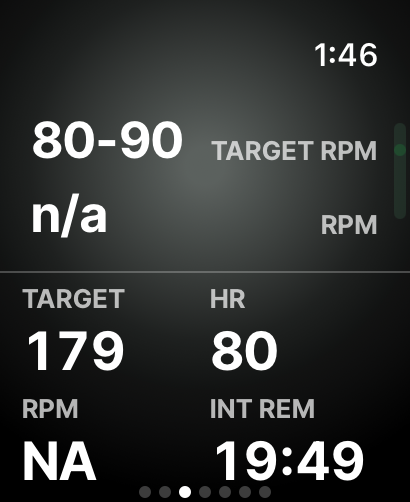

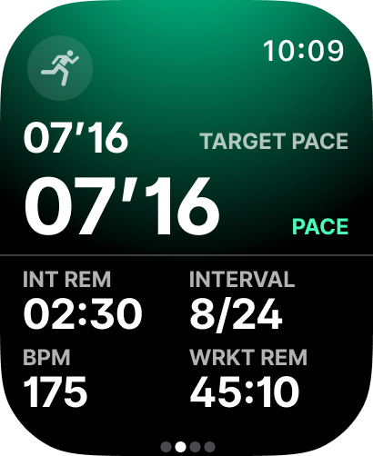

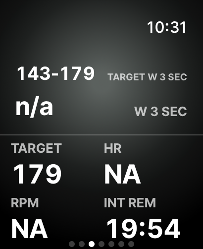

Data fields
The Planned Workout data page presents the primary target value for the current interval and your current output toward that target (target power), a secondary target value if one was loaded (eg target cadence), four customizable text data fields, a zoomable view of the structured workout graph showing the intervals in context.
Use the Apple Watch digital crown to scroll between the interval target values and view the workout's interval graph at different zoom levels.
The default data fields for the Planned Workout page are different for Cycling type vs Running type: Workout Profiles:
Cycling
  • Target Power + Current Power OR Target Cadence + Current Cadence
  • Target Heart Rate
  • Target RPE
  • Remaining Time/Distance - Interval
  • Remaining Time/Distance - Workout
Running
  • Target Pace, Target Cadence
  • Target Heartrate
  • Target RPE

If there is more than one target value type for an interval in the loaded workout (eg. target power AND cadence) you can scroll between the primary and secondary target values.
Up to four data fields will remain on screen as you toggle between the workout's target values. These will be the first four data fields set for that Workout Profile's Planned Workouts page.
planned workouttargetnotification.PNG plannedworkoutcadencetarget.PNG plannedworkoutpowertarget.PNG

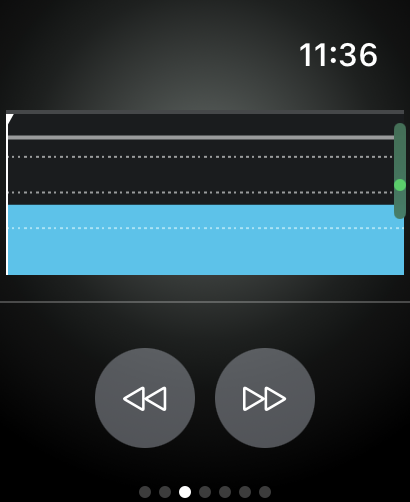

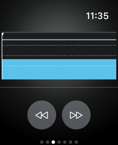

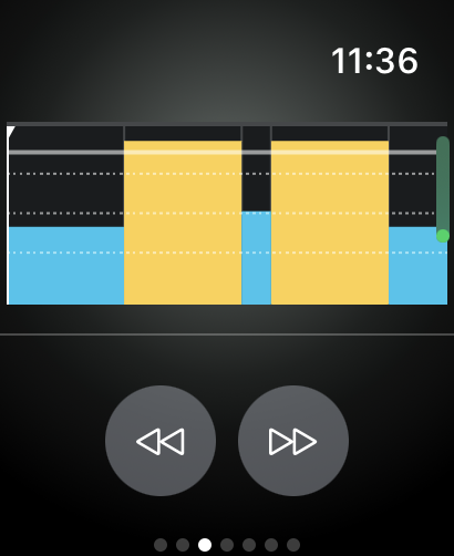

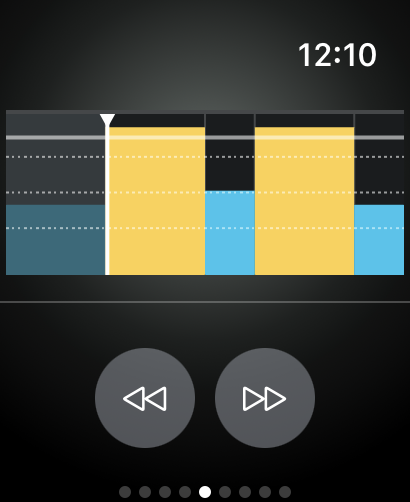

The next scroll will take you down to the workout's interval graph, which shows the current interval and your place in it with a white triangle and vertical line and presents the interval control buttons, which allow you to move backward/forward in the intervals of the workout (allows for skipping intervals, etc.)
The next 2 scrolls will zoom out to a wider view of the workout interval graph.

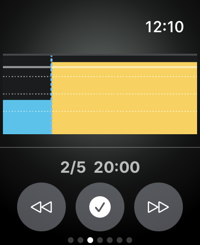

Skip an interval
In order to skip (or return to a previous interval):
  1. Using the digital crown, scroll down until you can see a view of the interval you want to skip to.
  2. Select the Forward or Back button to move between intervals. This will bring up a blue dashed line to indicate the current location of your selection. Use the Forward or Back buttons to move between intervals to your preferred interval.
  3. Use the Check button to select your preferred interval.  The workout will resume at the start of the interval you choose.

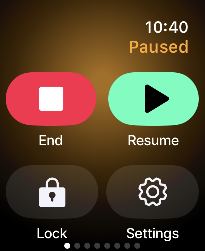

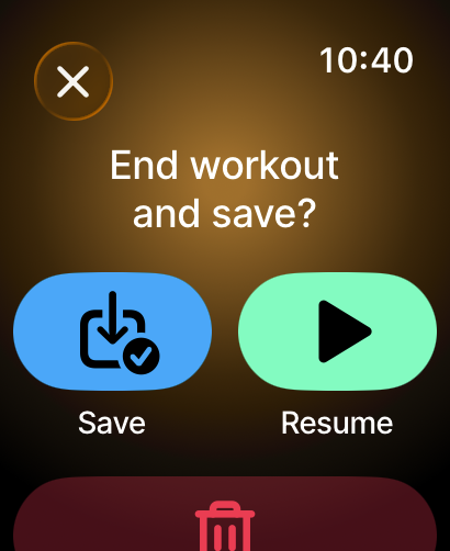

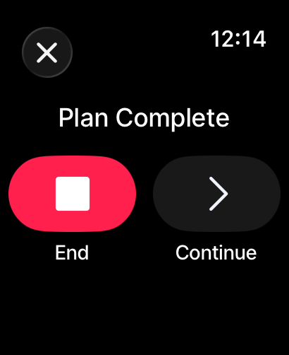

Once the Plan does finish, the Plan Complete page will appear, where the workout recording can be Ended, then saved or deleted or Continued. If Continue is selected, the ride/run will continue to be recorded as part of the current activity and current lap.
incoming-99516925-3578-4EA7-9E24-F084EFC823B7.PNG Pausedendorresume.PNG Saveordiscard.PNG
