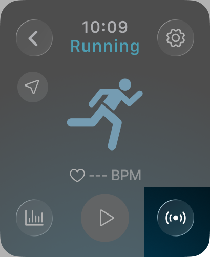

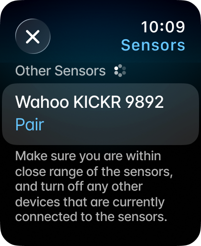

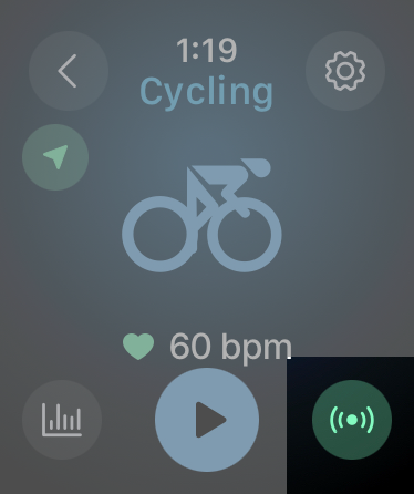

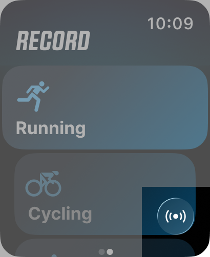

The sensor pairing menu can be accessed from the sensor icon ((*)) Home page, or the Ready to Record page for each workout profile.

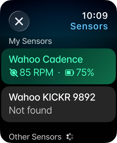

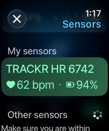

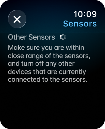

Within the Sensors page, if no sensors are currently paired to that workout profile, you will see any sensors available for pairing under Other Sensors. If you have paired sensors , you will see them at the top under My Sensors. They will show as connected in green with any available data showing when connected or Not found if not powered on, awake, or within range.

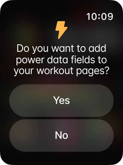

When pairing a new heart rate, cadence, or power meter sensor, you will be prompted to add relevant data fields.

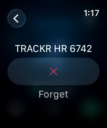

To forget a sensor, select it from the Sensors page, and tap Forget.
