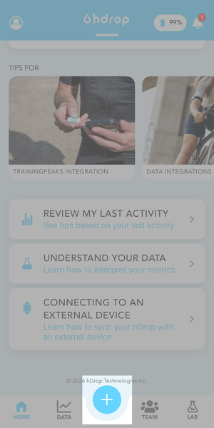

  1. Set up your hDrop hydration sensor with the hDrop app.

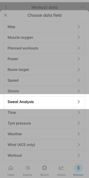

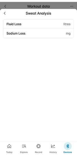

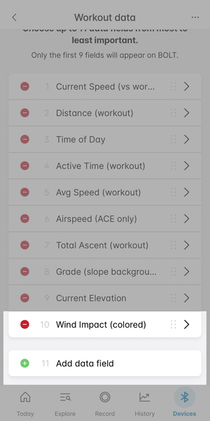

  3. Add the Fluid Loss or Sodium Loss data fields to your preferred workout profile(s).
  1. Ensure the ELEMNT is connected to the Wahoo app to sync any data field changes.

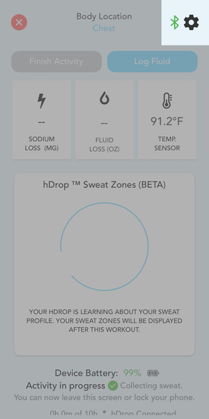

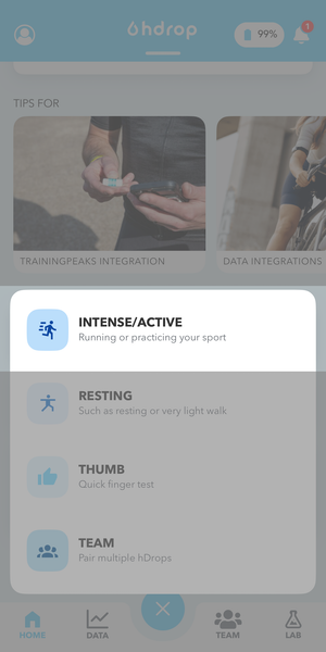

  2. Awaken the hDrop sensor by holding your thumb over the skin contact point on the sensor and selecting it in the upper right corner of the hDrop app.

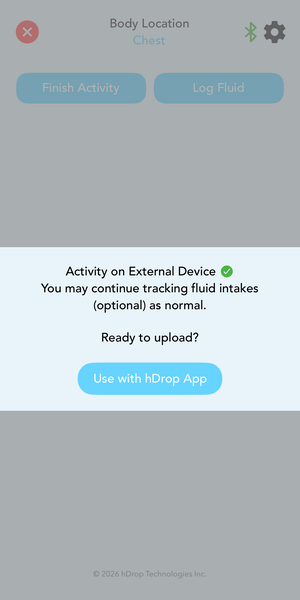

  3. Start a new Intense / Active activity in the hDrop app.

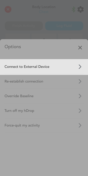

  4. Select the gear icon in the upper right corner of the hDrop app.

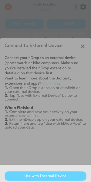

  5. Select Connect to External Device in the hDrop app.
  6. Select Use with External Device in the hDrop app.

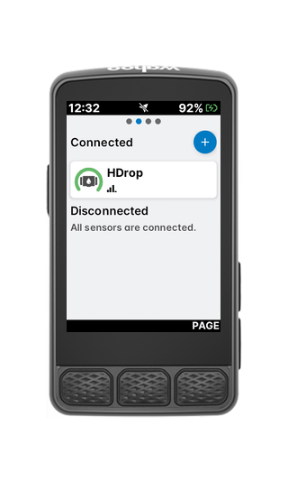

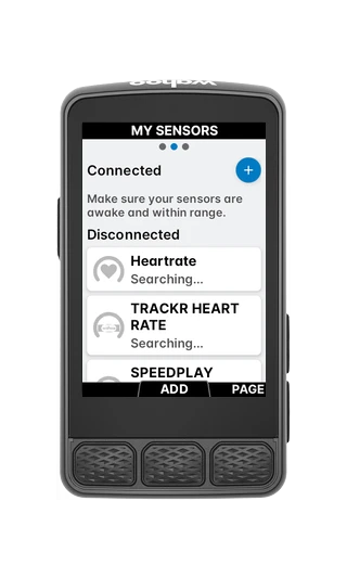

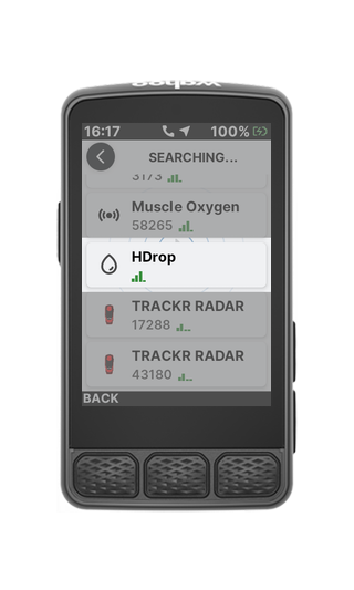

  7. Pair your hDrop sensor with the ELEMNT computer.
    • ELEMNT > Ready To Ride > Pair Sensor
    • ELEMNT > Settings > Sensors > Pair Sensor
  8. Wear the hDrop sensor according to its placement guidelines and confirm it shows as connected on the ELEMNT and the selected data fields are showing data.

*The hDrop sensor can only connect to one device via Bluetooth at a time. In order to transmit data from the sensor to the hDrop app, you must break the Bluetooth connection between the ELEMNT and hDrop sensor, either by turning off the computer, or unpairing the sensor from the computer.

  2. Start a new Intense / Active activity in the hDrop app.
  3. Select the gear icon in the upper right corner of the hDrop app.
  4. Select Connect to External Device in the hDrop app.
  5. Select Use with External Device in the hDrop app.

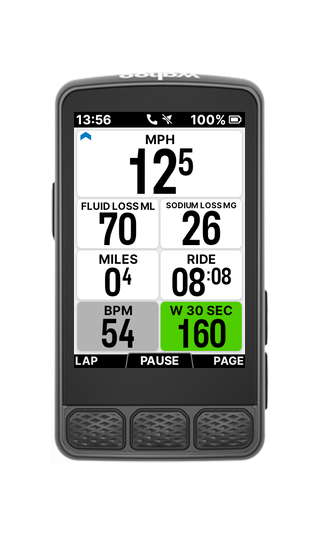

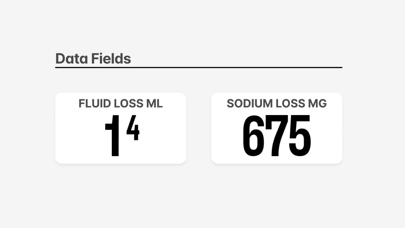

Data is processed by the sensor on three minute intervals, so Fluid Loss and Sodium Loss data will appear after ~3 minutes and update on ~ 3 minute intervals thereafter.
Data values are only recorded to the FIT file while the computer is un-paused. Data transmitted during a pause will not be recorded to the FIT file.
  • Fluid Loss will present your cumulative fluid loss in milliliters to that point in the ride on a white background.
  • Sodium Loss will present your cumulative sodium loss in milligrams to that point in the ride on a white background.

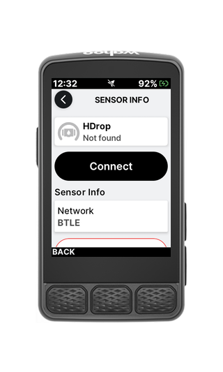

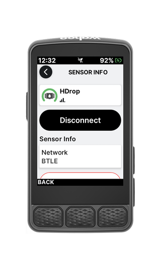

In the case that you forget to start the recording in the app before your ELEMNT connects to the hDrop sensor, you can temporarily disconnect the sensor by accessing its sensor details page and selecting Disconnect. You can then complete the app’s start recording process, and then select Connect to reconnect the sensor.
Once a ride is completed, you must break the connection between the ELEMNT and the hDrop sensor in order to be able to sync your hydration data from the hDrop sensor to the hDrop app. To assist with this process, the ELEMNT computer will automatically disconnect from the hDrop sensor for 15 minutes after a ride is ended. You can then manually reconnect the hDrop sensor to the hDrop app and sync your data.
If you have to end a ride before you intended to do so, you can override this 15 minute temporary disconnection by accessing the hDrop’s sensor details page and selecting Connect.
