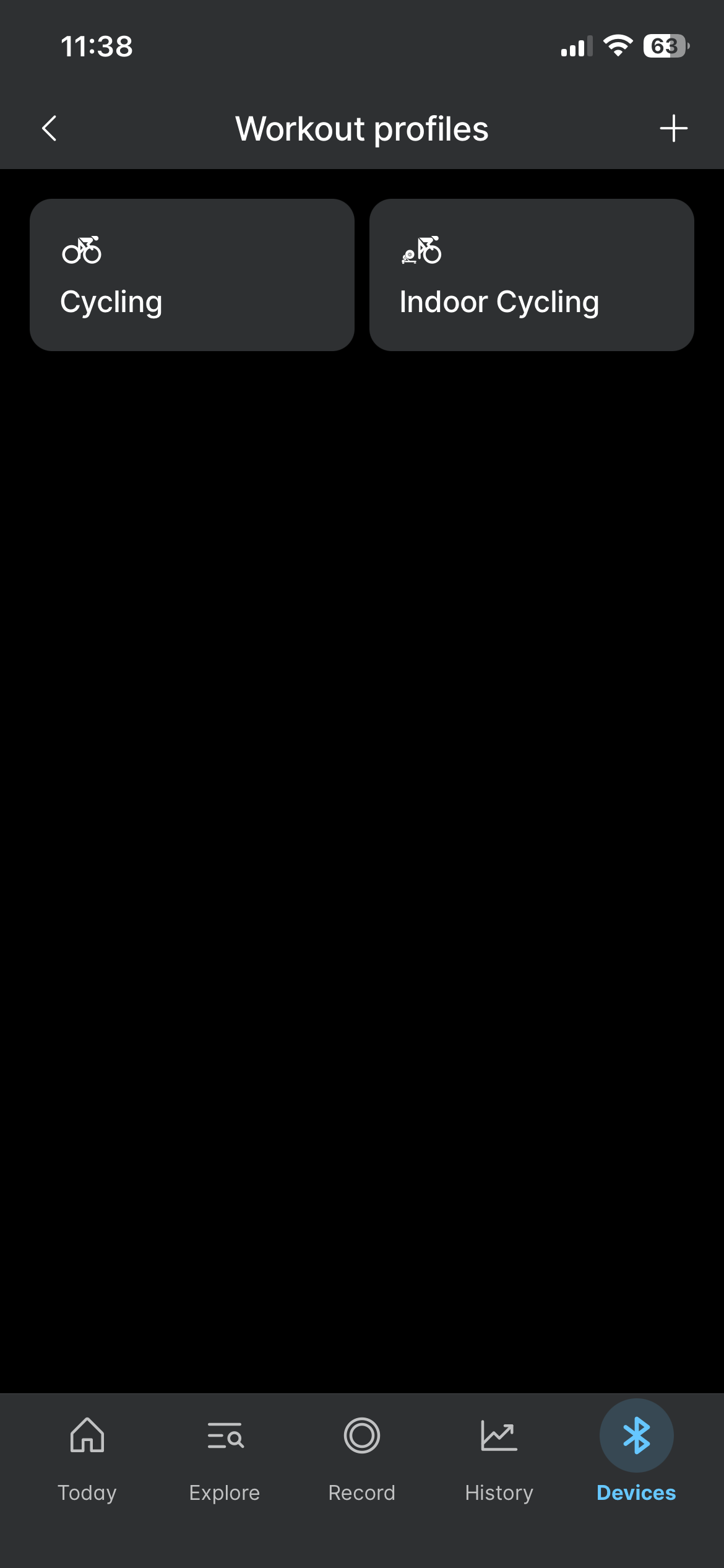

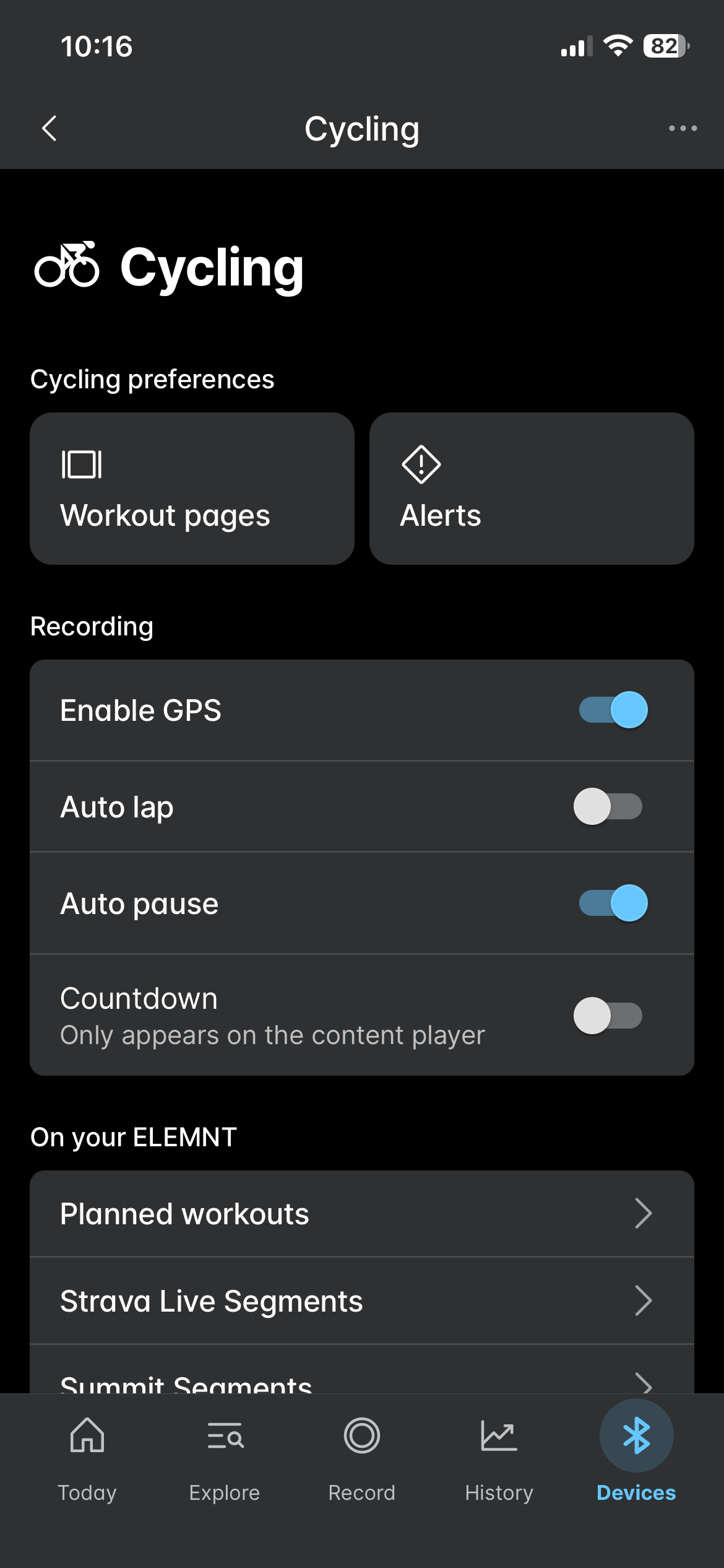

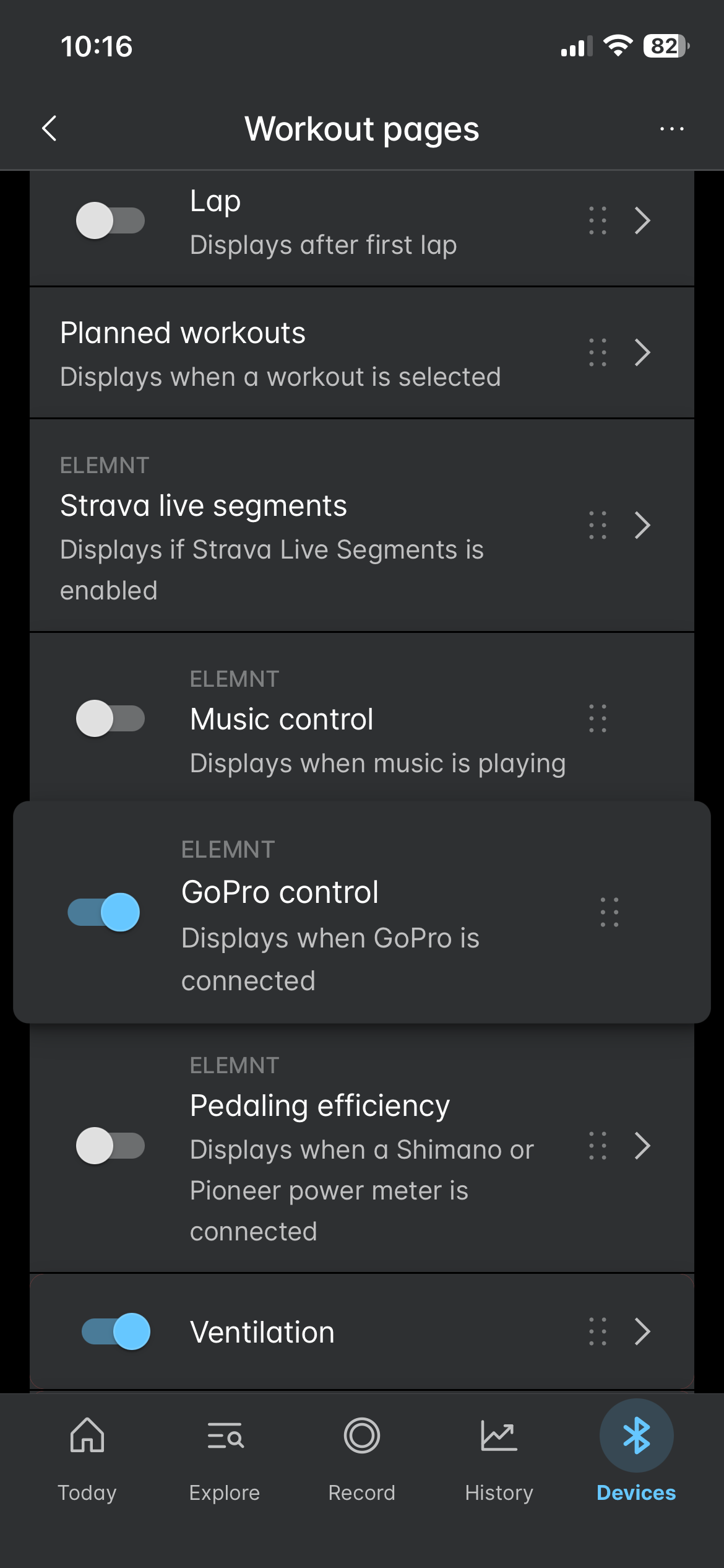

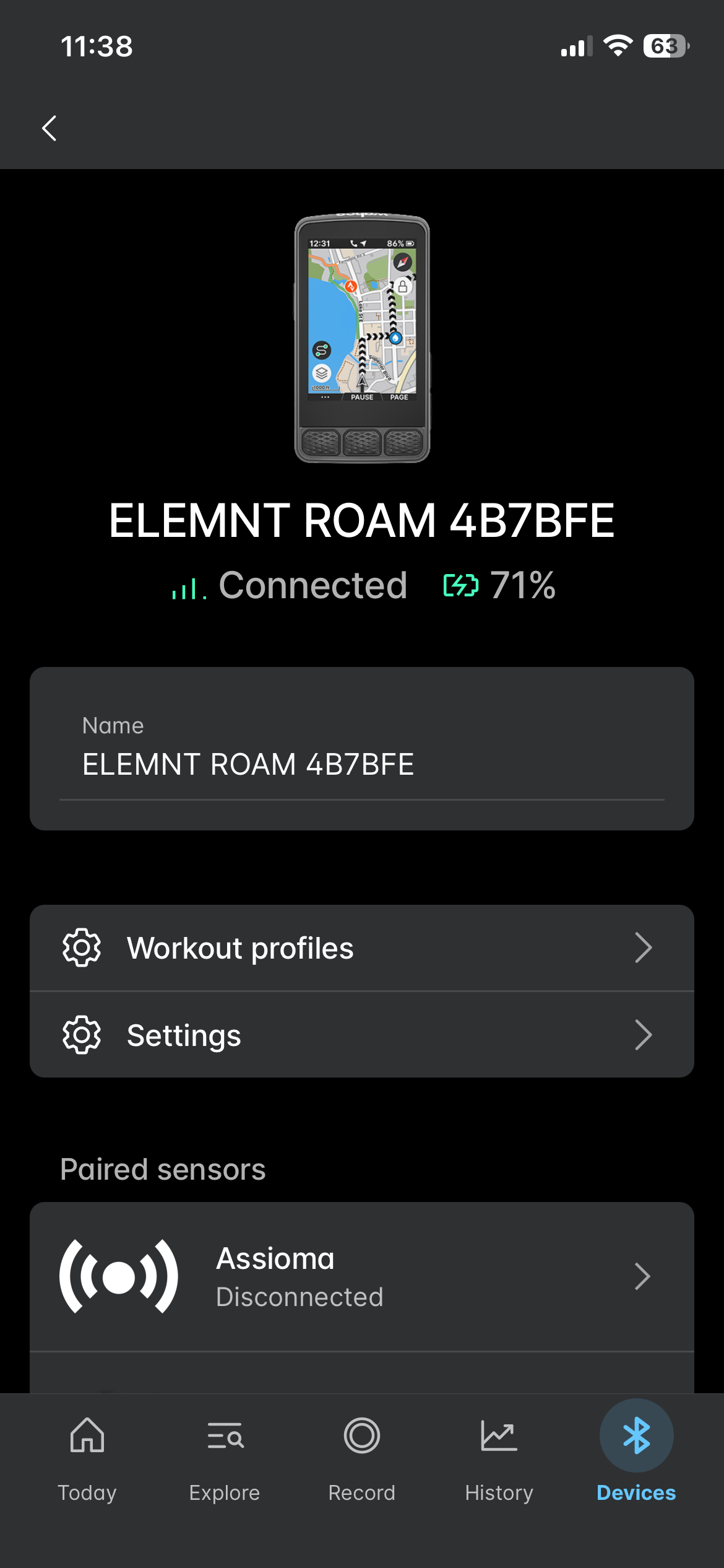

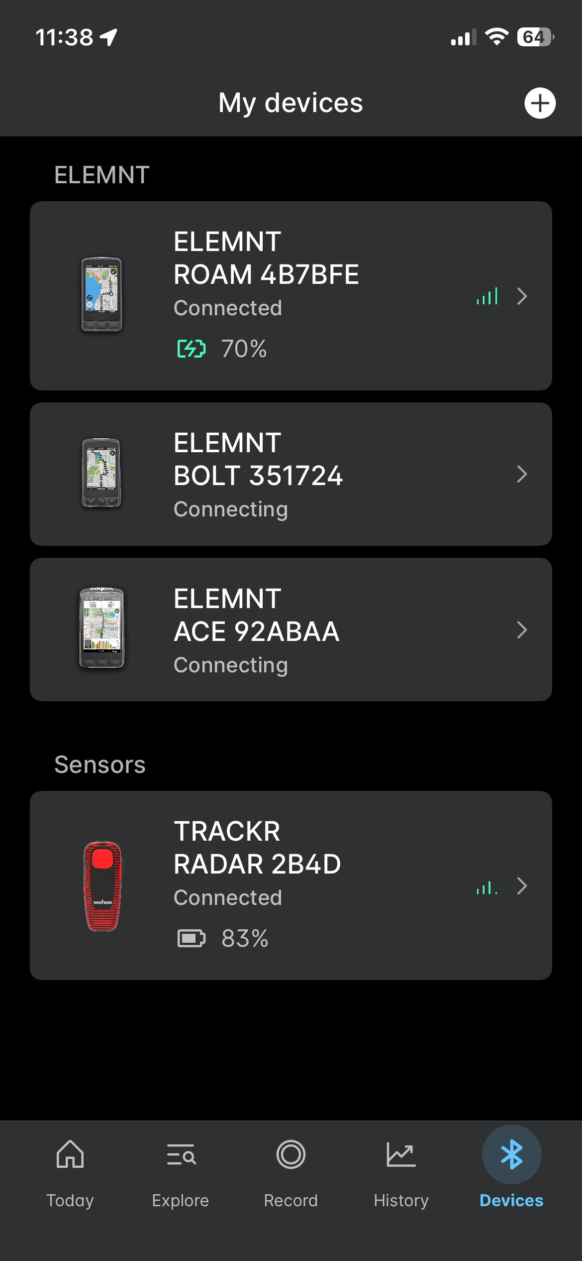

  1. Enable the GoPro Control page in the Wahoo app at Devices tab > Select your ELEMNT device > Workout profiles > Select your workout profile > Workout pages >  GoPro control
  1. Pair the GoPro to the ELEMNT computer.

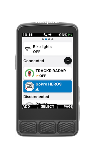

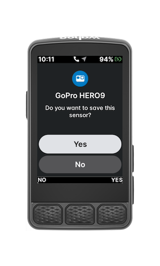

  3. Then, on your ELEMNT computer,

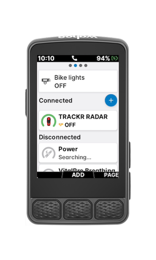

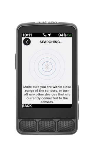

    1. Tap the left power button to access the Menu page.
    2. Use the front right button to scroll across to the Sensors page > Add
    3. Select the GoPro from the list of available sensors.

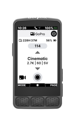

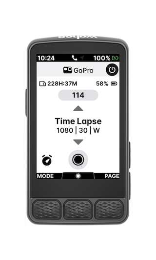

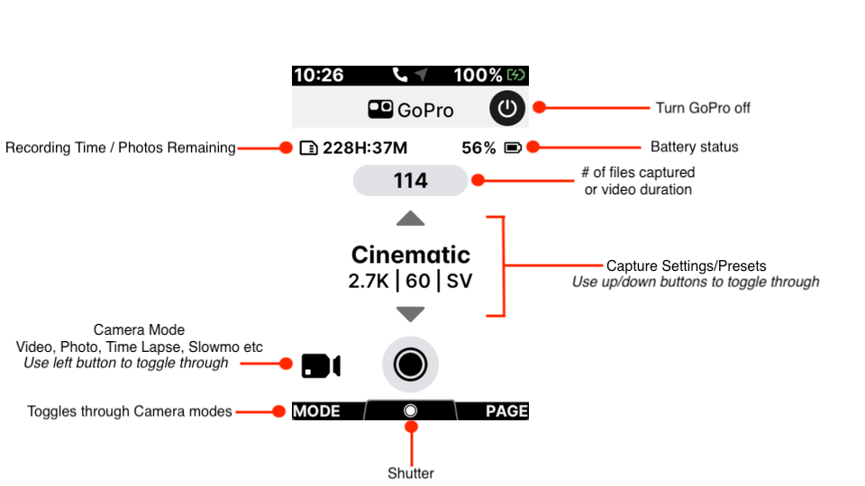

GoPro Control page
The GoPro Control page will be visible if a GoPro camera is connecting, actively connected or has been actively connected after a ride has been started, is added to the page stack, and will display:
  • Recording time / photos remaining (based on SD card capacity)
  • Camera battery status

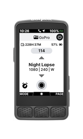

  • Currently selected camera mode: Video, Photo, Time lapse, and custom modes (based on camera mode presets)
    • Toggled by using the left front button.
    • Video
      • Duration of video currently recording OR
      • Number of video files captured
    • Photo
      • Number of image files captured
    • Time Lapse
      • Duration of time laps currently recording OR
      • Number of time lapse files captured

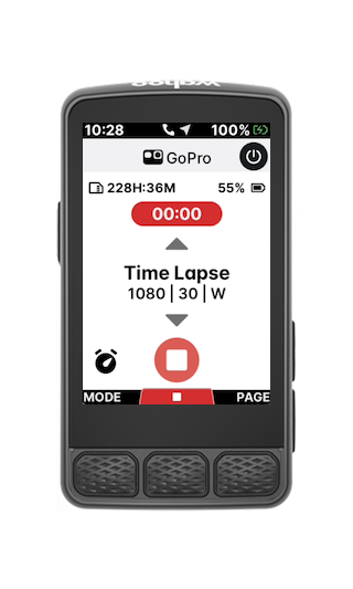

  • A shutter button
    • Actuated using the middle front button
    • Will display red when recording
    • Video / Time lapse - toggle recording on/off
    • Photo - capture image

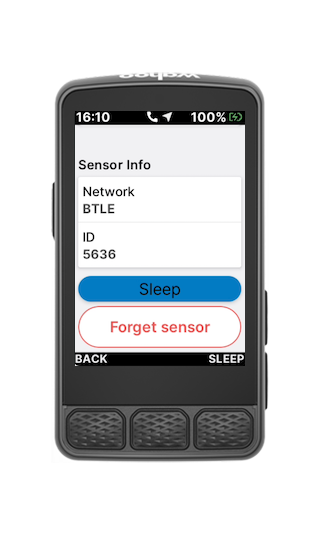

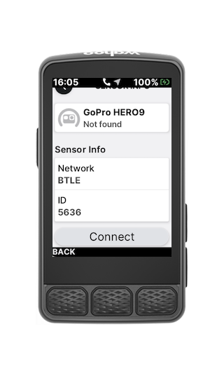

Sleep/standby/off and Reconnect
  • When a GoPro is actively connected, you can put the camera in sleep/standby mode using the front right button or touchscreen (ACE and ROAM 3 only) when in the GoPro sensor settings, from the Sensors menu page.

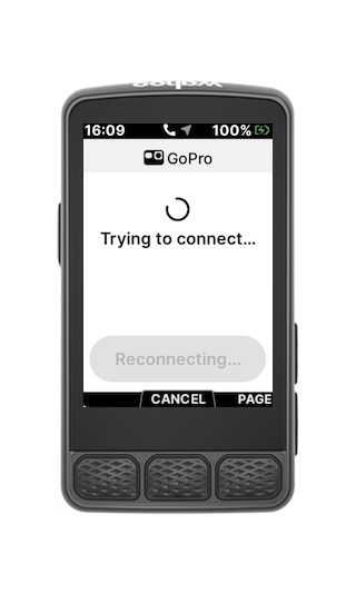

  • For Hero 9, 10, and 11 -- While asleep, either from Auto-Off, the SLEEP button on the ELEMNT or manually turning the GoPro off, you can waken/re-connect using the CONNECT button.
  • Left power button > Sensors page > Select GoPro > Scroll down to Connect.
  • If not previously connected during the ride, connecting the camera on the his button will also make the GoPro Control page visible again.
Due to a GoPro firmware limitation, if a Hero 12 goes to sleep/time out, the camera must be set into Quik App pairing mode again before attempting to use the CONNECT buttons on the ELEMNT.
