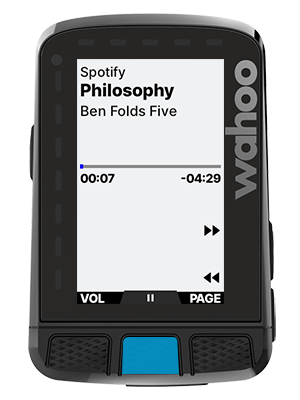

Music

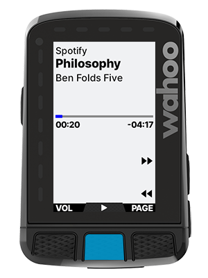

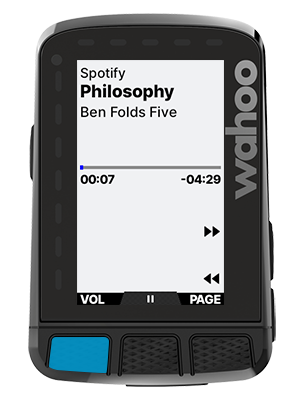

Pause / Resume
  • Middle button

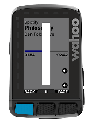

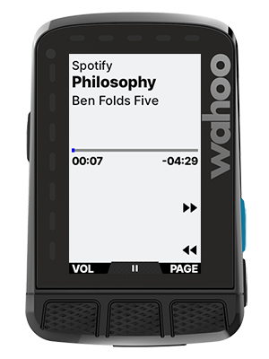

Skip to next track
  • Upper right side button
Back to track start / previous track
  • Lower right side button, once to return to track start, twice to reach previous track?
r2-musiccontrol-skiptrackforward-r300.png r2-musiccontrol-skiptrackback-r300.png blanktrans300x400.png

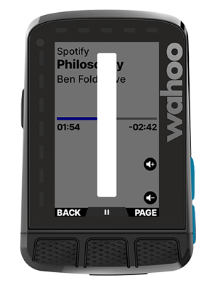

Volume
  • VOL (left front button),
  • then (+) or (-) (right side buttons to adjust volume up or down),
  • then Back (left front button) to return to main music control screen.

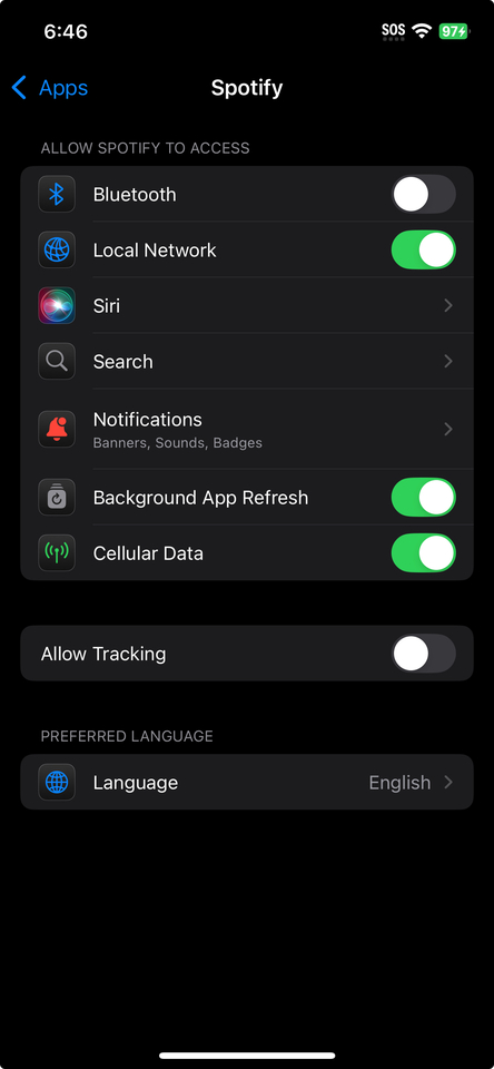

For iOS devices
If the Spotify app is installed on your iOS device, please ensure that Bluetooth permission is disabled under Apps > Spotify.
Even if you are using a different media app, this Spotify setting can still disrupt notifications.
Turning off this setting does not prevent the use of Bluetooth headphones.

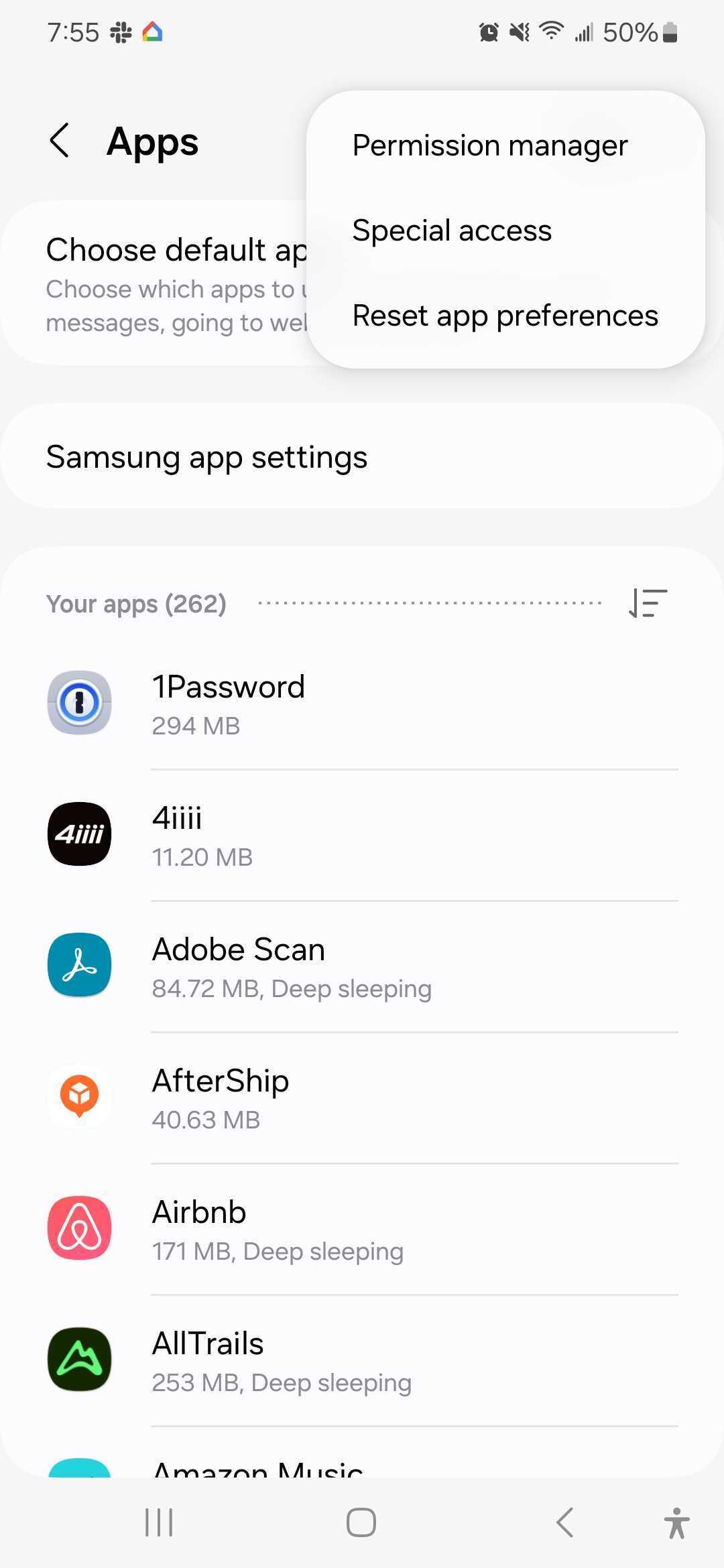

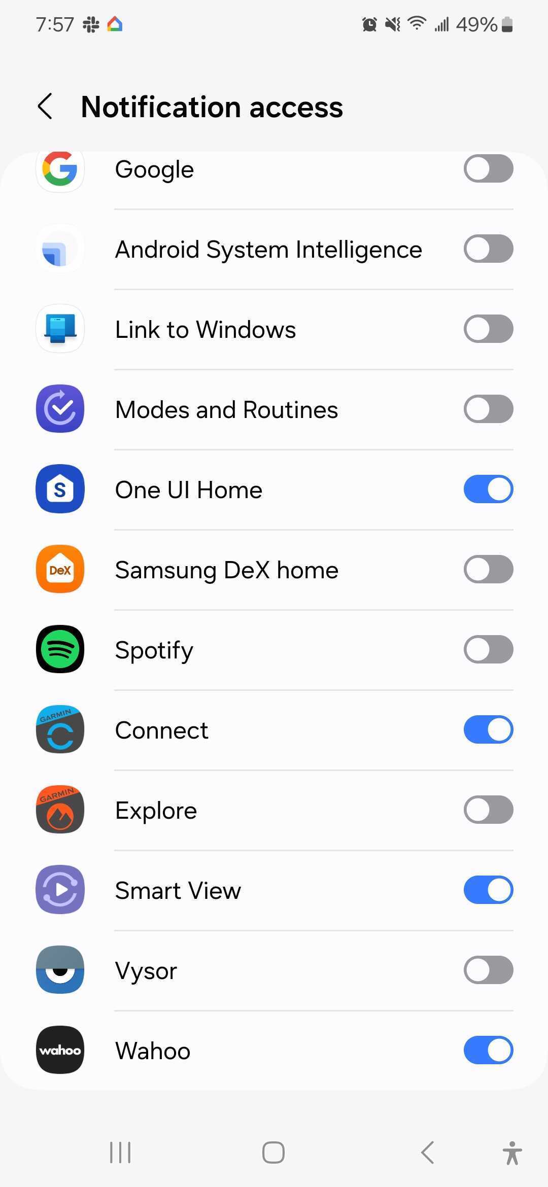

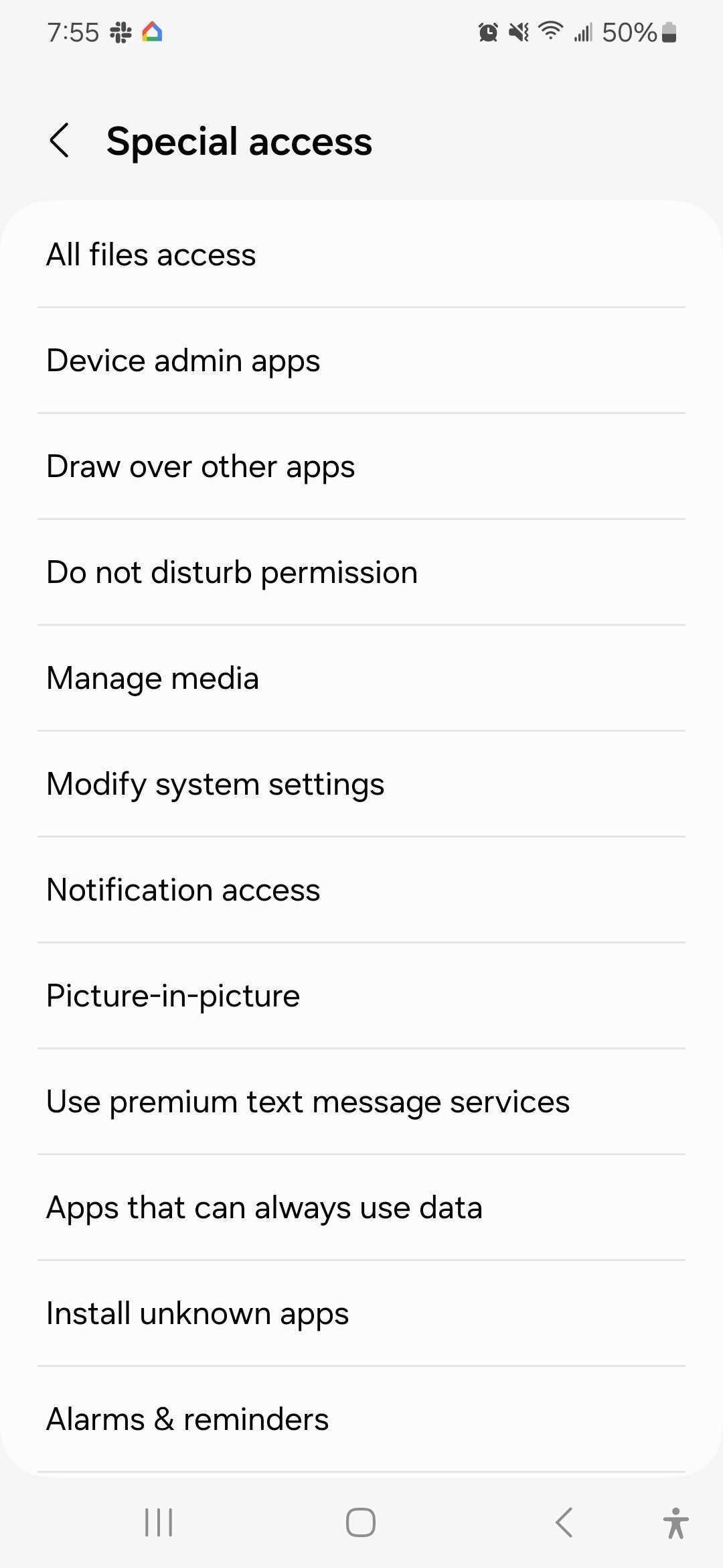

For Android devices
To fully enable notifications, Android users may need to turn on notification access under Settings > Apps > Special Access > Notification access.
