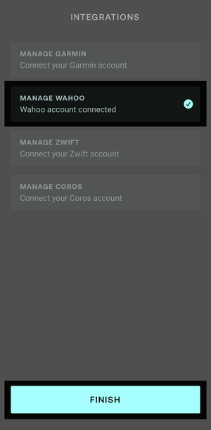

  • Ride data recorded on the ELEMNT computer must be synced via Wi-Fi or the Wahoo app to the Wahoo Cloud, and then on to the FLOWBIO app.  To accomplish this

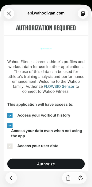

    • A Wahoo and FLOWBIO Cloud account connection must be established in FLOWBIO app
    • Your ride must be synced to the Wahoo Cloud as normal via Wi-Fi or the Wahoo app.
Set up your FLOWBIO sweat sensor
  1. Set up your FLOWBIO sweat sensor with the FLOWBIO app. See FLOWBIO’s Instruction Manual for more details.

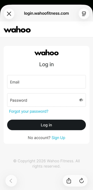

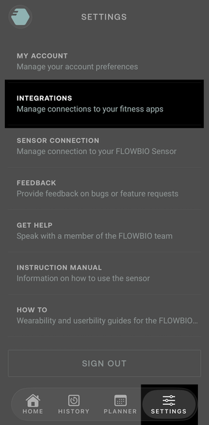

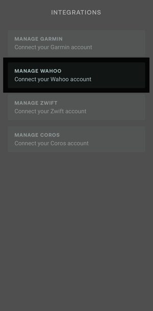

  2. Link your Wahoo account to your FLOWBIO account in the FLOWBIO app to allow for properly contextualized analysis in the FLOWBIO app post-ride.
flowbio-settings-integrations-300.png flowbio-managewahoo-300.png flowbio-loginwahoofitness-300.png
flowbio-authorizewahoofitness-300.png flowbio-wahooconnected-300.png blank-300x10.png

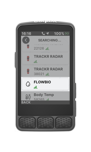

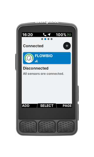

  2. Pair your FLOWBIO sensor with the ELEMNT computer.

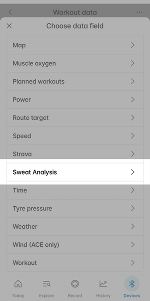

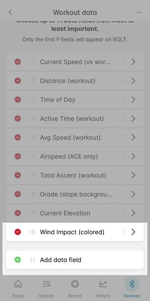

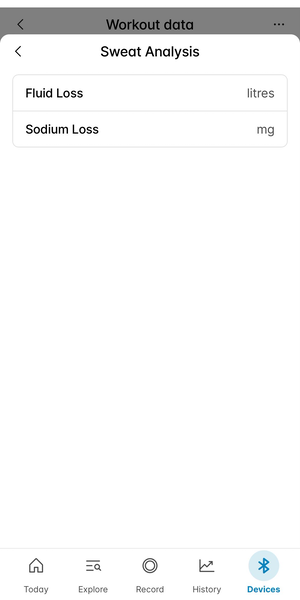

  1. Add the Fluid Loss or Sodium Loss data fields to your preferred workout profile(s).
    • Wahoo app > Devices tab > Select your ELEMNT device > Workout profiles > Select your chosen workout profile > Pages > Select your chosen data page > add/replace data field > Sweat analysis > Fluid Loss or Sodium Loss
      For more details on customizing data fields on ELEMNT computers, see Customize workout profiles and pages for ELEMNT ACE, BOLT 3, or ROAM 3.

  2. Wear the FLOWBIO sensor according to its placement guidelines and confirm it shows as connected on your ELEMNT device before starting your ride.

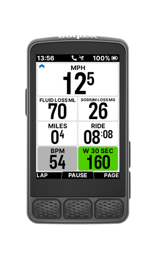

Either of the selected data fields will appear as long as data as transmitting. Data values are only recorded to the activity file while the computer is un-paused. Data transmitted during a pause will not be recorded to the activity file.
  • Fluid Loss will present your cumulative fluid loss in milliliters to that point in the ride on a white background.
  • Sodium Loss will present your cumulative sodium loss in milligrams to that point in the ride on a white background.
Fluid Loss will take at least 10 minutes to initially appear on the computer.
Sodium Loss will generally take 10-20 minutes to initially appear, and may not appear at all, depending on the composition of your sweat.
Once sweat data appears, the sensor will update the computer on 1 minute intervals.

Fluid Loss or Sodium Loss does not appear as an available data field in the Wahoo app
  • Ensure your ELEMNT firmware and Wahoo app are up to date on versions 302533 and 6.86.0 respectively.
  • Ensure that a FLOWBIO sensor has been paired at least once.

  • Confirm the FLOWBIO sensor is powered on, paired with the ELEMNT, and worn correctly. See FLOWBIO’s support articles for proper fitting instructions (Upper arm | Upper back | 3rd party HR strap).

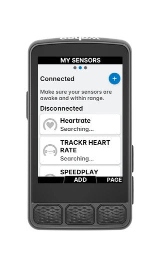

  • Check the Sensors menu on the ELEMNT to verify the FLOWBIO shows as connected. If the sensor recently disconnected, forget and re-pair.
