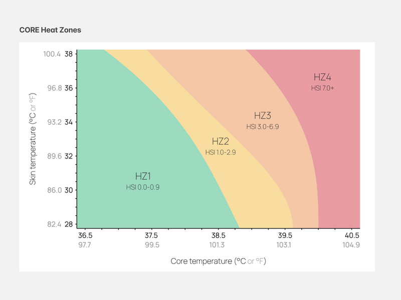

  • Heat Strain Index (HSI) – A composite metric combining body temperature and skin temperature trends to quantify overall heat stress and physiological strain during training or racing.
  • Heat Zone – A simplified visual indicator of an athlete’s thermal state (e.g., green to red scale), based on real-time body temperature thresholds and environmental conditions, correlated to their current Heat Strain Index values.

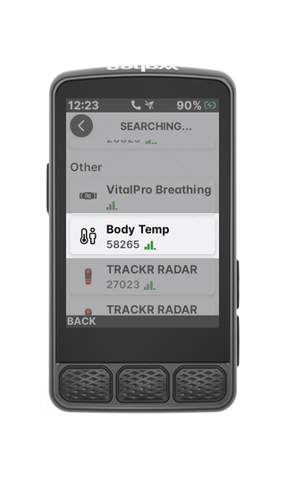

  3. Awaken the CORE sensor.
  4. Pair your CORE sensor with the ELEMNT computer.

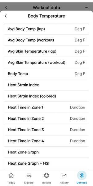

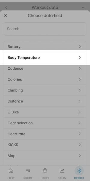

  1. Add the Heat Zone and Heat Strain Index, or other Skin Temperature or Body Temperature data fields to your preferred workout profile(s).
    • Wahoo app > Devices tab > Select your ELEMNT device > Workout profiles > Select your chosen workout profile > Pages > Select your chosen data page > add/replace data field > Body temperature > Select your preferred data field
      For more details on customizing data fields on ELEMNT computers, see Customize workout profiles and pages for ELEMNT ACE, BOLT 3, or ROAM 3.

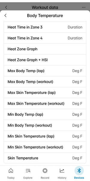

  • Available data field options are:
    • Heat Strain Index
    • Heat Strain Index Colored
    • Heat Zone Graph
    • Heat Zone Graph + HSI
    • Heat Time in Zone 1
    • Heat Time in Zone 2
    • Heat Time in Zone 3
    • Heat Time in Zone 4
    • Body Temp – simple text fields, no background color
      • Body Temp – current
      • Avg Body Temp (workout)
      • Max Body Temp (workout)
      • Min Body Temp (workout)
      • Avg Body Temp (lap)
      • Max Body Temp (lap)
      • Min Body Temp (lap)
    • Skin Temperature – simple text fields, no background color
      • Skin Temperature – current
      • Avg Skin Temp (workout)
      • Max Skin Temperature (workout)
      • Min Skin Temperature (workout)
      • Avg Skin Temperature (lap)
      • Max Skin Temperature (lap)
      • Min Skin Temperature (lap)

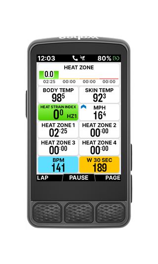

  3. Begin your ride. Heat Zone, Heat Strain Index, or other values will appear in real time on the configured page once the CORE sensor begins streaming data.
Use your CORE body sensor
Before a ride
  1. Awaken the CORE sensor before confirming it is connected to your computer.
  2. Ensure you have enabled data fields for body temperature related data in your chosen workout profile.
During a ride
Any of the selected data fields will appear as long as data as transmitting. Data values are only recorded to the FIT file while the computer is un-paused. Data transmitted during a pause will not be recorded to the FIT file.

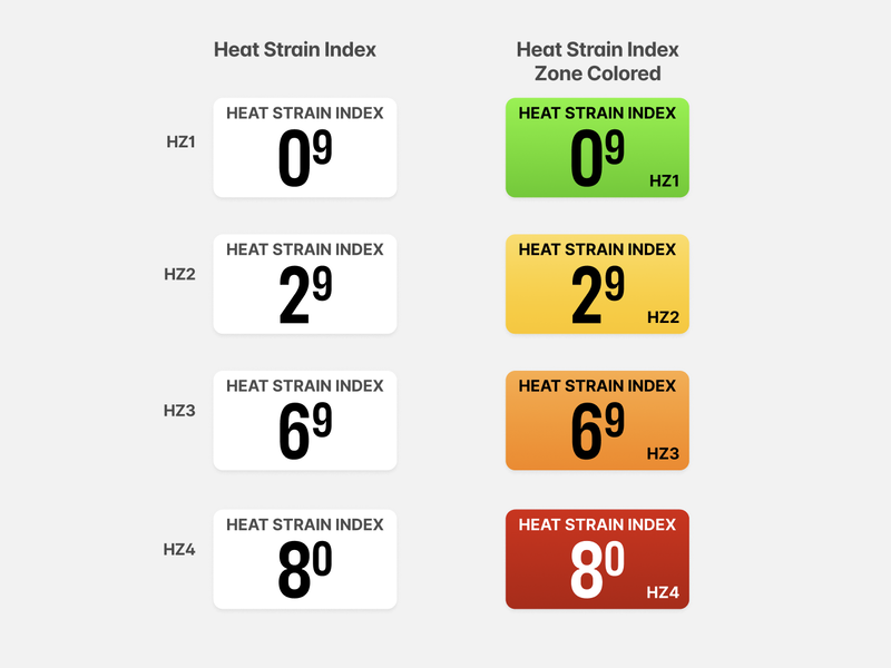

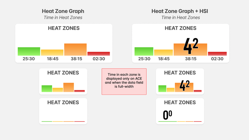

  • Heat Strain Index (HSI) will appear as a value according to CORE’s scale, either on a white background or colored coordinated to CORE’s heat zones.
  • Heat Zone Graph will show a colored bar chart representing the time spent in each heat zone.
    • If used as a full width data field with ACE (first field on a page or others at certain zoom levels) the elapsed time spent in each zone will be shown under each zone’s bar.
    • Due to the screen size of ROAM 3 and BOLT 3, the time in zone is under the bar chart is not included.
  • Heat Zone Graph + HSI will show the same bar chart, with the current heat strain index value superimposed over the current heat zone you are in.
  • Time in Heat Zone X will provide the time spent in the selected zone as a text value over a white background.
  • The other data fields will be the text value over a white background.

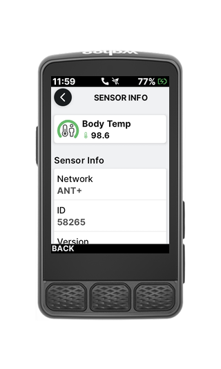

  • CORE is BTLE and ANT+, but connects to ELEMNT as an ANT+ sensor.

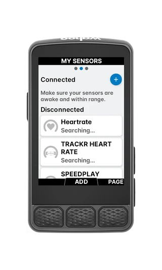

  • Confirm the CORE Body Temperature sensor is powered on/awake, paired with the ELEMNT, and worn correctly. Check the Sensors menu on the ELEMNT to verify the CORE shows as connected. If the sensor is not connected, forget and re-pair.
