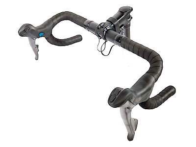

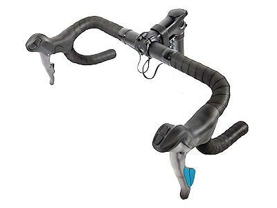

KICKR BIKE SHIFT has a total of 10 buttons on the shifters in the cockpit, in addition to the brakes.
Two shifter buttons on the outside of each brake lever
Used for Shimano and SRAM shifting configurations.
One multi-use button on the inside of each shifter body
Used for shifting with a Campagnolo shifter configuration OR
Used for steering in Zwift (not compatible with the Campagnolo shifting profile.)
2 multi-use buttons on top of each shifter body
Left side
  • App contextual buttons
    • in Zwift
      • Front: Select
      • Rear: Ride On Bomb
Right side
    • in Zwift
      • Front: Power Up
      • Rear: U-Turn

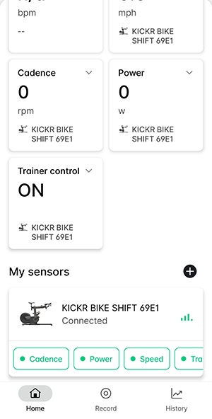

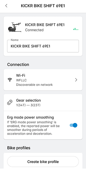

3. Once paired, navigate to Home > My sensors > BIKE SHIFT
4. Scroll down to the Bike profiles section and select Create bike profile.

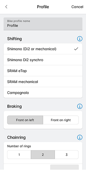

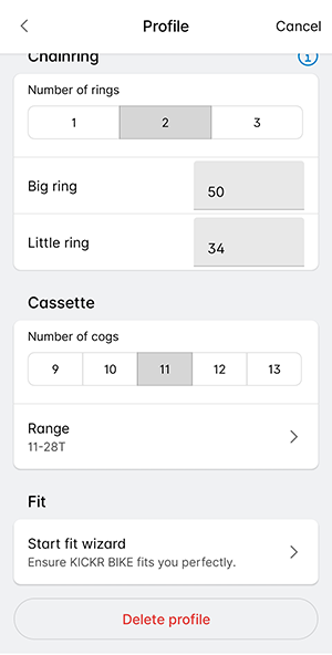

5. Select your preferred Shifting and Braking configuration.

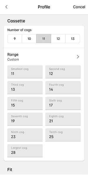

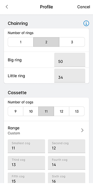

6. Select your preferred number of chainrings and chainring tooth count.
7. Select your preferred number of cassette cogs.
shifter-shiftingbraking-300.png shifter-chainring-300.png shifter-cassettecogs-300.png

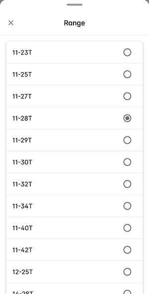

8. Select Range and select your preferred preset cog range or Custom to select the tooth counts of your preferred custom cog set.
9. Select the back button in the upper left hand corner. The selected settings are automatically saved.
shifter-cassetterange-300.png shifter-cassettecustom-300.png shifter-cassettecogs-300.png

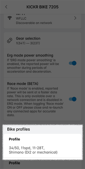

Edit a shifter profile
1. Open Home > My sensors > BIKE SHIFT.
2. Scroll down to Bike profiles and select the profile you wish to edit.
shifter-editbikeprofiles-300.png blanktrans300x600.png blanktrans300x600.png
3. Select your preferred Shifting and Braking configuration.
4. Select your preferred number of chainrings and chainring tooth count.
5. Select your preferred number of cassette cogs.
6. Select Range and select your preferred preset cog range or Custom to select the tooth counts of your preferred custom cog set.
7. Select the back button in the upper left hand corner. The selected settings are automatically saved.
