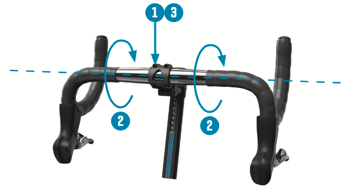

    5. Use a 4mm Allen wrench to loosen (but do not remove) the stem bolts on the face plate. Rotate the handlebars to your desired position. Tighten the stem faceplate bolts evenly in an X pattern. If a torque wrench is available, torque to 5.5Nm.
    Drop handlebars on the KICKR BIKE SHIFT stem, with callouts for the faceplate bolts and rotating the bars to the desired angle

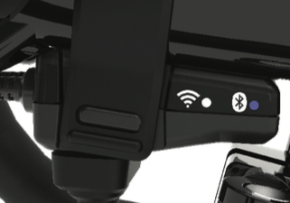

  • KICKR BIKE SHIFT status LEDs: white Wi-Fi LED and blue Bluetooth LED side by side
    KICKR BIKE SHIFT has two LEDs to indicate its power and connection status.
    • White Wi-Fi LED
      • Slow blink - searching for networks
      • Fast blink - connecting to a network
      • Solid - connected to network
    • Blue Bluetooth® Low Energy (LE) LED
      • Slow blink - standby mode
      • Solid - application connected
      • Solid + Fast blink - control commands
    • Blue and White LED OFF - Sleep mode (after 15min) or power disconnected
