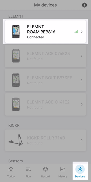

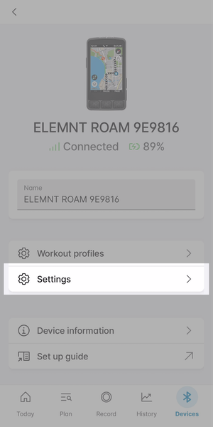

  1. Navigate to Wahoo app > Devices > computer name > Settings > Notifications

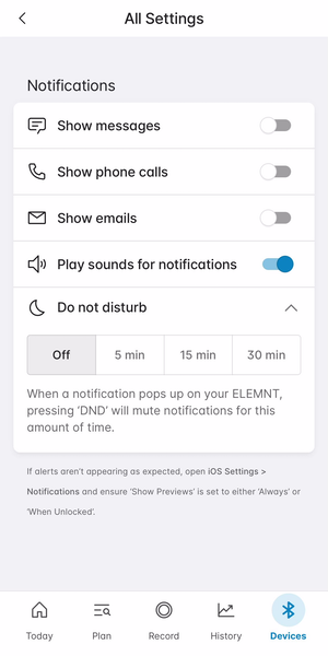

  2. Toggle on Show messages, Show phone calls, and/or Show emails as desired for visual alerts.
  3. Toggle on Play sounds for notifications if you also wish the computer to beep when a notification is received.
Each notification toggle type (messages, phone calls, or emails) is persistent across all workout profiles for the computer for which they are enabled.

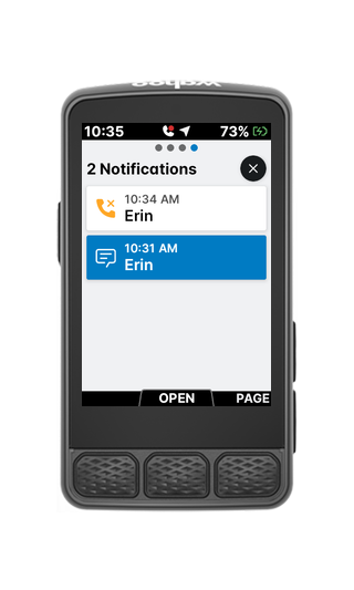

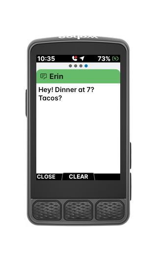

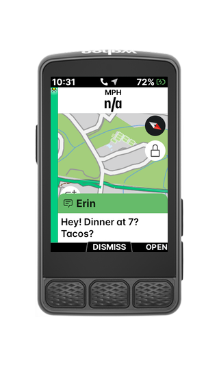

When a notification is received, a small banner will appear at the bottom of whatever screen you are on. If sounds are enabled, the computer will also beep.
Notifications will automatically time out after several seconds, but can be dismissed immediately using the DISMISS button.  If not dismissed, notifications will be stored in the Notifications page of the Settings pages until the computer is shut down or restarted.  Manually dismissed notifications will not appear on the Notifications page.

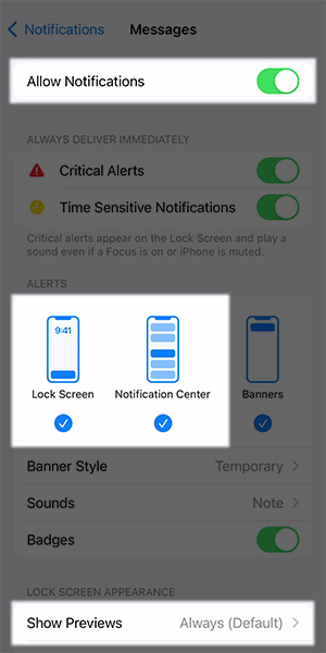

  4. Confirm notifications are appearing in your iOS notifications center. This is required in order for the messages to be received by the ELEMNT, BOLT, or ROAM. If you do not see the message in the iOS notifications center, please check your iOS settings. This is also a sign notifications are being received by another device.

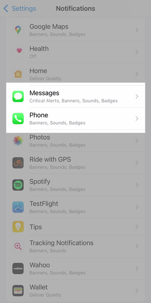

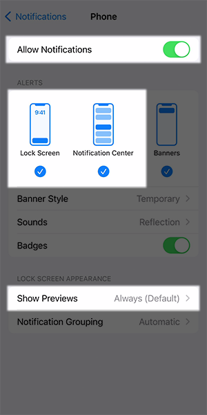

  5. Confirm that the following iOS settings are toggled on/selected
    1. iOS Settings > Notifications > Messages
    2. iOS Settings > Notifications > Phone
      ios-settings-notifications-300.png ios-setting-notifications-messages-hlight-300.png ios-settings-notifications-phone-hlight-300.png

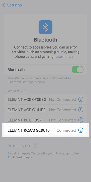

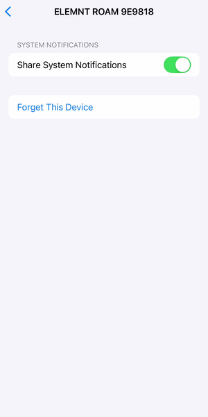

  7. Confirm that your computer has Share System Notifications enabled.
    1. iOS Settings > Bluetooth > computername > Share System Notifications
      ios-settings-bluetooth-roami-300.png ios-settings-bluetooth-sharesystemnotifications-300.png blank300x10.png

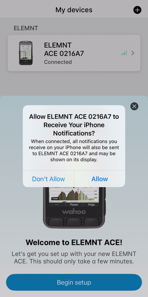

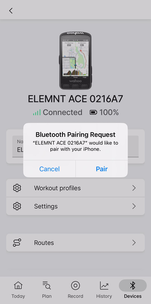

  8. If unresolved, Forget and re-pair the ELEMNT computer to the Wahoo app, confirming both the Bluetooth pairing and notifications permissions when prompted.
    wa-ace-iospairrequest.png wa-aceonboard-notifications-300.png blank300x10.png

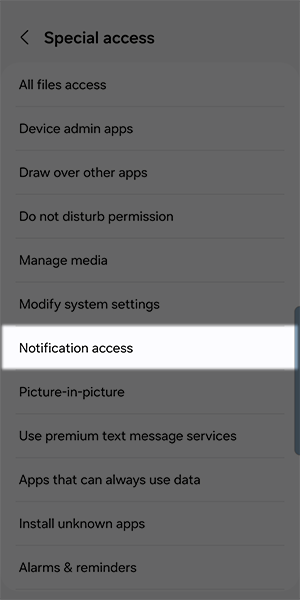

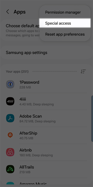

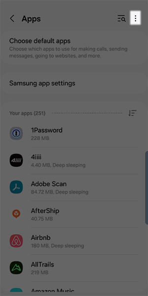

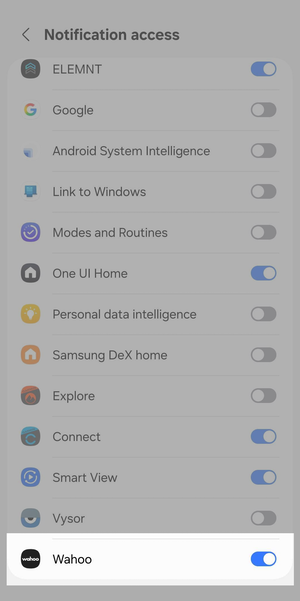

  6. Confirm that the Wahoo app has notification access in Android Settings > Apps > Special Access > Notification access.
    android-settings-apps-threedotsselected-300.png android-settings-apps-specialaccessselected-300.png android-settings-apps-specialaccess-notificationsselected-300.png
