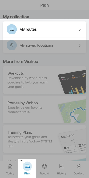

  3. Have the route loaded in the Wahoo app (present in the Plan tab > My Routes list).

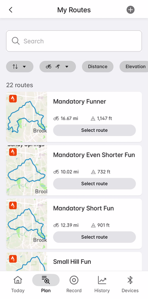

  1. Sync a route from a third party app/service, import a route from a file, or create a route from a completed activity in your activity history.

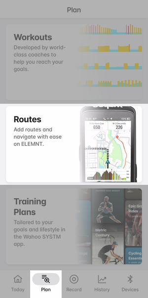

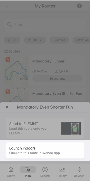

  2. Select a route from the Plan tab > My Routes list.
    1. Select the route image or panel to see route details, and reverse the route if desired.
  3. Select Select route.
  4. Select Launch indoors.

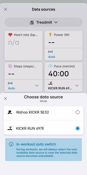

  5. Confirm that your KICKR trainer, BIKE, or RUN is paired/actively connected.
  6. Ensure that your CLIMB or KICKR BIKE is unlocked, if you wish the app to control your grade live.
  7. Confirm that the correct workout profile is selected (Indoor Cycling for use with KICKR / BIKE, Treadmill for RUN).

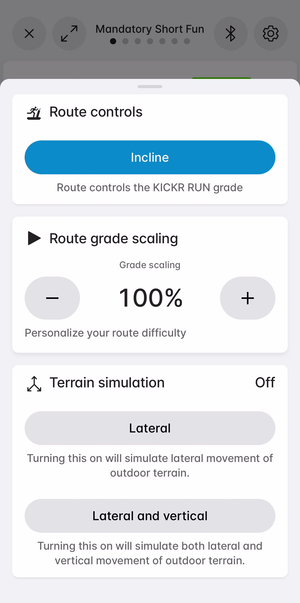

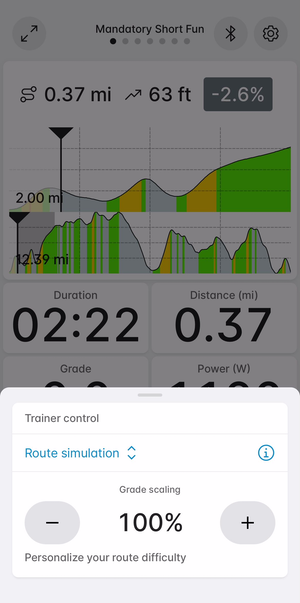

  8. Confirm your preferred mode is selected / select Incline control.
    • Select Control in the bottom right corner then confirm the appropriate mode is selected.
      • With KICKR trainers or BIKEs -- While passive and target power modes can be used, in order to enable grade control, you must select Sim or Route Simulation mode.
      • With KICKR RUN, to enable grade control by the app, Incline must be selected.

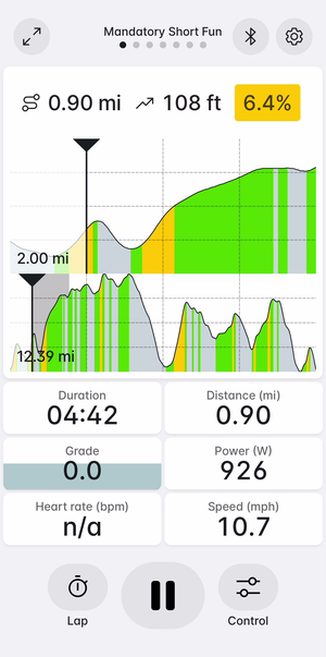

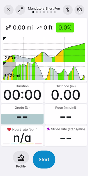

In addition to the pages normally available for those Indoor Cycling and Treadmill workout profiles, route simulation mode provides two new pages for a new experience:
an Elevation Profile page
    • A 2 mile / 3 kilometer elevation profile at the top of the page shows the immediate upcoming topography.
    • A second route elevation profile shows the route's complete topography.
      • The profile can be tapped to toggle between two other options: 20 mi / 30 km or the remainder of the route.

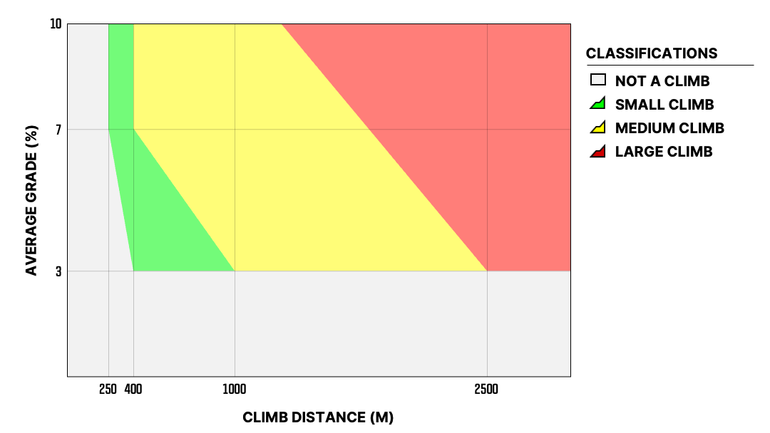

    • The profile is colored with the nominal grade of the route, (not the realized grades of the CLIMB, BIKE, or RUN).

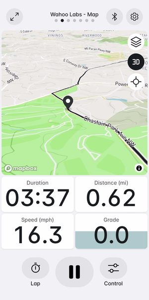

a Map page [open Beta]
      • A route line will appear on a map panel, with key values (duration, distance, speed/pace, and grade)
      • There are button options to toggle map layers between standard and satellite view, and between 2 and 3 D.

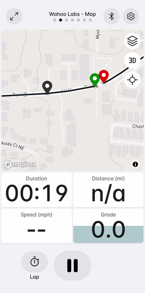

      • A green and red pin icon indicate the start and end of the route, while a black pin icon identifies your current location on the route.
      • The map can be manipulated like most mobile map apps:
        • pinched to zoom
        • panned with 2 fingers oriented vertically
        • rotated with 2 fingers
        • 2D/3D angle adjusted with 2 fingers oriented horizontally
      • A target button will return your view to your current location on the map and default zoom level if you navigate away from your location.
wa-routesim-cycling-map-300.png wa-routesim-run-map-300.png wa-routesim-pinsbuttons-300.png

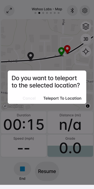

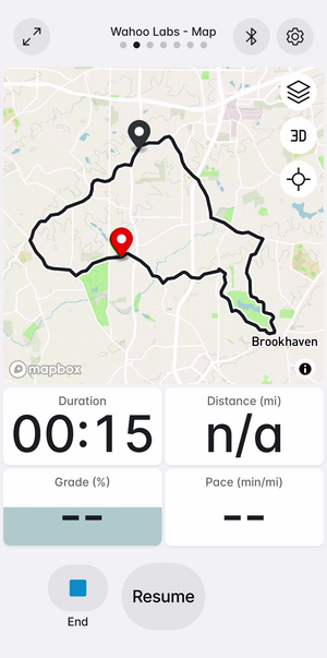

Teleporting around the route
You can skip to a different section of a route by
  1. Navigating to the Map page,
  2. Pausing the recording,
  3. Moving the map to a different location on the route, and
  4. Tapping once on the location on the route to select your target.
  5. Select Resume.
    • You will be asked if you would like to teleport to the new location.
      • If you select Cancel, you will be returned to the route in your current location.
      • If you select Teleport, you will be relocated to the new location on the route and the recording will continue from that point.
        • This action cannot be undone, but you could immediately pause and attempt to re-select your previous location on the route.
wa-routesim-selectteleporttarget-300.png wa-routesim-teleportconfirm.png blank300x200.png
Scaling intensity / grade targets
You can choose your level of intensity (trainer / BIKE resistance) / grade expression of your CLIMB / BIKE / RUN by adjusting the grade scaling value accessed from the Control button in the bottom right corner of a page to better align with your training goals/ride experience.
If the grade of an incline is currently 10%, scaling the grade to 75% would reduce the incline to 7.5%.
wa-routesim-cycling-control-300.png wa-routesim-run-controls-300.png blank300x200.png
