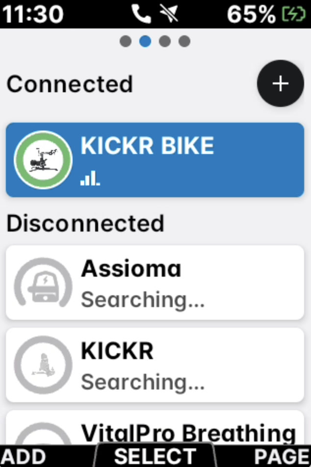

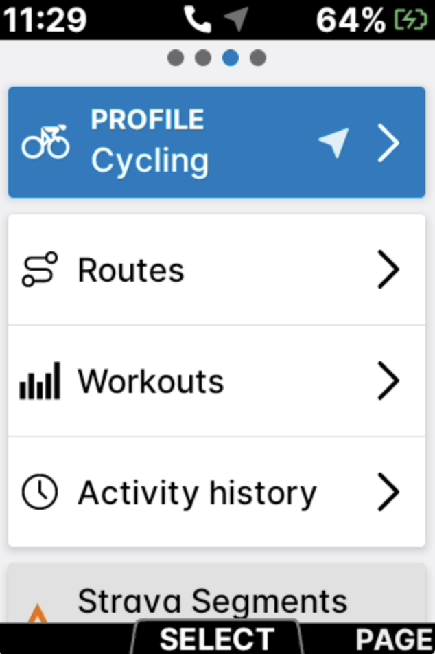

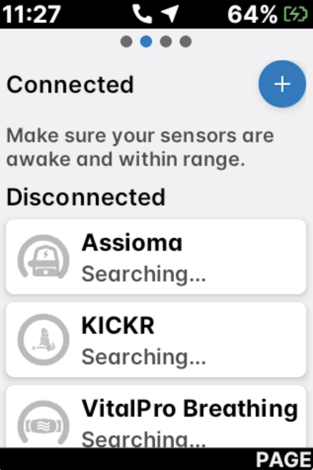

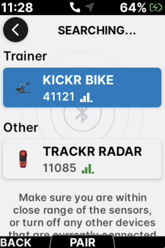

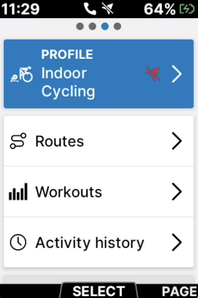

  1. Pair your smart trainer to the ELEMNT device like any other sensor.

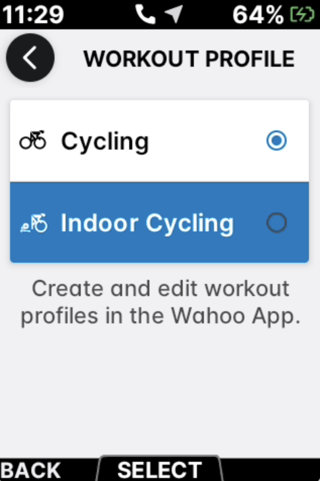

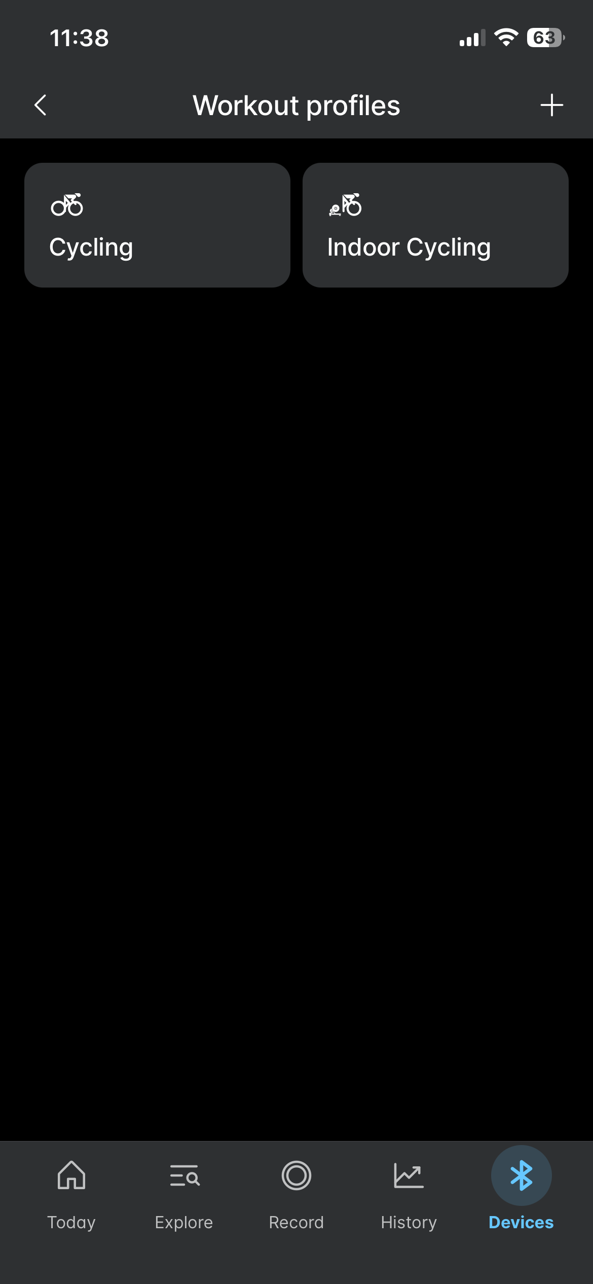

  2. Navigate to the Menu page (left side button) and set the Workout profile to Indoor Cycling.
  3. Begin pedalling and the computer will automatically connect to the Indoor smart trainer.
  4. If the KICKR Control Page does not appear automatically, confirm the Workout profile is set to Indoor Cycling, press the left side Menu button to return to the workout page stack, and select Page (right front button) to find the KICKR Control page.

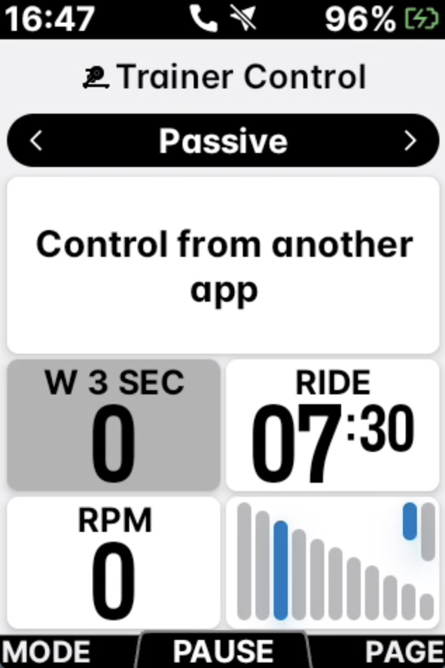

Passive Mode
  • Allows your ELEMNT ACE, BOLT 3 or ROAM 3 to be used as a mounted display when riding a smart trainer paired to a 3rd party app.
  • The ELEMNT displays and independently records metrics from connected sensors during a workout.
  • This is the default mode when entering smart trainer control mode.
*Important note on Passive mode: Since this method pairs the ELEMNT to the trainer via Bluetooth, connecting a KICKR prior to v4 (2018) or a SNAP to another app will require an ANT+ connection to that app. To connect to another app via Bluetooth, ensure the Wahoo app is fully closed and unpaired, connect your trainer to the other app then follow the steps provided above to connect the ELEMNT ACE, BOLT 3 or ROAM 3 to the trainer via ANT+.

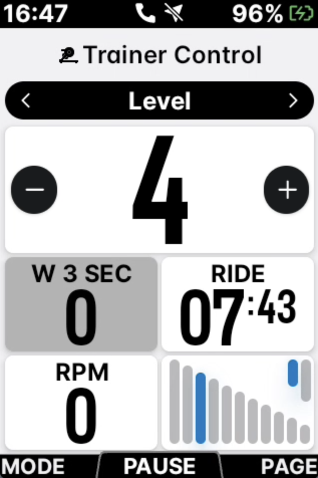

Level Mode
  • Select a difficulty level from 1 to 10 using the right side buttons.
  • Level mode applies a standard resistance curve to the trainer. The curve replicates outside riding- the faster you go, the greater the resistance.
  • In Level mode, you will need to shift gears to meet the power targets, unlike ERG mode where the trainer meets the power targets for you.

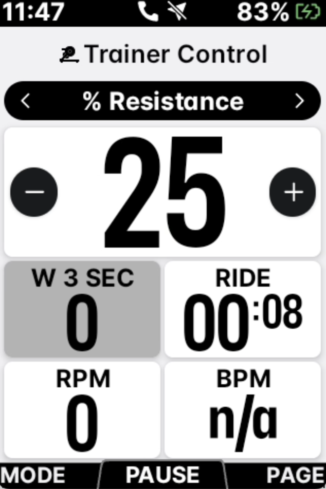

Resistance Mode
  • Resistance mode allows for fine-tuned direct control of the trainer's brake resistance from 0-100%. Unlike Target Power (ERG) mode, brake resistance remains constant regardless of speed or cadence until changed manually. Think of it like a manually controlled spin bike.
*Note on resistance mode: Due to brake design, Resistance mode is not available for BIKE and BIKE shift models.

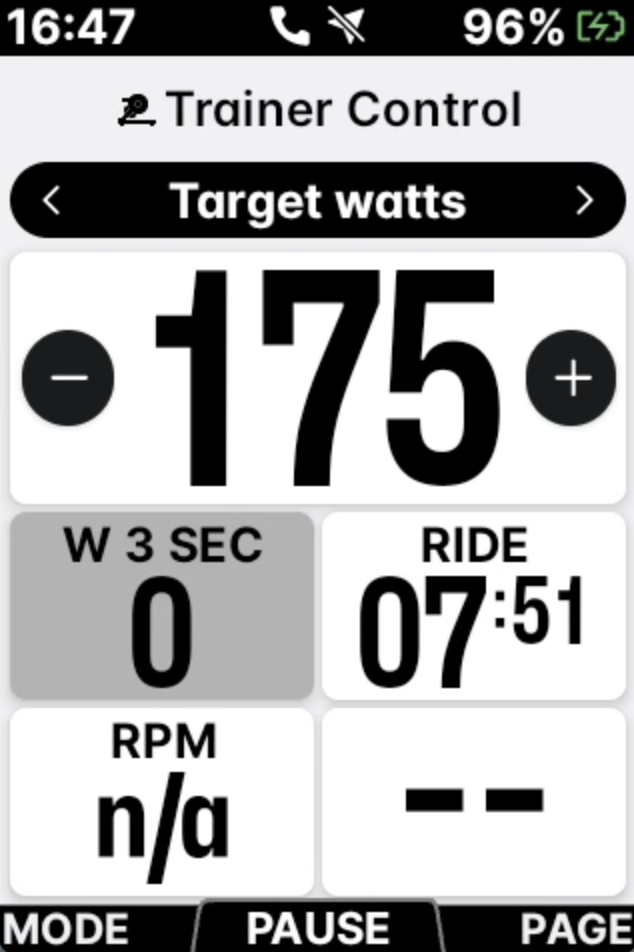

Target Power Mode
  • Target Power Mode, also known as ERG mode, allows you to set your desired power output target and the trainer will adjust resistance to keep your effort at that power output, regardless of cadence or speed.
  • If your cadence slows, the trainer increases resistance to maintain the target power output.

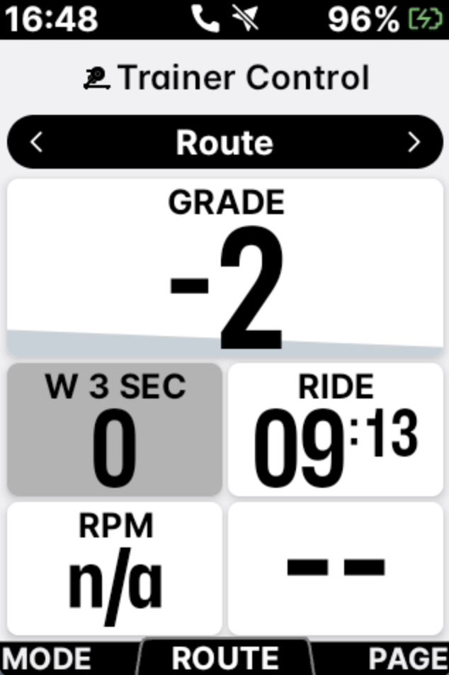

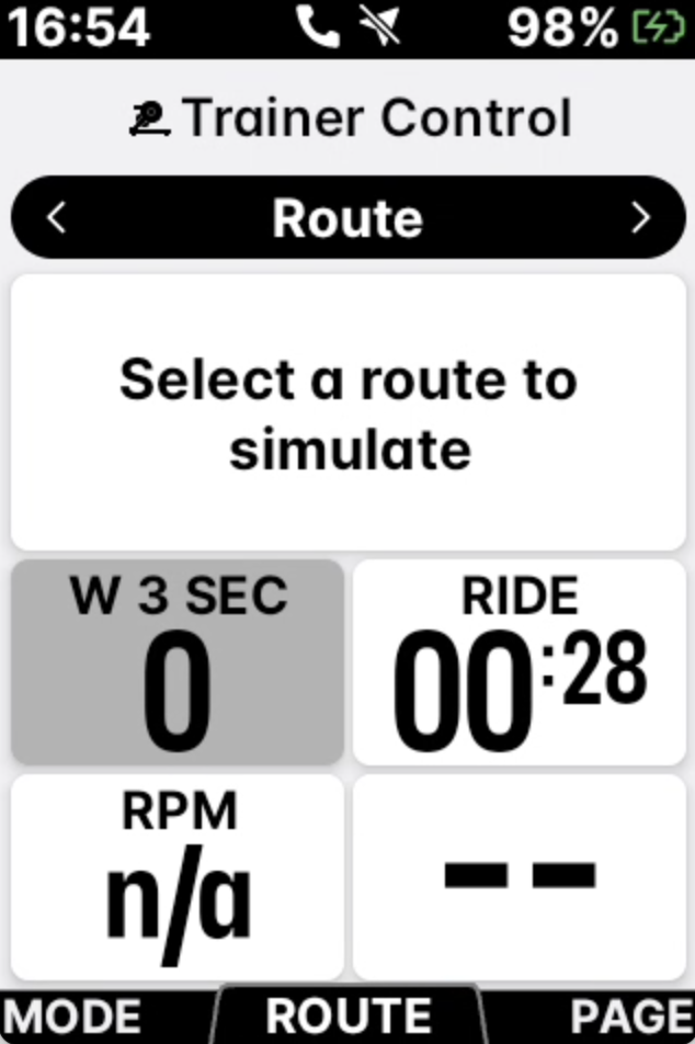

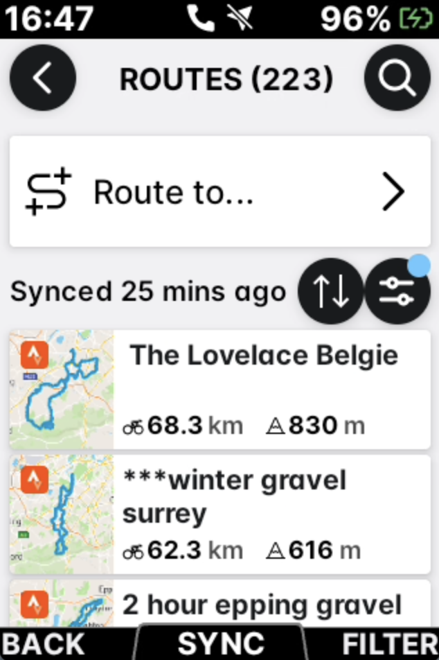

Route Simulation
  • Route mode allows you to recreate rides or simulate a route on your KICKR with support of terrain features like hills and valleys.
  • To use Route mode, select Route at the bottom of the page > Select your desired route > Press center button to confirm route choice > The trainer resistance will now be determined by the gradient changes over the course of the route.

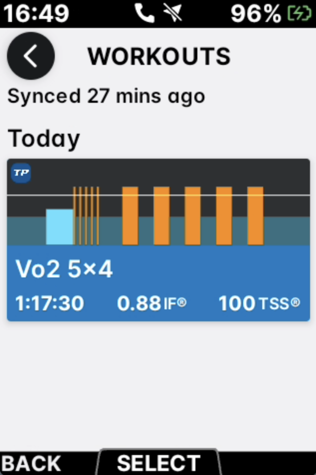

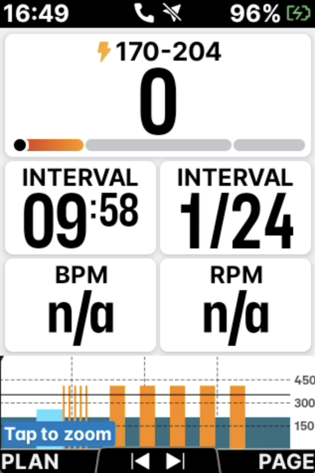

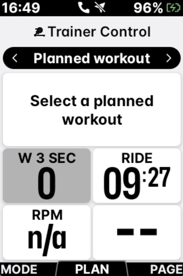

Planned Workout
  • Planned workout mode allows you to follow an uploaded planned workout, according to the resistance design of the workout. In most cases this will be ERG mode, but if there are no power targets, the trainer will not provide resistance.

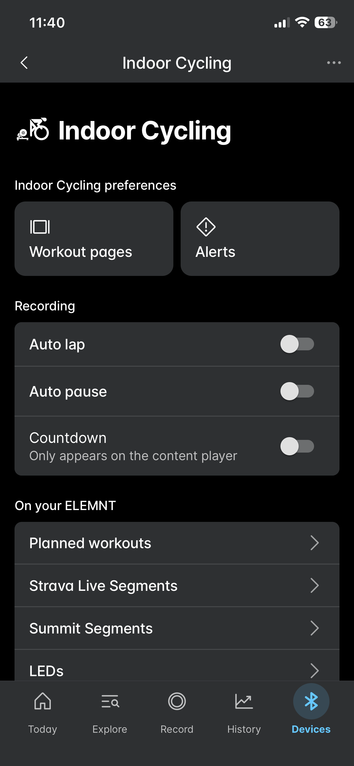

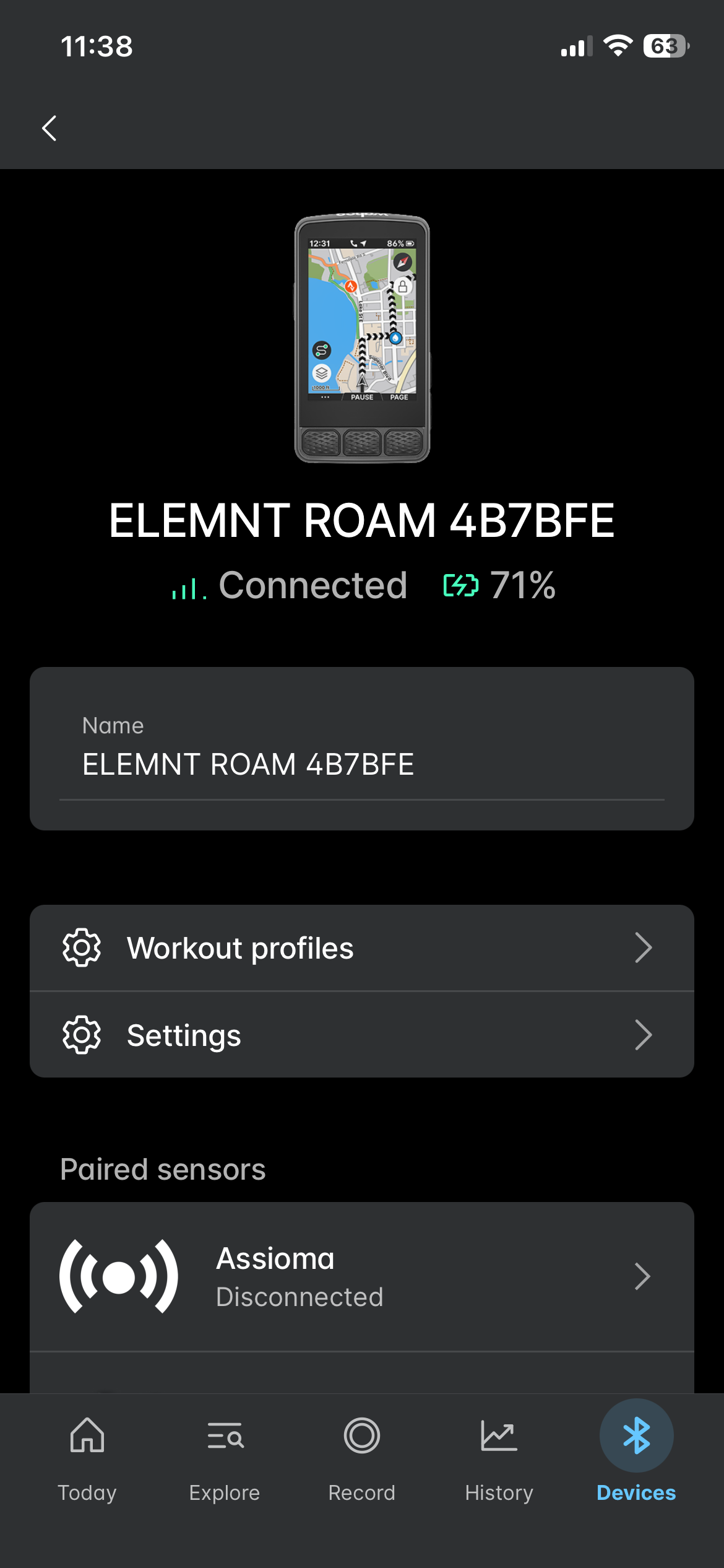

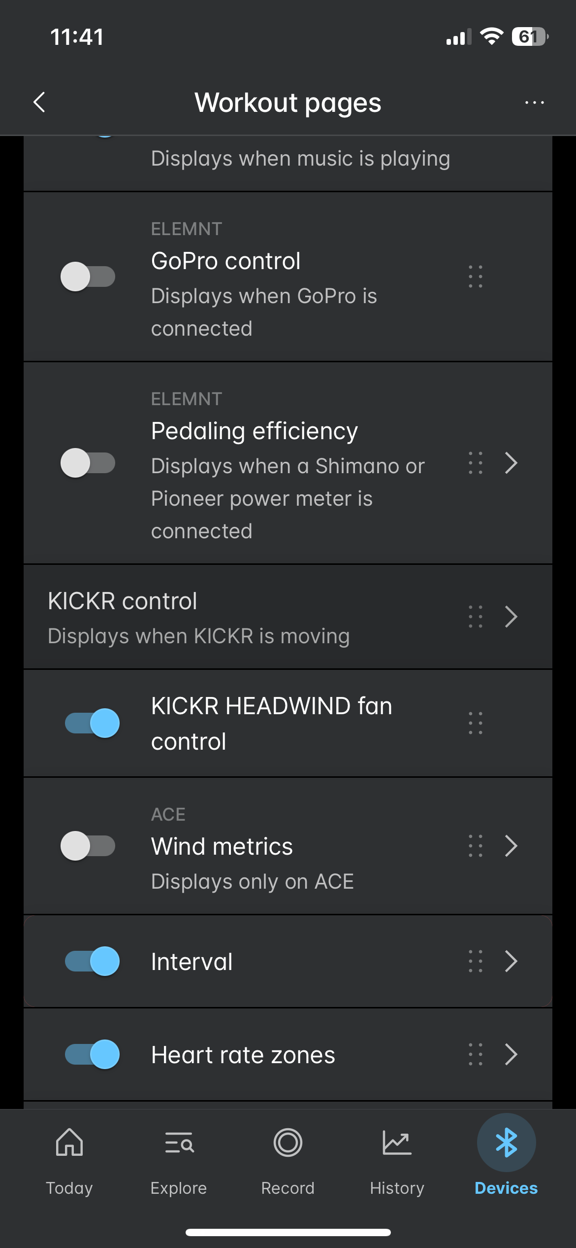

Trainer control page does not appear on ELEMNT
  • Ensure you are on 'Indoor Cycling' workout profile on ELEMNT device
  • Ensure Trainer Control page is present in 'Indoor Cycling' workout page in Wahoo app > Devices > Select ELEMNT device > Workout pages > KICKR Control
