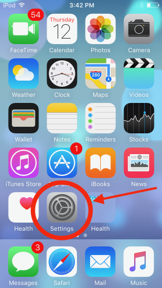

  2. Open the iOS settings app from the Home Screen as shown below.

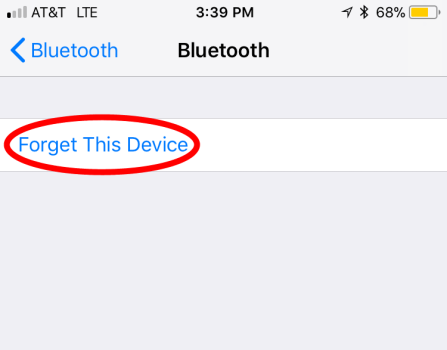

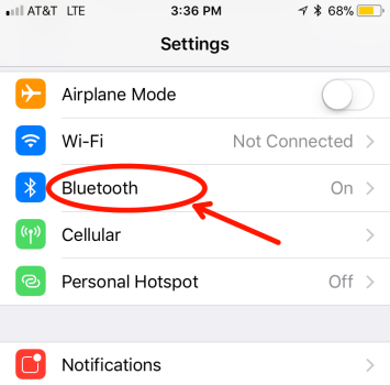

  3. Forget the sensor in the Bluetooth section.

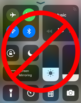

  4. Toggle Bluetooth off within the Bluetooth section of the Settings app. Doing this outside the Settings app (like from the Control Center) may not fully disable Bluetooth.

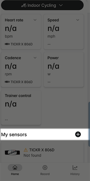

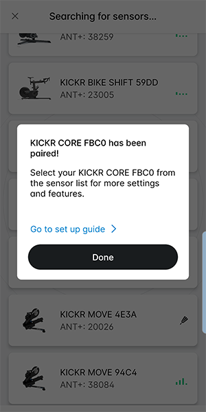

  7. Make sure the sensor is on, awake, and illuminated (if applicable), then navigate to the Home > My Sensors page in the Wahoo app and choose (+) or Pair Sensor. Select your sensor from the list to save/pair it.
