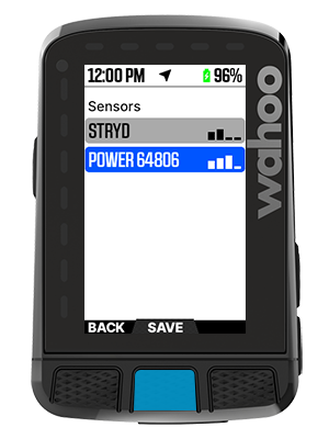

  1. Ensure the sensor is awake and near the computer.
  2. Navigate to the Menu page (tap left side button).
  3. Scroll down to Add Sensor (using right side buttons), and select Add (middle button).
  4. Select Save (middle button) once the correct sensor displays.
  5. If a different sensor is displayed that you do not wish to pair, select More (right button).

Most dual-sided power meters come come from the factory with the right pedal (secondary) paired to the left pedal (primary). When pairing them to your computer, only the left pedal will appear, and may not indicate 'left'. Right side power data is transmitted from the right side pedal to the left side pedal, which sends both left and right side data to the computer. If you believe there is a pairing issue, forget, re-pair, and calibrate the pedals, and if unresolved, review the setup and pairing documentation from your pedal manufacturer.

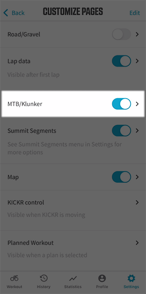

  1. In the ELEMNT app, select the Settings tab. Then select Pages.
  2. Select the page and data field position into which you want to insert the power data field.

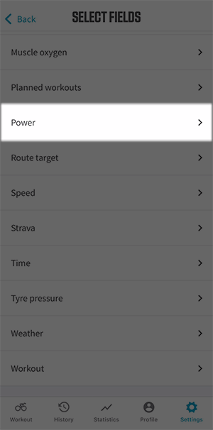

  3. Scroll down to Power and select the data field you wish to use.
