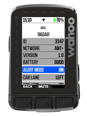

Alert mode
  • ON - Radar and visual and audio alerts are ON.
  • MUTE - Radar and visual alerts (radar lane) are ON, but audio alerts are muted / OFF.
  • OFF - Radar function is turned off, removing visual alerts (radar lane) and audio alerts OFF.

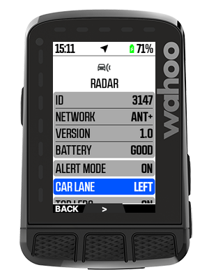

Car Lane
  • LEFT - Radar lane is on the left side of the screen
  • RIGHT - Radar lane is on the right side of the screen
  • LEFT LEDS - for devices with left side LEDs (ELEMNT, ROAM 1/2), car location and speed is represented by the left side LEDs

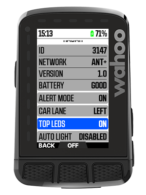

Top LEDs
  • ON - Top LEDs are used as a part of radar visual alerts.
  • OFF - Top LEDs are not used as a part of radar visual alerts.

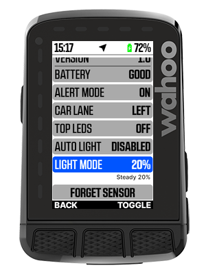

Light Mode
(requires second generation computer, ROAM v2 or BOLT v2)
Dependent upon the radar's available preset light settings.  (ex. Off, High steady, Low steady, High flash, low flash)

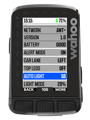

Auto light
If the auto light feature is enabled (1S, 5S, or 10S), and the radar has a tail light, the light will default to off.  When the radar senses a vehicle is approaching, the light will be turned on to the last light mode selected on the taillight or the computer* and remain illuminated for the period of time selected (1, 5, or 10 seconds) after the last vehicle in a sequence passes and then turn off.  If the auto light feature is disabled (set to OFF), the currently selected light mode will perform as defined by the light mode.
  • OFF - Light presents the last light mode selected on the light or computer,
  • 1S - Light is off and turned on to the last light mode selected as a vehicle is approaching + 1 second.
  • 5S - Light is off and turned on to the last light mode selected as a vehicle is approaching + 5 seconds
  • 10S - Light is off and turned on to the last light mode selected as a vehicle is approaching + 10 seconds
*If used with a Wahoo TRACKR RADAR with the Quick alert light mode enabled, the light will turn on to a high flash mode while the vehicle is approaching, and return to the last light mode selected for the remaining 1, 5, or 10 seconds before turning off.
