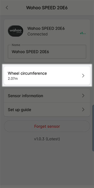

1. With your sensor paired and actively connected to the app, navigate to the paired RPM SPEED sensor page:
In the Wahoo App -- Home > Devices > Wahoo Speed XXXX or
In the ELEMNT app -- Settings > Sensors > Wahoo Speed XXXX]
2. Select Wheel Circumference.

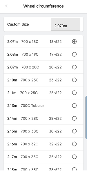

3. Enter your bike's wheel circumference under Custom Size or select a from the list. You can explore more tire sizes in our Tire Size Chart.
4. The wheel circumference will be set for all Workout Profiles associated with the sensor.
