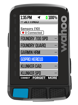

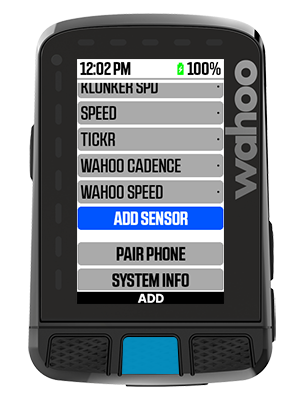

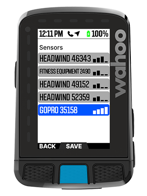

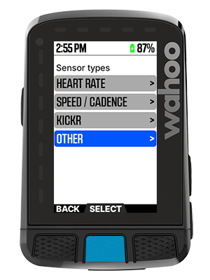

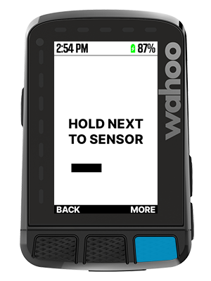

    2. Then, on the ELEMNT
        1. Tap the power button to access the Menu page.
        2. Use the right side buttons to scroll down to Sensors > Add New.
        3. Select the GoPro from the list of available sensors.
r2-lightsaddsensor-r300.png r2-lightaddsensormore-r300.png r2-lightaddsensorother-r300.png

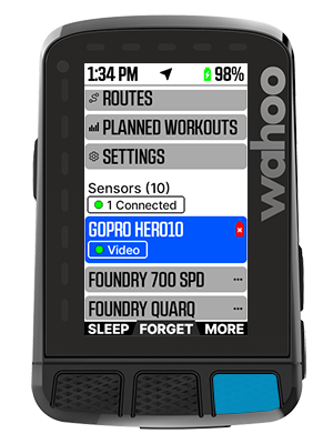

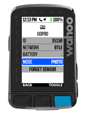

Sensor Menu / Sensor detail pages

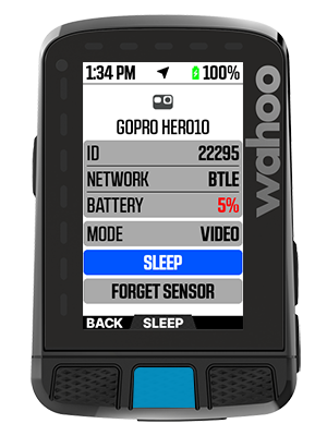

Once paired and actively connected, the GoPro will appear in the Sensors list on the Menu page. The current camera mode will be shown under the sensor.  Camera battery percentage and camera mode will be shown in GoPro's sensor details page. Camera mode can be toggled using the right front button.
r2-gopromenumoreconnected-r300.png r2-goprosensodetails-r300.png blanktrans300x400.png

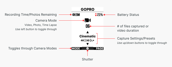

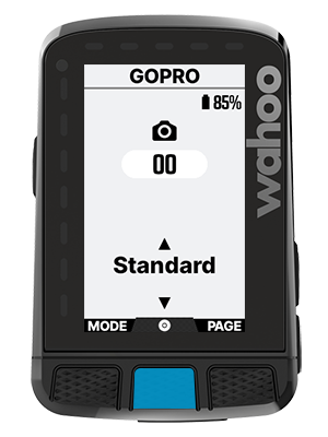

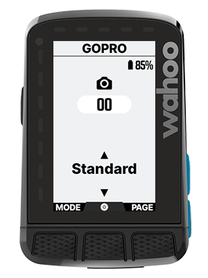

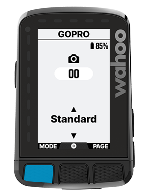

GoPro Control page
The GoPro Control page, which will be visible if a camera is connecting, actively connected, or has been in an actively connected after a ride has been started*, is added to the end of the page stack, and will display:
  • Recording time / photos remaining (based on SD card capacity)
  • Camera battery status
  • Currently selected camera mode: Video, Photo, Time lapse, and custom modes (based on camera mode presets)
    • Toggled by using the left front button.

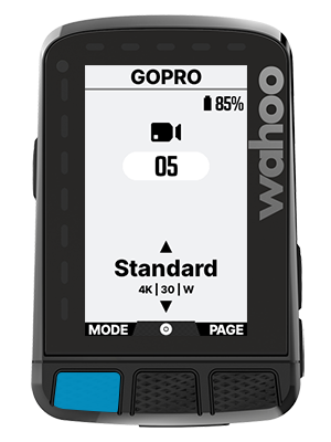

    • Video
      • duration of video currently recording OR
      • number of video files captured
    • Photo
      • number of image files captured

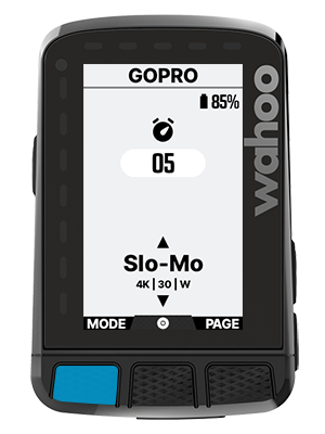

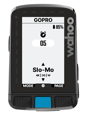

    • Time Lapse
      • duration of time laps currently recording OR
      • number of time lapse files captured
r2-goprovideomode-r300.png r2-goprophotomode-r300.png r2-goprotimelapsemode-r300.png

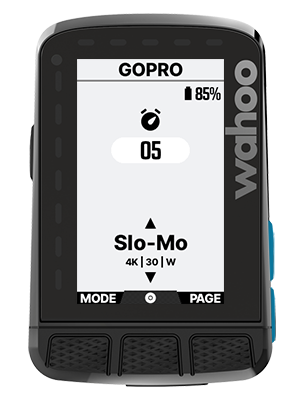

  • Currently selected camera settings
    • Toggled using the right side buttons
r2-goprovideosettings-r300.png r2-goprocamerasettings-r300.png r2-goprotimelapsesettings-r300.png
  • A shutter button
    • Actuated using the middle front button
    • Will blink red when recording
    • Video / Time lapse - toggle recording on/off
    • Photo - capture image

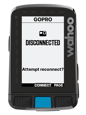

  • * While asleep, either from Auto-Off, the SLEEP button on the ELEMNT, or manually turning the GoPro off, the GoPro will shows as disconnected.
Sleep/standby/off and Reconnect
When a GoPro is actively connected, you can put the camera in sleep/standby mode using the left front button when the GoPro line item under Sensors on the Menu page or in the GoPro's sensor details page.
If Auto-Off is set to greater than 90 seconds, the computer will not go to sleep/standby mode automatically.
r2-gopromenusleep-r300.png r2-goprodetailssleep-r300.png blanktrans300x400.png

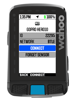

For Hero 9, 10, and 11 -- While asleep, either from Auto-Off, the SLEEP button on the ELEMNT, or manually turning the GoPro off, you can waken/re-connect using the CONNECT button (left front button when the GoPro line item is selected under Sensors on the Menu page, or center button when on the GoPro sensor details page or GoPro Control page. If not previously connected during the ride, connecting the camera on the his button will also make the GoPro Control page visible again.
r2-gopromenuconnect-r300.png r2-goprodetailsconnect-r300.png r2-goprodisconnected-r300.png
For Hero 12, there is no CONNECT option under Sensors on the Menu page.  It is found only on the sensor details page or GoPro Control page.
Due to a GoPro firmware limitation, if a Hero 12 goes to sleep/time out, the camera must be set into Quik App pairing mode again before attempting to use the CONNECT buttons on the ELEMNT.
