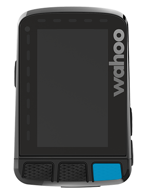

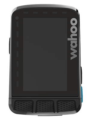

  • Quick press left hood Bonus button to simulate pressing the left front computer button.
  • Quick press right hood Bonus button to simulate pressing the right front computer button.
  • Quick press both hood Bonus buttons simultaneously to simulate pressing the middle front computer button

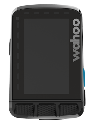

  • Long press left hood Bonus button to simulate the up (left)  right side computer button.
  • Long press right hood Bonus button to simulate the  down (right) right side computer button.
    r2-blankleftbutton-r300.png r2-blankrightbutton-r300.png r2-blankmiddlebutton-r300.png
    r2-blankrightupperbutton-r300.png r2-blankrightlowerbutton-r300.png blanktrans300x400.png
AXS Wireless Blip control
AXS Wireless Blips can be mapped to simulate front ELEMNT button controls.
  • Quick press left Blip to simulate pressing the left front computer button.
  • Quick press right Blip to simulate pressing the right front computer button.
  • Quick press both Blips simultaneously to simulate pressing the middle front computer button

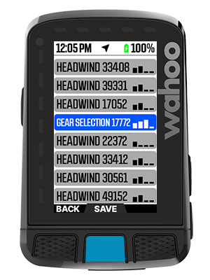

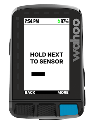

Pairing your SRAM AXS drivetrain with your Wahoo ELEMNT Bike Computer
On the ELEMNT computer
  1. Ensure the rear derailleur is awake and near the computer.
  2. Navigate to the Menu page (tap left side button).
  3. Scroll down to Add Sensor (using right side buttons), and select Add (middle button).

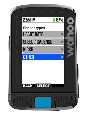

  4. While the computer is searching for sensors, select More (right button), then Other, to find the AXS drivetrain you wish to pair. (It will appear as Gear Selection).
  5. Select Save (middle button) once the correct sensor displays.
pair-computer-1-addsensor-r300.png pair-computer-2-addsensormore-r300.png pair-computer-3-addsensorother-r300.png
pair-computer-4-addgearselection-r300.png blanktrans300x400.png blanktrans300x400.png

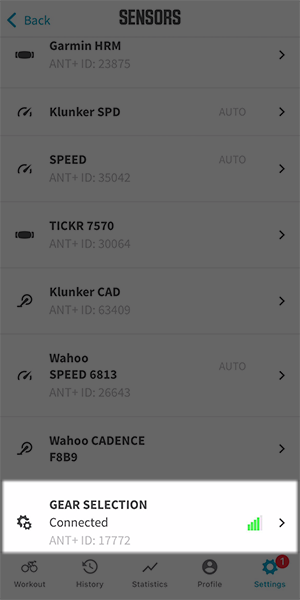

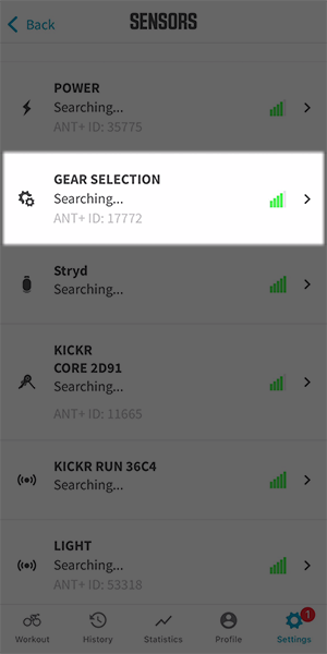

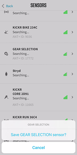

In the ELEMNT app
(does not apply to ELEMNT ACE, BOLT 3, or ROAM 3)
  1. Ensure your ELEMNT is paired to the ELEMNT app.
  2. Ensure the rear derailleur is awake and near the computer.
  3. Navigate to the Settings page and then scroll down to and select Set up sensors.
  4. Hold the computer near the rear derailleur.
  5. Select AXS drivetrain you wish to pair (it will appear as Gear Selection) and then confirm the pairing.
pair-app-1-gearselectionfound-300.png pair-app-2-gearselectionsave-300.png pair-app-3-gearselectionconnected-300.png
