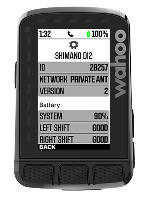

Current shifter + derailleur battery level in sensor details
  • Sensor details page accessed from the Menu page displays remaining shifting battery. Di2 main battery is shown as a percentage, while all other sensors show battery state as GOOD, LOW, or CRITICAL (including batteries for individual eTap components)

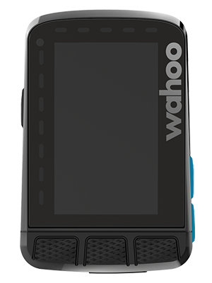

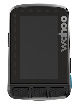

Shimano Di2 -  ELEMNT computer control
  • Di2 configurations with additional buttons located on top of the hoods integrate with all ELEMNT computers to allow most remote button controls from the hoods.
  • ELEMNT computers are designed to work with the default settings for the shifter hood buttons.  Ensure that the shifter hood buttons do not already have a function designated to them in the E-Tube Project app, leaving them open. The left hood button should be configured for ch. 1 and the right hood button should be configured to ch. 2.
    • Quick press left hood button to simulate pressing the left front computer button.
    • Quick press right hood button to simulate pressing the right front computer button.
    • Long press left hood button to simulate the up (left)  right side computer button.
    • Long press right hood button to simulate the  down (right) right side computer button.

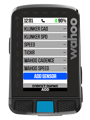

Pairing electronic drivetrains
On the ELEMNT computer
  1. Ensure the shifter/derailleur is awake and near the computer.
  2. Navigate to the Menu page (tap left side button).
  3. Scroll down to Add Sensor (using right side buttons), and select Add (middle button).
  4. While the computer is searching for sensors, select More (right button), then Other, to find the  Shimano Di2 or Gear Selection* sensor.
  5. Select Save (middle button) once the correct sensor displays. Shimano Di2 systems will display as Shimano Di2. SRAM eTap and others will display as Gear Selection.
r2-addsensor-r300.png r2-lightaddsensormore-r300.png r2-lightaddsensorother-r300.png

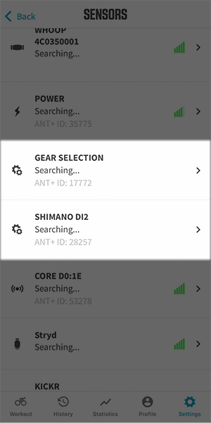

In the ELEMNT app
  1. Ensure your ELEMNT is paired to the ELEMNT app.
  2. Ensure the shifter/derailleur is awake and near the computer.

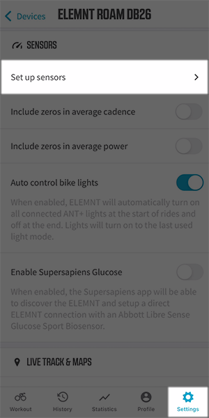

  3. Navigate to the Settings page and then scroll down to and select Set up sensors.
  4. Hold the computer near the wireless component (inline adapter or rear derailleur, depending on drivetrain).
  5. Select the shifter you wish to pair* and then confirm the pairing.
*Shimano Di2 systems will display as Shimano Di2. SRAM eTap / AXS and others will display as Gear Selection.
bica-settings-setupsensors-300.png bica-addgearselectiondi2-300.png bica-di2saved-300.png

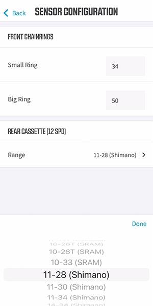

Setting gear configuration in the ELEMNT app (SRAM eTap / AXS only)

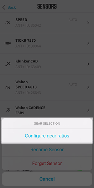

  1. Navigate to Settings > Set up Sensors
  2. Select your electronic shifter (will appear in the list as Gear Selection), then Configure Gear Ratios.
  3. Modify your chainring tooth count values and select your cassette spread, or select Custom to enter cog tooth counts individually.
Gear tooth count configuration in the ELEMNT app can only set the tooth counts of chainrings/cog counts as pre-defined by your drivetrain manufacturer in the drivetrain firmware.  It cannot override chainring or cassette cog count.

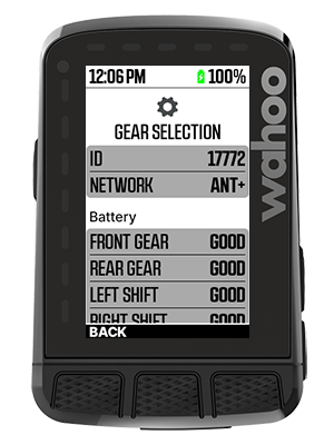

Viewing battery levels in computer sensor details
  1. Navigate to the Menu page (tap left side button).
  2. Scroll down to the Gear Selection or Shimano Di2 line item and select More (right button).
r2-gearselection2-r300.png r2-di2sensordetails2-r300.png r2-gearselectiondetails-r300.png

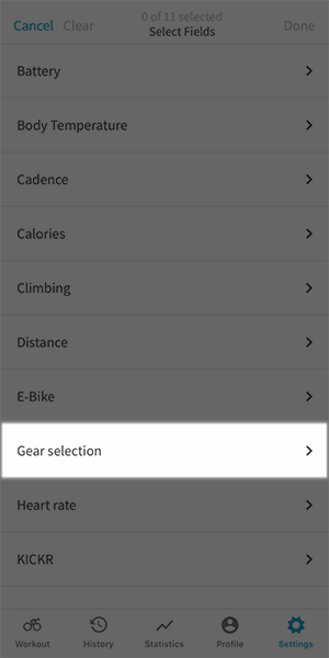

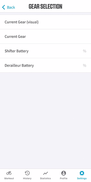

Adding battery level and gear selection data fields
Current battery level and gear selection data are available as data fields to be added to the page of your choice via the ELEMNT app.
  1. In the ELEMNT app, navigate to Settings > Customize Pages > choose your desired page (ex. Workout Data) > add or select a field > Gear Selection
    • Current Gear (visual)
    • Shifter Battery
    • Derailleur ("Gear") Battery
    • Current Gear ("Gear Num")
bica-page-selectfield-gearselectionhighlighted-300.png bica-page-selectfield-gearselectionoptions-300.png blanktrans300x600.png
