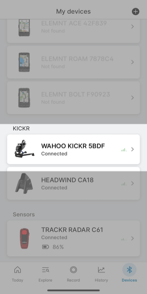

Wahoo app My devices screen with WAHOO KICKR listed as Connected

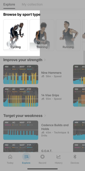

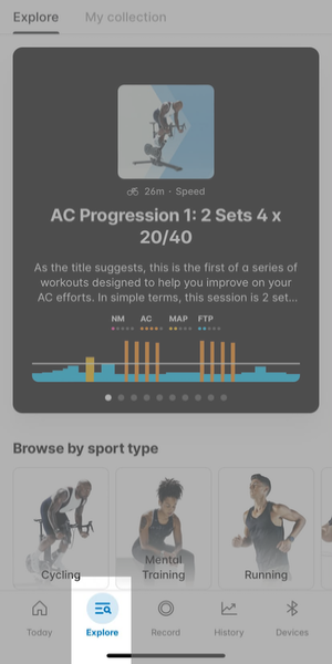

  2. In the Wahoo app, select the Explore icon on the bottom menu.
  3. Next, select the Cycling option.

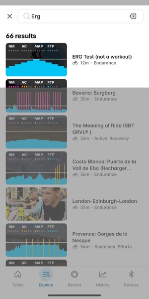

  4. Search for “ERG” to locate the test, labeled ERG Test (not a workout)
Wahoo app Explore tab with the Explore icon highlighted in the bottom menu
Wahoo app Explore tab with the Cycling option highlighted under Browse by sport type
Wahoo app search for Erg with ERG Test (not a workout), 12 minutes, highlighted as the first result

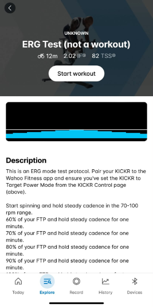

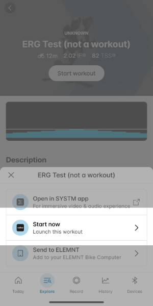

  1. Select Start Workout, then Start Now

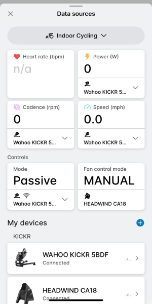

  2. Ensure your trainer is selected for all relevant data fields (Power, Cadence, Speed).
ERG Test (not a workout) details page in the Wahoo app with the Start workout button
ERG Test launch options in the Wahoo app with Start now (Launch this workout) highlighted
Wahoo app Data sources screen with Wahoo KICKR selected as the source for Power, Cadence and Speed

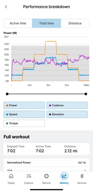

Once you're finished, you can analyze the data in the Wahoo app under “History.” A successful test will appear similar to this example:
Wahoo app Performance breakdown graph of a successful ERG test: power steps up evenly to about 250 W with no drops
The above test indicates no breaks or dips in connection with a modified test topping out at 250 watts. A successful ERG test will have the trainer broadcasting power and cadence values accurately without interruption. Wattage and cadence will feel realistic to your effort.
If the test was accurate but you’re still having issues with your trainer, it may be connected to something in the background or require calibration. See this page for further troubleshooting.

  4. In the Wahoo App, select the Explore icon on the bottom menu.
  5. Select the Cycling option.
  6. Search for “ERG” to locate the test, labeled ERG Test (not a workout).
  1. Select Start Workout, then Start Now.
