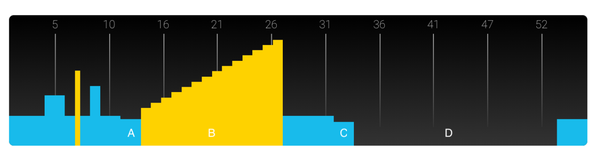

There are 4 components to Half Monty
A- The 2 minutes LEADING into the Ramp (after the warmup)
B-The Ramp Test (Big yellow set of stairs)
C-The 2 minutes LEADING into the Constrained effort
D-The Heart Rate Constrained Effort (The missing block in the workout profile)
Leading into the Ramp: Just ride this 2-minute section at the prescribed power target. Do not stop pedalling during this section. Do not sprint/surge during this section. Just ride it steady from the start to the first stage of the ramp.  These instructions also apply to section C- the 2 minutes leading into the constrained effort.
Ramp Test: The goal of this ramp is to go until you can't turn the pedals anymore. Unless you are frequently out of the saddle for all hard trainer efforts we recommend remaining seated for the entire ramp.
If you're not riding a smart trainer you’ll need to be honest and stick to the ramp targets as closely as possible. At no point should you maintain a prolonged effort ABOVE or BELOW the ramp power target. Doing so will skew your results, leading to less accurate results, which is only doing yourself a disservice.
Once you hit your stopping point (and you WILL, that means you did it correctly) you can sit and recover, or fast forward the workout to the end of the yellow section (do not skip more than 10 seconds into the blue section) During this time, those of you on smart trainers will want to switch to “Level” mode. All Smart Trainers are different, but level 2 is generally a good option for this effort. Leading into the Constrained: Like the portion leading into the ramp, ride this section steady. Smart trainer users should be in LEVEL mode at this point. Keep your power AT or BELOW the onscreen target for this section. Do not stop pedalling during this section. Do not surge during this section. Do NOT start the constrained effort early (meaning do not start the constrained effort during this lead-in section).
Constrained Effort: This effort is unique as the goal is a specific heart rate range, not a specific power target. You will be prompted with the heart rate range you should maintain after completing the ramp. The heart rate range displayed on-screen during this effort will represent this specific heart rate range. You will also be prompted with a suggested starting power after the ramp. Your heart rate takes several minutes to react to your effort and reach the target range. DO not feel the need to go hard in the first minute just to get your heart rate up quickly. We know there is a delay, we know it will take time, just stick to roughly the suggested power target we gave you during the recovery section. Once you reach the lower end of the heart rate range, you will want to change your effort up or down to make sure your heart rate remains in this small range.
During this section, you should maintain the type of cadence you normally would for a 20-minute effort. Do not ride at a lower than normal cadence just to try and keep your heart rate lower. DO NOT sprint or surge at the end of this effort. Your entire goal for this effort is to get into a stable effort that maintains the heart rate range; doing anything else will negatively impact your results. After you complete this session you will get updated FTP, MAP and LTHR results (assuming you completed the test correctly)
If you do NOT have a Heart Rate monitor After completing the ramp, we suggest spinning easy for 5-10 minutes to properly cool down. If you complete this session without a heart rate monitor you will only see updated FTP and MAP values.
