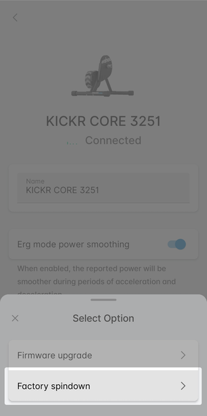

Factory Spindown

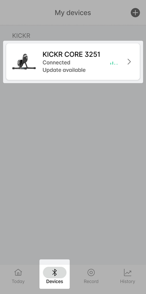

  1. Open the Wahoo app for iOS or Android
  2. Open the Devices Tab.
  3. Select the trainer (KICKR, CORE, etc) from the list.
  4. Quickly tap the trainer icon in the center of the screen 10 times or until the popup menu appears.
  5. Select Factory Spindown from the popup menu that appears.

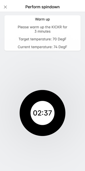

      1. Warm up for 3 minutes.
      2. If the resistance is too high to pedal during the warm-up period, do not attempt to pedal until the factory spindown process begins

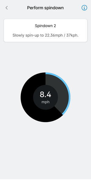

      3. Gradually pedal up to 23mph/37kph and stop pedaling when directed.
      4. Allow the trainer to spin down and wait for further direction.
      5. Again, gradually pedal up to 23mph/37kph and stop pedaling when directed.
      6. Allow the trainer to spin down and wait for further direction.

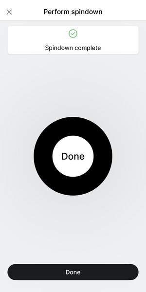

  7. A success or failure message will appear.

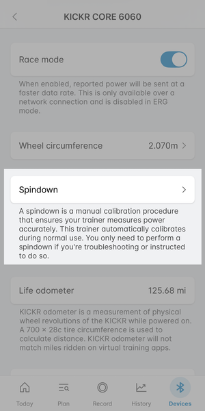

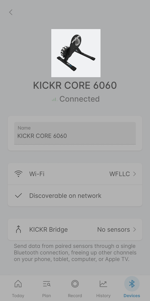

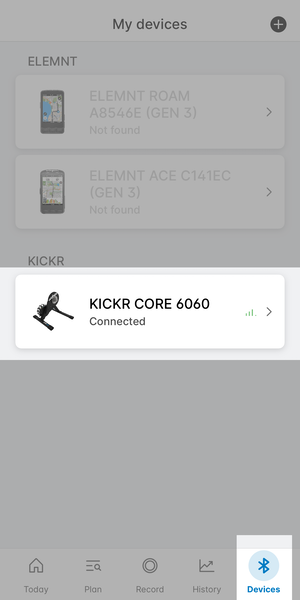

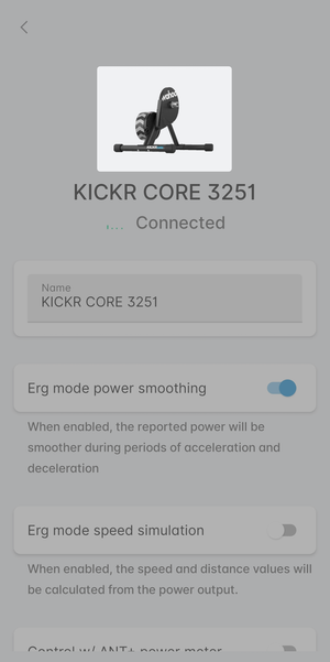

  1. Navigate to the trainer’s detail page in Wahoo app (Devices tab > Trainername). Select the CORE.

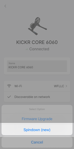

  2. Tap on the trainer icon 10x in rapid succession.
  3. Select Spindown (new) in the submenu that appears.
  4. The submenu will close and a new Spindown panel will appear on the trainer’s details page.

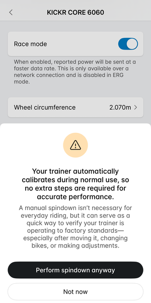

  5. Select Spindown. Then select Perform Spindown Anyway.

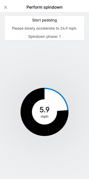

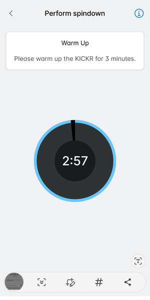

  6. Warm up the trainer by pedaling for 3 minutes.
  7. Pedal the trainer up to ~25 mph / 40 kph.

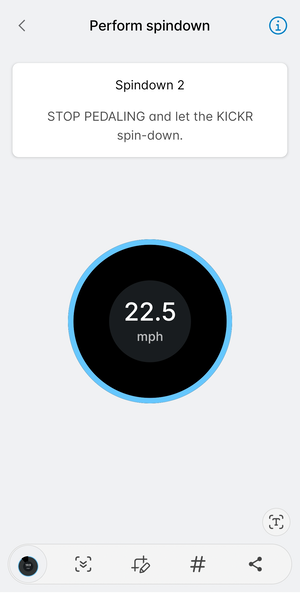

  8. Stop pedaling when directed, allowing the trainer’s flywheel to ‘spin down’ to a lower speed (not shown to the user) with the electromagnetic brake completely disengaged.

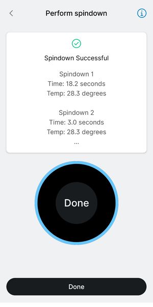

  10. The trainer measures the time it takes for the flywheel to spin down from ~20 mph (32 kph) > 10 mph (16 kph).
  11. Repeat steps #7-8 3x more times as prompted by the app. Each time, a different brake percentage will be applied (30, 60, 90%)
