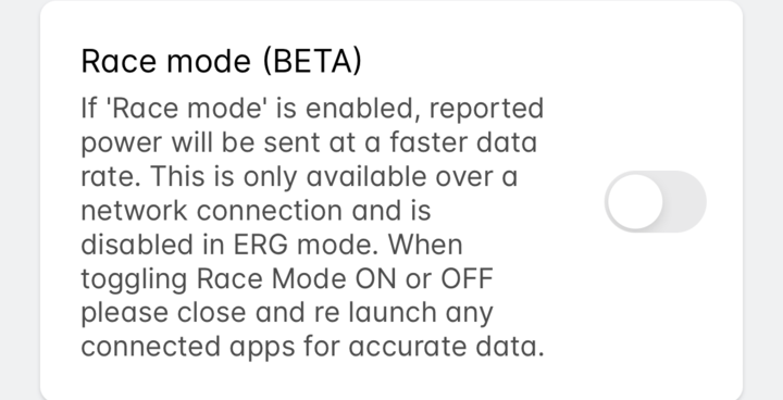

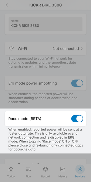

How to use Race Mode?
Prior to setting up your race app, open the Wahoo app, ensure the KICKR BIKE v2 is paired, navigate to Settings > Sensors > KICKR BIKE and toggle on Race Mode (BETA).  Then close the app and pair to your race app as normal.
When toggling Race Mode ON or OFF, please close and re-launch any connected apps for accurate data.
