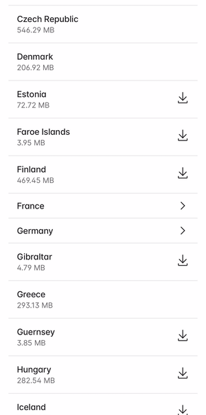

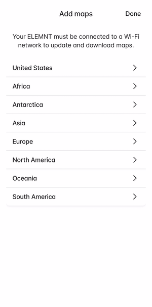

For BOLT 3
Because the BOLT 3 has only 32GB of storage, compared to ACE and ROAM 3's 64GB, but BOLT 3 also supports many of the same on-board routing functions, all Summit features, and robust color maps, it ships with most, but not all, of the world's maps loaded on the device.  At this step, you should confirm that your local geography is on the computer, and if not, add it by selecting:
  1. Add map
  2. Your region
  3. Your local geography.
    • This will queue the area for download. Downloads/installe
  4. When you have downloaded your area, select Continue.
Note, the maps already downloaded on the BOLT 3 were chosen by relative population density of our known customer base. For similar reasons, the United States are segmented from the rest of North America for quick access.
