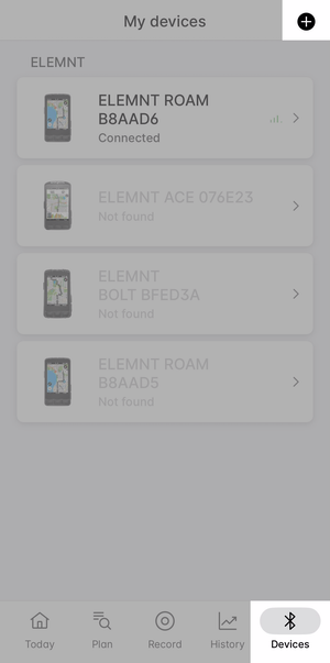

Pairing With the Wahoo App

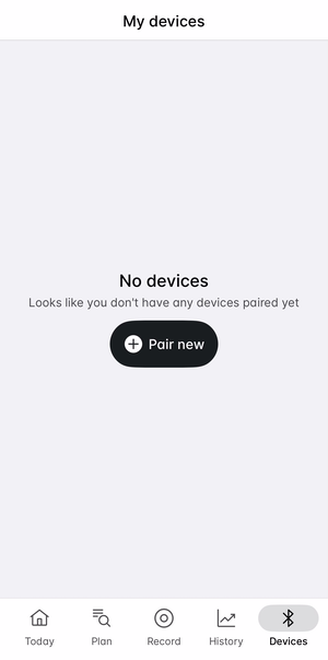

    1. Open the Wahoo app.
    2. Navigate to the Devices tab.

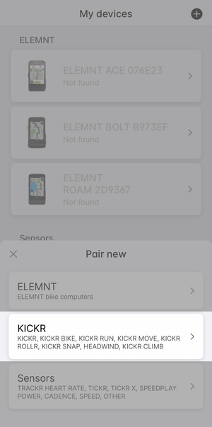

    3. Select Pair sensor (or the + sign if another sensor is paired).
wa-devices-addnew-300.png wa-devices-pair-300.png wa-device-pairkickrtype-300.png

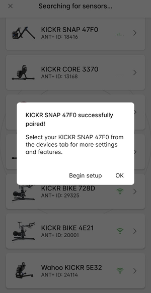

4. Select the KICKR SNAP
5. The SNAP is now paired.
