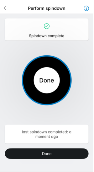

  4. Follow the instructions provided in the app. For maximum accuracy, do not pedal once the target speed displayed is reached.

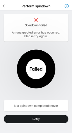

  5. The spindown will complete once the flywheel slows down on on its own. Unless a failure has been indicated, the calibration has been successful. If a failure is indicated, please ensure that all other devices are off and apps are closed and closely follow directions on screen again.
