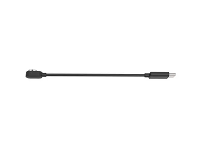

  • Charger type: USB-C to magnetic

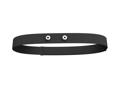

  • TRACKR HEART RATE Strap
  • USB-C to magnetic charging cable

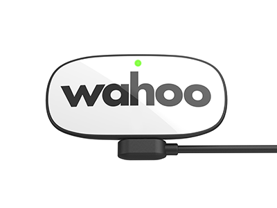

Wake TRACKR HEART RATE for first use
TRACKR HEART RATE pod connected to its magnetic charging cable, LED lit green
To wake the sensor for first use, connect the sensor to its charging cable and a power source.  In order to extend the life of the rechargeable battery and prevent battery drain in shipping and shelf time in the warehouse or at a store, the TRACKR HEART RATE sensor is set in a low-power "shipping" mode at the factory.  The sensor will be unresponsive until connected to its charger and a power source for the first time.

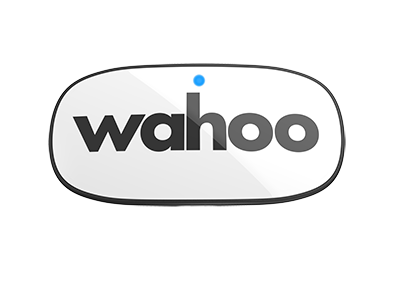

TRACKR HEART RATE pod with the LED lit blue
  • Blue LED slow flash: sensor is awake and searching for a connection
  • Blue LED quick flash: connecting to a device
  • Blue LED solid: connected to the device
LED operation shuts off 30 seconds after waking to conserve battery.

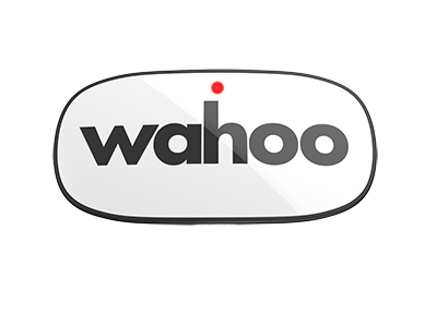

Low Battery Indicator
TRACKR HEART RATE pod with the LED lit yellow TRACKR HEART RATE pod with the LED lit red
When not connected to a power source and the battery level is below 25%, the LED will flash to indicate a low battery state.
  • Orange LED flash 3x: 5-25%
  • Red LED flash for 2 seconds: 0-5%
Below 5%, the pod will shut down. If powered on below 5%, the LED will flash red for 2 seconds, then shut down again.

In order to ensure the longevity of the heart rate monitor and strap, the TRACKR HEART RATE sensor pod should be removed before gently hand-washing the strap in warm water.  The strap should NOT be machine-washed.  The strap can be rinsed in warm water without the pod between washes to help remove salt deposits from the skin contact pads to ensure optimal conductivity.
