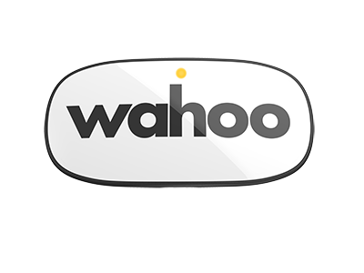

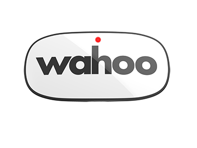

Low Battery Indicator
When not connected to a power source and the battery level is below 25%, the LED will flash to indicate a low battery state.
  • Orange LED flash 3x: 5-25%
  • Red LED flash for 2 seconds: 0-5%
Below 5%, the pod will shut down. If powered on below 5%, the LED will flash red for 2 seconds, then shut down again.
