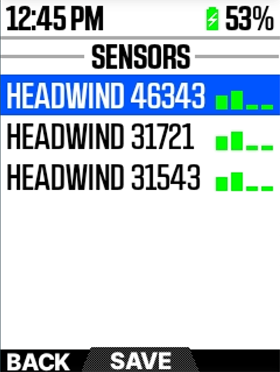

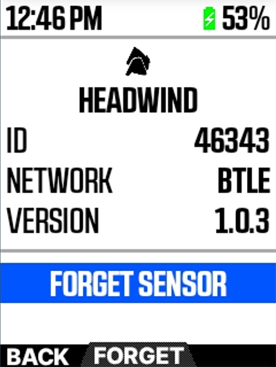

  1. Pair the Headwind like other sensors on the ELEMNT, BOLT, or ROAM
  2. Confirm the Headwind is paired as a Bluetooth sensor.

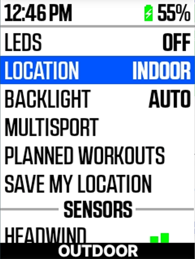

  3. Place the computer's Location as Indoor, or if a KICKR trainer is being used, pedal the trainer or BIKE to initiate KICKR mode on the ELEMNT, BOLT, or ROAM.

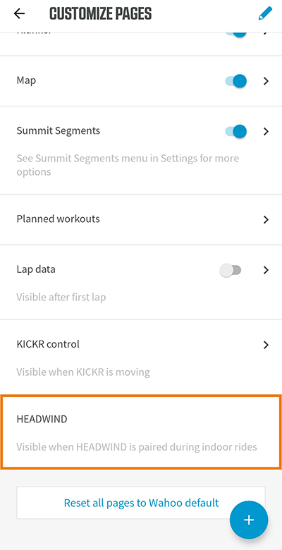

  4. Within approximately a minute, a Headwind control page will appear in the page order on the computer and in the ELEMNT companion app under Settings > Customize Pages, if paired. The position of the Headwind Control page in the page order can be changed like other pages in the ELEMNT app.
