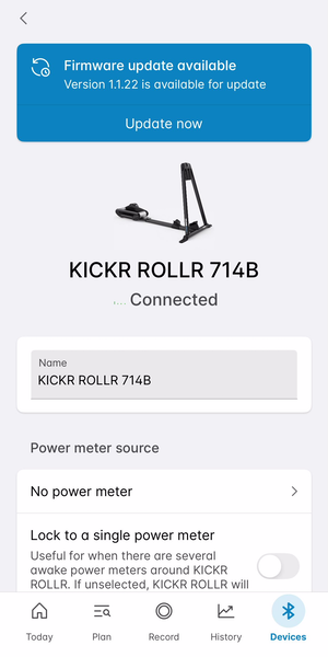

  1. Pair your KICKR ROLLR to the Wahoo app for iOS or Android like any other sensor, smart trainer, or smart bike.
  2. Once paired, select the ROLLR from the My sensors list in the Devices tab.

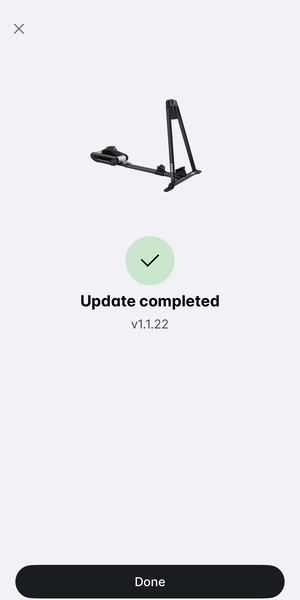

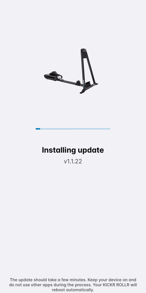

  3. Select Update now to update your ROLLR firmware.
    wa-rollr-details-firmwareupdate - 300px.png wa-rollr-firmwareupdating-300.png wa-rollrfirmwareupdated-300.png

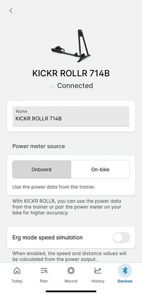

  4. Under Power meter source select Onboard. This is the default setting with the KICKR ROLLR.
