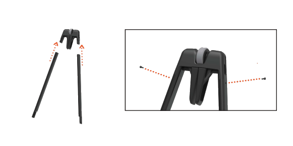

  3. Set up tire gripper A-frame. Attach support arts to the tire gripper assembly. Ensure both support arms are fully inserted.
  4. Install one (1) small Allen bolt on the outer side of each support arm.

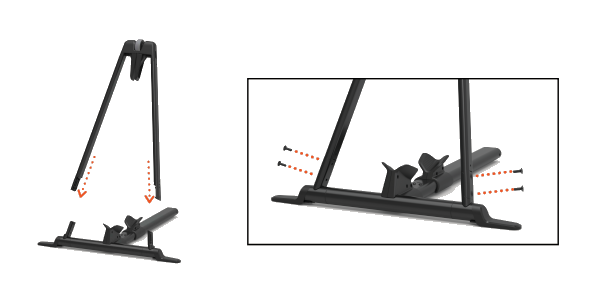

  5. Attach the tire gripper A-frame to the base. Slide the upper A-frame assembly onto the base from above. Hold the upper A-frame in place, fasten two (2) large Allen bolts on both sides of the front base from the outside.

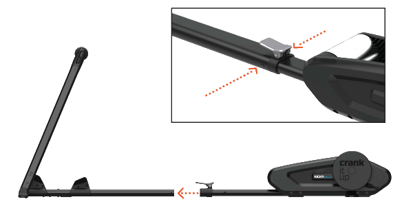

  6. Attach base to rear ROLLR body. Slide the rear ROLLR body arm into the base using the leg.
  7. Tighten the screws on both sides of the adjustment lever to secure the connection.

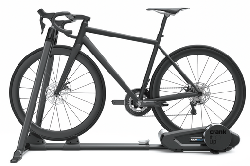

  8. Install your bike by placing the front wheel in the front wheel block and the rear wheel on the rollers.mceclip3.png

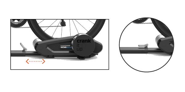

  9. Adjust the wheelbase:
    1. Lift adjustment lever.
    2. Slide rear body until the rear tire contacts both rollers evenly.
    3. Close lever back into place.
