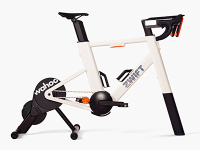

What is Zwift Ride 2 with KICKR CORE?
Zwift Ride 2 is a highly adjustable indoor smart bike frame equipped with Zwift Play controller buttons, virtual shifter and brake levers, and buttons for steering. It is bundled with a Wahoo KICKR CORE trainer with a Zwift Cog installed. Together they are optimized for virtual shifting in Zwift.

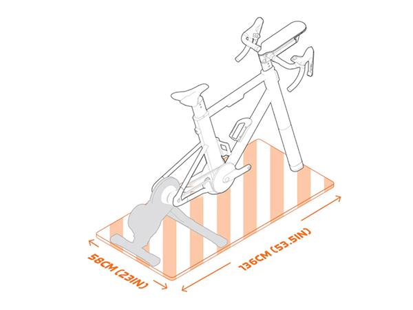

Combined Product Dimensions and Weight
Product surface area when setup: 53.5 in L x 23 in W
Product weight: 76 lbs (CORE 40 lbs, Zwift Ride 2 Frame 35.5 lbs)

Zwift Ride 2 Smart Frame
- Ride frame
- Handlebar with controllers*
- Frame key (6mm)
- 12x142 thru axle
- Left & Right pedals
- Phone tray mat
- Charging cable for controllers
- Cable tidies
*ships separately from bike frame
