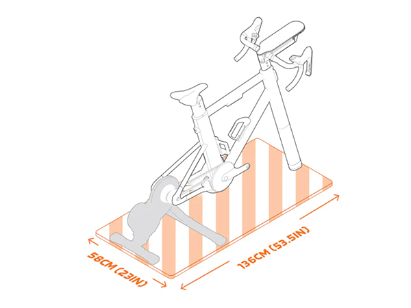

Combined Product Dimensions and Weight
Product surface area when setup: 53.5 in L x 23 in W
Product weight: 78 lbs. (CORE 40 lbs, Zwift Ride Frame 38 lbs)
