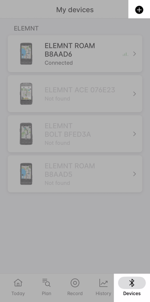

  1. Open the Wahoo app.
  2. Navigate to the Devices tab.

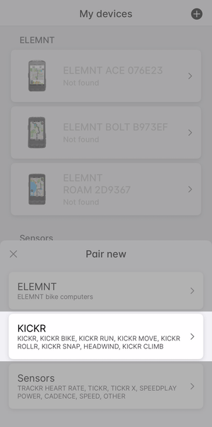

  3. Select Pair sensor (or the + sign if another sensor is paired).

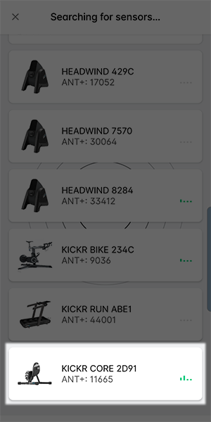

  4. Select your Wahoo smart trainer.
Wahoo app My devices screen with the + button at top right and the Devices tab highlighted Wahoo app Pair new menu with the KICKR option highlighted (KICKR, KICKR BIKE, KICKR RUN, KICKR MOVE and more) Wahoo app Searching for sensors list with a KICKR CORE highlighted to select it

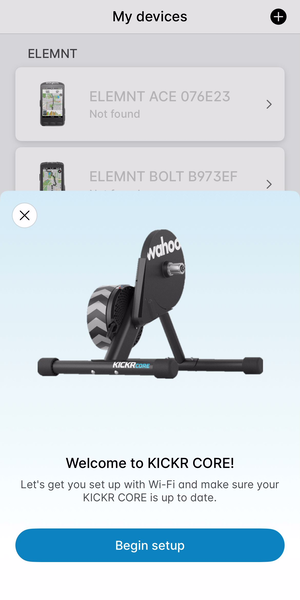

  1. The trainer is now basically paired.

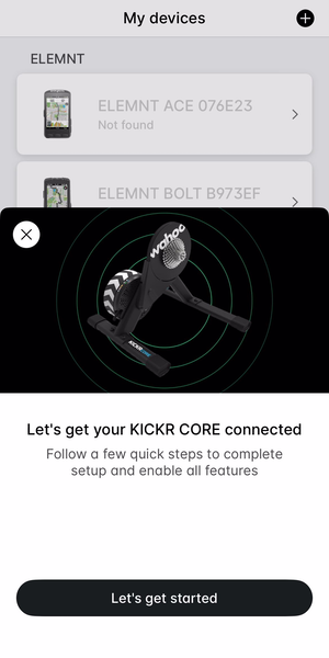

Wahoo app Welcome to KICKR CORE! prompt with the Begin setup button

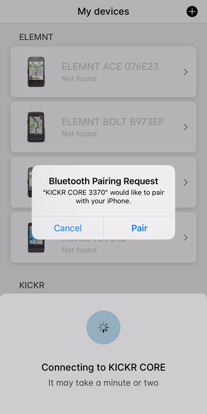

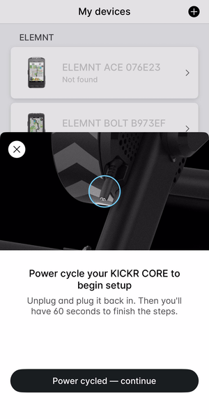

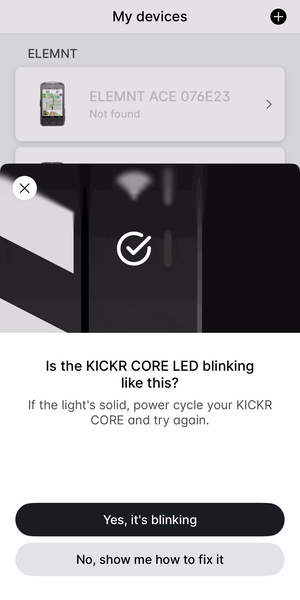

  1. If your unit can securely pair, you will be prompted to connect and power cycle your unit within 60 seconds.
  2. Follow the prompts and directions on the Wahoo app for: power cycling, LEDs, and Bluetooth permissions to securely pair.
Wahoo app Let's get your KICKR CORE connected screen with the Let's get started button Wahoo app prompt to power cycle the KICKR CORE: unplug, plug back in, then tap Power cycled — continue Wahoo app asks Is the KICKR CORE LED blinking like this? with Yes, it's blinking and No, show me how to fix it

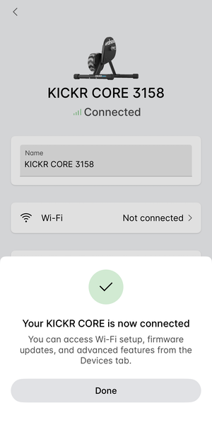

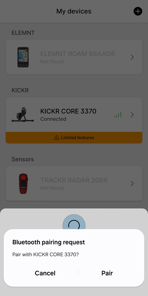

iPhone Bluetooth Pairing Request for KICKR CORE with Cancel and Pair, while the app shows Connecting to KICKR CORE Android Bluetooth pairing request: Pair with KICKR CORE? with Cancel and Pair buttons Wahoo app confirmation: Your KICKR CORE is now connected, with a Done button

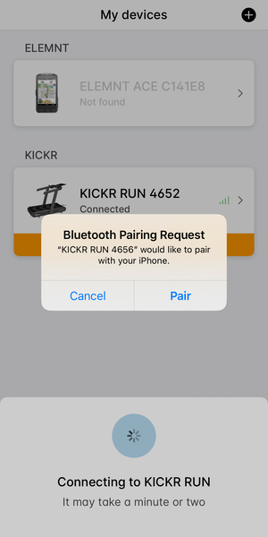

Securely pair a KICKR RUN to the Wahoo app
For units equipped with secure pairing, the process involves pairing the KICKR RUN to the Wahoo app using the normal pairing process, plus a few steps. Follow these steps:

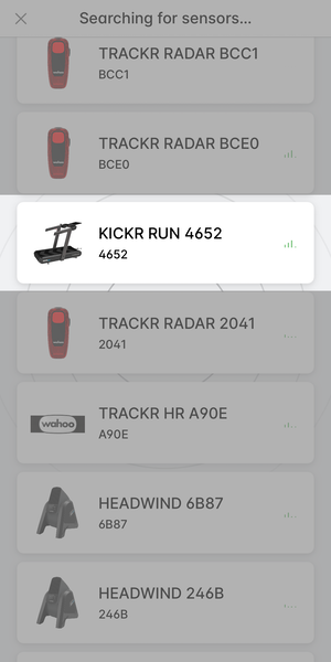

  4. Select the KICKR RUN to begin the pairing process.
Wahoo app My devices screen with the + button at top right and the Devices tab highlighted Wahoo app Pair new menu with the KICKR option highlighted (KICKR, KICKR BIKE, KICKR RUN, KICKR MOVE and more) Wahoo app Searching for sensors list with a KICKR RUN highlighted to select it

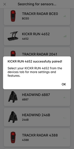

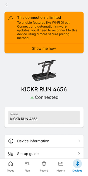

  1. Once the KICKR RUN is paired, if you select OK, the device will enter the Secure Pairing process. If you navigate away without completing it, the device will be paired, but because it has not been paired securely, will not be able to set up a Wi-Fi connection.  To resolve this, select Show me how.
Wahoo app message KICKR RUN successfully paired! with an OK button Wahoo app KICKR RUN device page with the orange This connection is limited banner and Show me how link

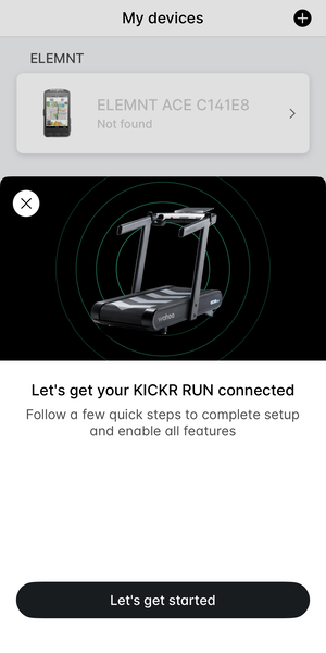

  1. Once you're back to the Secure Pairing process, follow the prompts on the KICKR RUN and in the Wahoo app.

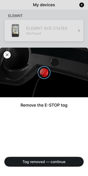

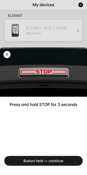

Wahoo app Let's get your KICKR RUN connected screen with the Let's get started button Wahoo app step Remove the E-STOP tag, showing the red tag on the KICKR RUN, with Tag removed — continue Wahoo app step Press and hold STOP for 3 seconds on the KICKR RUN console, with Button held — continue

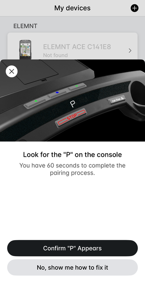

Wahoo app step Look for the "P" on the KICKR RUN console within 60 seconds, with Confirm "P" Appears iPhone Bluetooth Pairing Request for KICKR RUN with Cancel and Pair, while the app shows Connecting to KICKR RUN
  1. Once you have selected Pair, you will re-enter the standard setup flow for connecting your KICKR RUN to Wi-Fi and updating the KICKR RUN's firmware to its current version via Wi-FI.

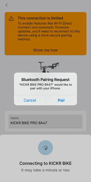

Securely pair a KICKR BIKE PRO to the Wahoo app
For units equipped with secure pairing, the process involves pairing the KICKR BIKE PRO to the Wahoo app using the normal pairing process, plus a few steps. Follow these steps:

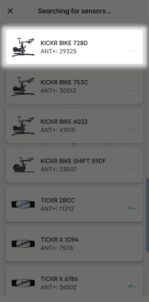

  4. Select the KICKR BIKE PRO to begin the pairing process.
Wahoo app My devices screen with the + button at top right and the Devices tab highlighted Wahoo app Pair new menu with the KICKR option highlighted (KICKR, KICKR BIKE, KICKR RUN, KICKR MOVE and more) Wahoo app Searching for sensors list with a KICKR BIKE highlighted to select it

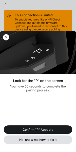

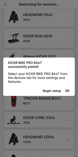

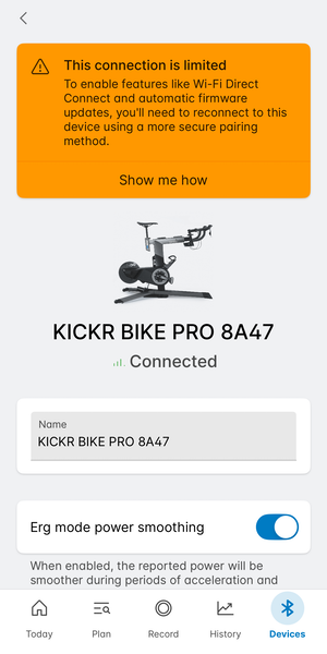

  1. Once the KICKR BIKE PRO is paired, If you select Begin setup, you will enter the Secure Pairing process. If you select OK, the device will be paired, but because it has not been paired securely, will not be able to set up a Wi-Fi connection.  To resolve this, select Show me how.
Wahoo app message KICKR BIKE PRO successfully paired! with Begin setup and OK options Wahoo app KICKR BIKE PRO device page with the orange This connection is limited banner and Show me how link

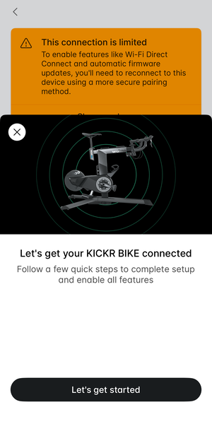

  1. Once you're back to the Secure Pairing process, just follow the prompts on the KICKR BIKE PRO and the Wahoo app.

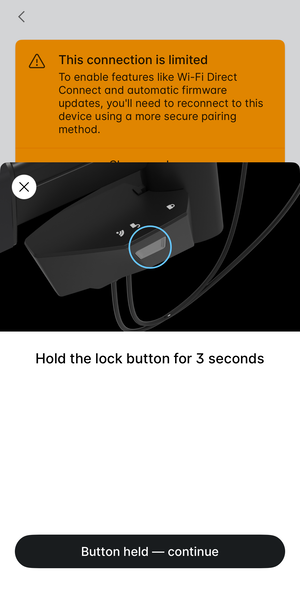

Wahoo app step Look for the "P" on the KICKR BIKE screen within 60 seconds, with Confirm "P" Appears Wahoo app Let's get your KICKR BIKE connected screen with the Let's get started button Wahoo app step Hold the lock button for 3 seconds on the KICKR BIKE, with Button held — continue

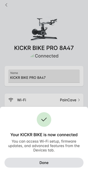

iPhone Bluetooth Pairing Request for KICKR BIKE PRO with Cancel and Pair, while the app shows Connecting to KICKR BIKE Wahoo app confirmation: Your KICKR BIKE is now connected, with a Done button
