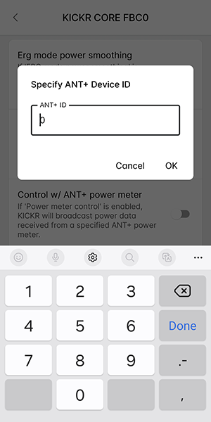

Enable the Feature
  1. Ensure the KICKR is plugged in and awake (by pedaling a few revolutions).
  2. Open the Wahoo Fitness app to the Devices tab and select your trainer.
  3. Once fully connected, scroll down to Control w/ANT+ power meter and toggle it on.
  4. Enter your power meter's 5 digit ANT+ ID and select OK.
wad-home-devicesselected-300.png CORE-sensordrawer-highlight-crop-sm.png core-controlwantpm-enabled-300.png
core-controlwantpm-specifyANT+-300.png blanktrans300x600.png blanktrans300x600.png
