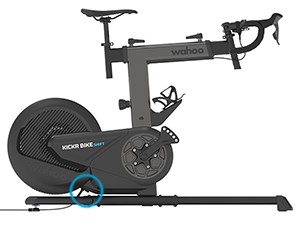

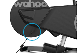

  1. Connect the direct connect adapter to the direct connect port, located on or immediately adjacent to the power dongle of the smart trainer or bike.
  2. Connect one end of an Ethernet cable into the adapter
  3. Connect the other end directly into your PC, router, or Wi-Fi access point, depending on your preferred setup.

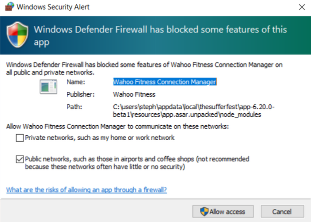

Direct Connect and Windows (firewall)
If you are connecting the Direct Connect Adapter directly to your Windows PC, be sure to allow the connection when prompted (typically when opening your selected app). The current working connection type is automatically checked when the prompt appears, but can be edited, if needed, via Control Panel > Windows Defender Firewall > windowsbtle.exe
Once the connection is allowed, the trainer should appear when searching for trainers in your selected app similarly to how it would on a wireless connection.
