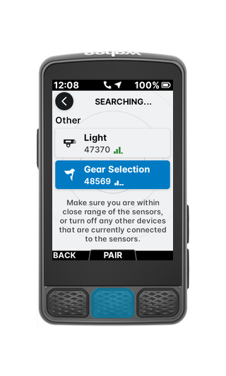

How to pair electronic drivetrains

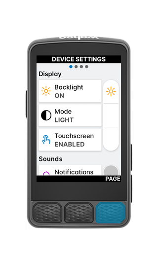

On the ELEMNT computer

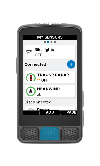

  1. Ensure the shifter/derailleur is awake and near the computer.
  2. Navigate to the Device Settings page (tap left side button).
  3. Navigate to the My Sensors page (tap the bottom right page button)
  4. Scroll down and select the (+) symbol or select Add (middle button) to add a sensor
  5. When your sensors appear (either Shimano Di2 or Gear Selection for other drivetrains), use the right side buttons to scroll to highlight the sensor and select Pair (middle button).

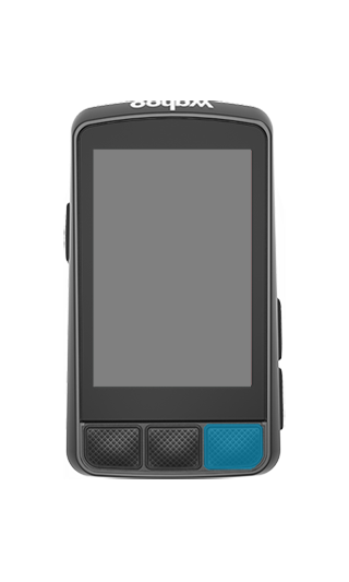

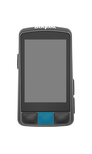

ELEMNT computer button control

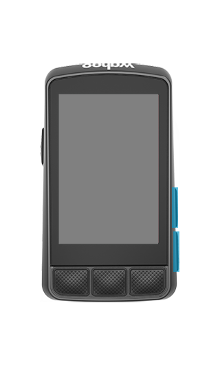

Shimano Di2 and some SRAM AXS drivetrains allow for pre-mapped button control of ELEMNT computers.  The button mappings are hard-coded and not customizable.
Shimano Di2 -  ELEMNT computer control
Shimano Di2 drivetrains with additional buttons located on top of the hoods and wireless connectivity integrate with all ELEMNT computers to allow most remote button controls from the hoods.
  • Quick press left hood button to simulate pressing the left front computer button.
  • Quick press right hood button to simulate pressing the right front computer button.
  • Long press left hood button to simulate the up (left)  right side computer button.
  • Long press right hood button to simulate the  down (right) right side computer button.
ELEMNT computers are designed to work with the default settings for the shifter hood buttons.
  1. Ensure that the shifter hood buttons do not already have a function designated to them in the E-Tube Project app, leaving them open.
  2. The left hood button should be configured for ch. 1 and the right hood button should be configured to ch. 2.
SRAM AXS -  ELEMNT computer control
SRAM Red shifters (2024+) with additional 'Bonus' buttons located on top of the hoods and/or AXS Wireless blips integrate with ELEMNT computers to allow for button control from the bars.
Red shifter Bonus buttons can be mapped to simulate all button controls, except the left side Power / Menu button..
A pair of AXS Wireless Blips can be mapped to simulate ELEMNT front button controls.

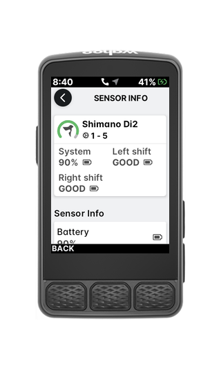

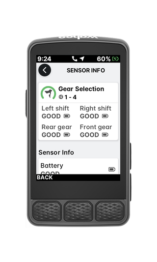

View current gear and battery levels in sensor details
Shimano Di2 SRAM eTap + other
The current gear selection and battery status of the electronic drivetrain will be visible on the drivetrain's sensor detail page in the ELEMNT computer's sensor menu.  Specifically, the following will be visible on the sensor details page:
  • Numerical indication of current front and rear gear position
  • Shifter battery levels (if shifters are powered by individual batteries)
  • Derailleur battery level(s)
    • Listed as a percentage if powered by main Shimano Di2 battery
    • Presented separately with battery icons if powered by individual batteries

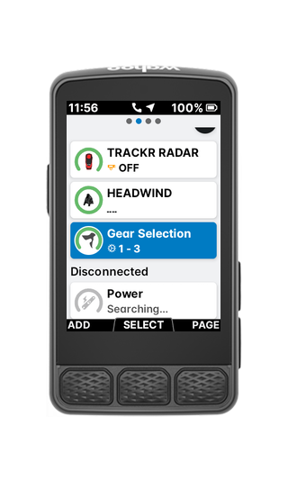

  1. Once the electronic drivetrain is paired, navigate to the Device Settings page (tap left side button)
  2. Navigate to the My Sensors page (tap the bottom right button)
  3. Select the Shimano Di2 or Gear Selection line item using the touchscreen or right side buttons to scroll and middle button to select Select.

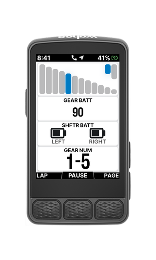

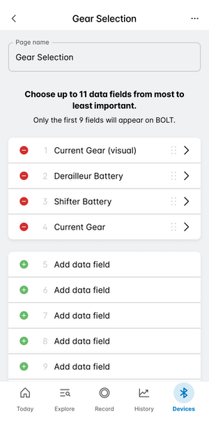

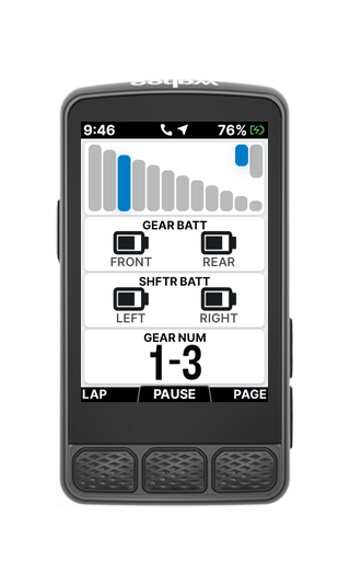

Set current gear and battery levels as data fields
In addition to being visible on the sensor details page, current gear selection and battery level details can be added as workout page data fields. Specifically, the following details are available:
  • Graphical representation of current front and rear gear selection
  • Numerical values of current front and rear gear selection

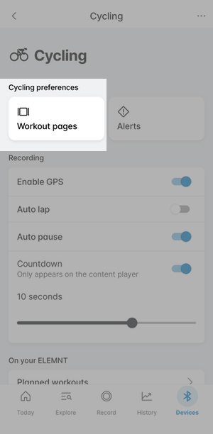

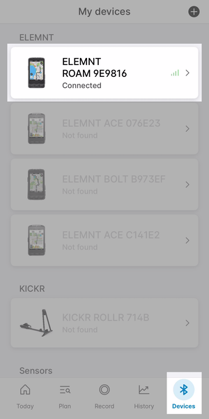

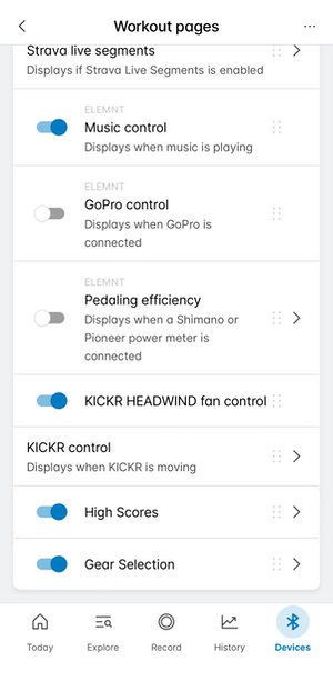

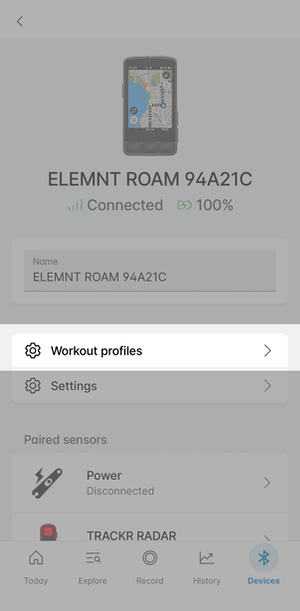

In the WAHOO app
  1. Navigate to Devices tab >
  2. Select the paired computer >

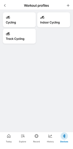

  3. Select Workout Profiles >
  4. Select the workout profile you wish to edit >
  5. Select Workout Pages >
  6. Select the page you wish to edit (or add a new one) >
  7. Select the data field you wish to replace (or add a new one)
  8. Select one of the following data fields from under Gear Selection:
    • Current Gear (visual)
    • Derailleur ("Gear") Battery
    • Shifter Battery
    • Current Gear ("Gear Num")

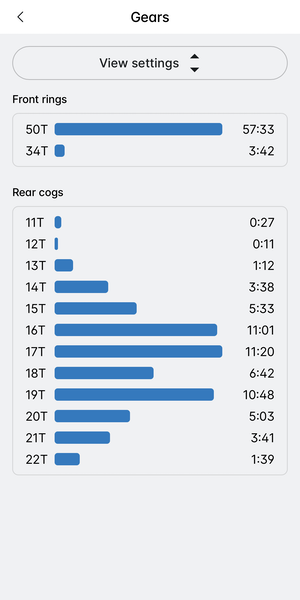

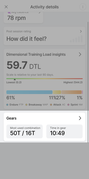

View historical gear selection in ride history
Gear selection data for individual rides are visible in the activity details of rides found in the History tab. Specifically the following details are available for review:
  • Favorite gear combination (dependent upon gear configuration in the WAHOO app)
  • Time spent in each gear

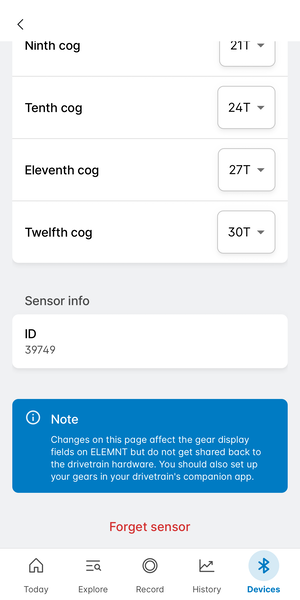

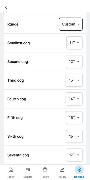

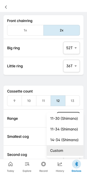

In order to correctly model your bike's gearing, you can set the tooth counts of both chainrings and cassette cogs.
wa-activitydetails-gearselection-300.png wa-activitydetails-gearselect-details-300.png blank320x10.png

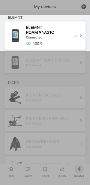

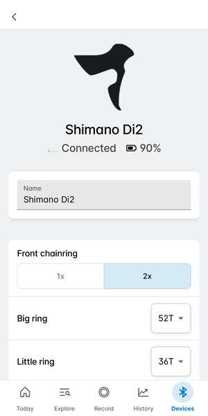

To configure the drivetrain's tooth counts, once it has been paired to your ELEMNT computer
  1. Open the Wahoo app.
  2. Navigate to the Devices tab.

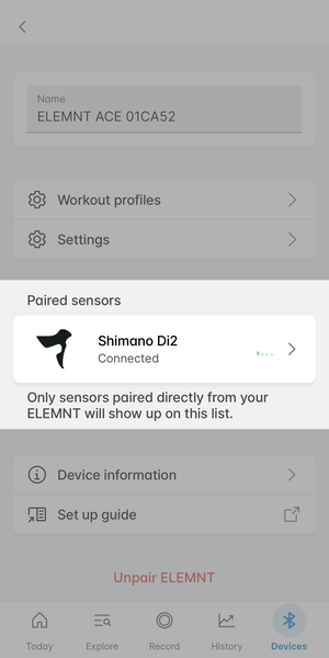

  3. Select the ELEMNT computer.
  4. Select the drivetrain from under the Paired sensors menu.
  5. Use the drop down menus to configure the tooth counts of chainrings and select a pre-configured cassette or Custom to manually set the tooth count for each cassette cog.
You can modify the tooth counts of both chainrings and cassette cogs, as well as cassette cog count. Your drivetrain's chainring count, however, will be mirrored from your drivetrain and cannot be overwritten.  In the case that you have manually converted a 2x crankset into a 1x setup, set the default chainring as
Also, please note that configuration of your gears in the Wahoo app has no impact on your drivetrain's actually configuration. To modify your drivetrain's configuration, use the manufacturer's proprietary app.
wa-devices-r3selected-300.png wa-ace-pairedsensors-di2-300.png wa-ace-shimanodi2-300.png
wa-ace-shimanodi2-custom-300.png wa-ace-shimanodi2-custom2-300.png wa-ace-shimanodi2-note-300.png
