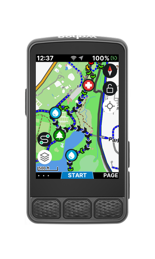

The feature set for custom waypoint on the computers is fairly simple.  Once a route with viable custom waypoints are loaded onto an ELEMNT ACE, BOLT 3, or ROAM 3, the custom waypoints will appear on the map page, in the cue sheet, and on a new Waypoints page. They will be treated like other waypoints that identify turns and will generate a notification pop-up as you approach them in a similar interval
On the map page

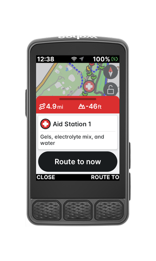

All custom waypoints associated with the route loaded will appear on the map page.  When the touchscreen is unlocked, the you can tap on a waypoint to expand its details, including its name, any description or comment attached to it, and your current distance and elevation difference from it.

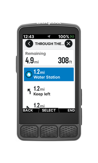

Custom waypoints will appear in the cue sheet like other cues, but with their type icon and name instead of the turn directions at the point they occur in the route. You can select them using the middle SELECT button (or the. touch screen for ACE and ROAM 3) to expand to see any related notes.

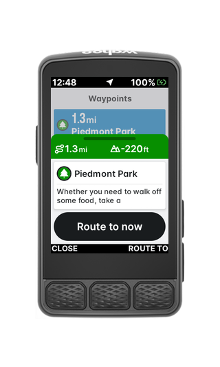

In order to reduce the scrolling necessary to identify the waypoints in a route, when a route that contains custom waypoints is loaded, a Waypoints page is added to the page stack immediately after the map page.
r3-waypointspage-r300.png r3-cw-waypointspage-piedmontdetail-r300.png blank300x10.png

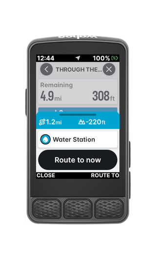

From any Waypoint's expanded details panel, you are offered the opportunity to route to that waypoint from your current location immediately.  Selecting ROUTE TO (or the on screen button for ACE and ROAM 3) will cause the computer to generate the routing engine's best perceived route direct to that waypoint's location on the map, disregarding your prior course to that point in the route.
