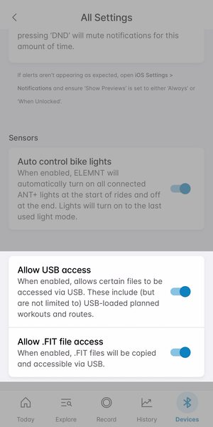

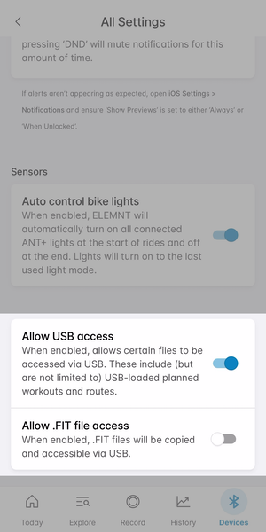

To secure your potentially sensitive personal data, USB access to ACE, BOLT 3, and ROAM 3 computers is disabled by default. To enable USB access, navigate in the Wahoo app to the Devices tab > [Your Device] > Settings and toggle the USB access options on at the bottom.
Note: To access completed activities, both "Allow USB access" and "Allow .FIT file access" must be enabled.
ELEMNT All Settings in the Wahoo app with Allow USB access on and Allow .FIT file access off ELEMNT All Settings in the Wahoo app with both Allow USB access and Allow .FIT file access on

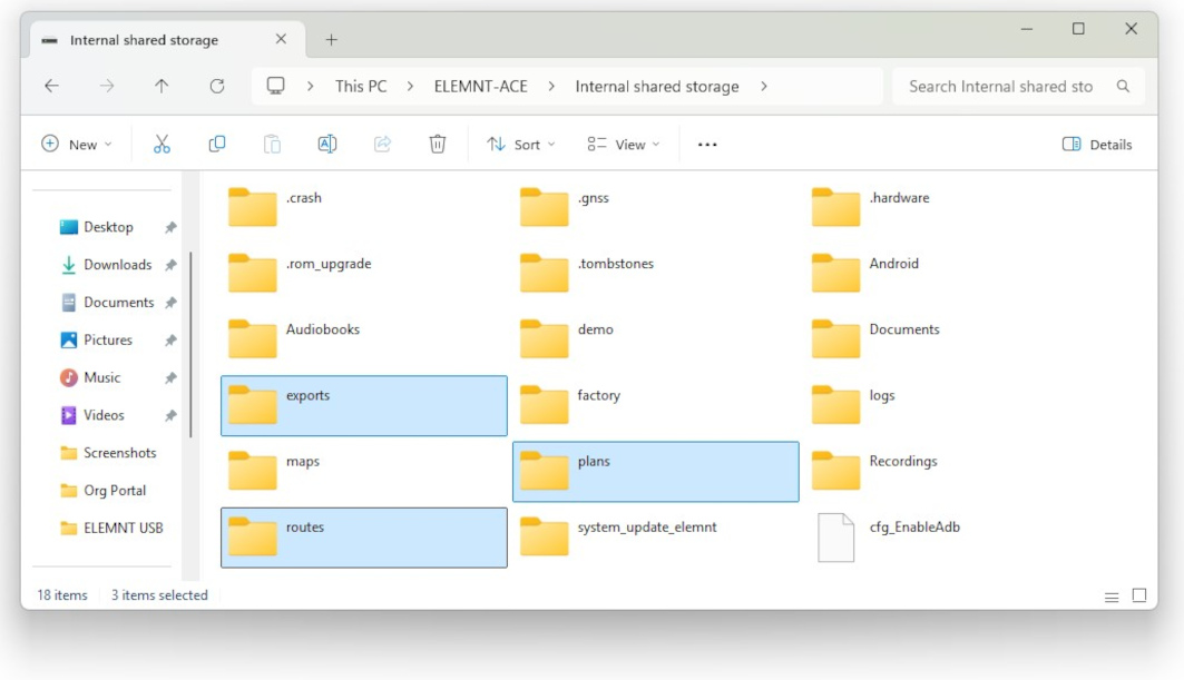

Windows File Explorer showing ELEMNT-ACE Internal shared storage with exports, plans and routes folders selected
On the ACE, BOLT 3, or ROAM 3, completed rides are stored in the exports folder, structured ("planned") workouts are stored in the plans folder, and routes are stored in the routes folder.

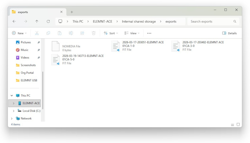

In the case that you are unable to sync a completed ride from your ELEMNT ACE, BOLT 3, or ROAM 3 to your Wahoo account via the Wahoo app or Wi-Fi, your completed rides can be copied from the exports folder and pasted onto your computer, for analysis and manual sharing with third party apps.
Windows File Explorer showing the ELEMNT-ACE exports folder with completed ride .FIT files

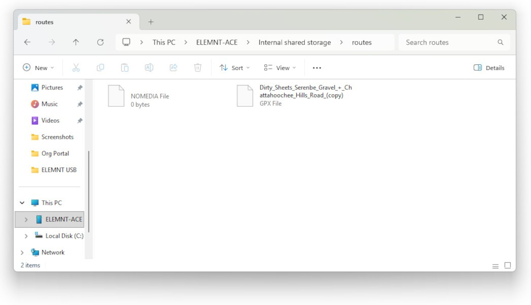

Route or structured workout files can also be manually imported  into their respective folders for use on your ELEMNT computer.
Manually imported files are only accessible from the ELEMNT computer, and cannot be backed up, or managed in the Wahoo app. For this reason, we instead suggest using cloud sync functions to load routes and planned workouts.
Windows File Explorer showing the ELEMNT-ACE routes folder containing a GPX route file

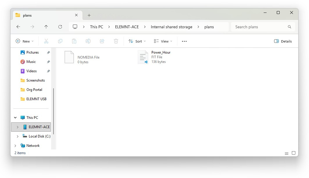

Windows File Explorer showing the ELEMNT-ACE plans folder containing a workout .FIT file
