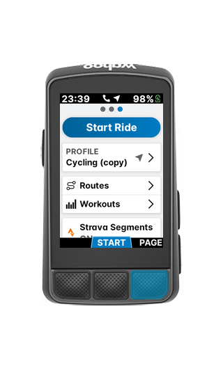

  2. From the Ready to Ride page that first appears, select the front right Page button twice to access the My Sensors page.  If you have already started a right, select the left side power button to access the Settings menu, then use the Page button.

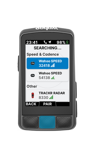

  4. Use the right side buttons to select the sensor you wish to pair from the list that appears and select Pair.

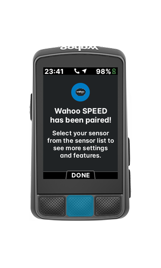

  6. You will then see a pairing success screen. Select Done.

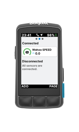

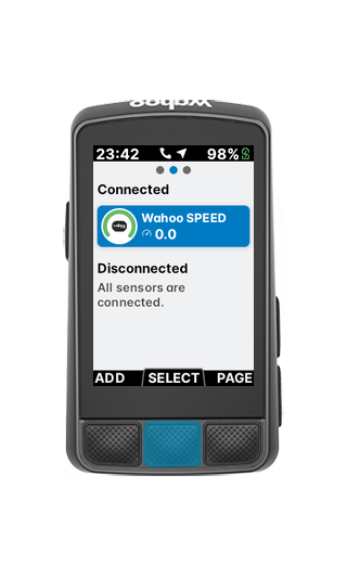

  7. Once paired, (and still awake), the sensor will appear in the saved sensors list. If connected, the sensor will appear in full color, showing battery level as a fuel gauge (or text percentage on the My Sensors page) and displaying any data the sensor is transmitting at that moment, so you can confirm the viability of the connection.  If a sensor is asleep or not in range, it will show as grayed out or disconnected.

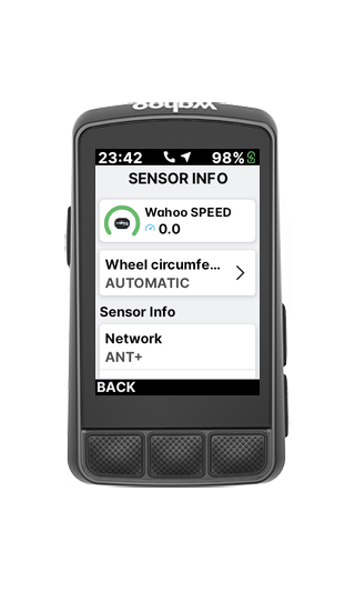

  8. Sensor details and settings (like crank length or calibration for a power meter), can be accessed by using the right side buttons and middle front button to select the sensor.

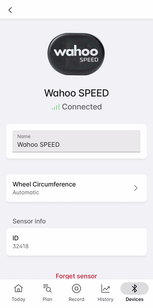

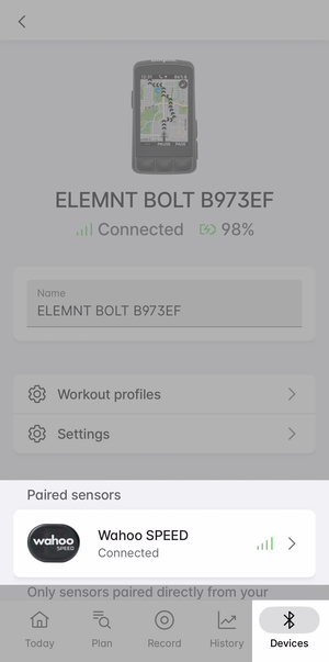

Because the Wahoo app also offers the ability to pair sensors directly to the app when the app is used as an activity recorder (the Record tab), the ELEMNT ACE and ROAM 3 do not support indirect sensor pairing via the Wahoo app.  Once a sensor is paired to an ELEMNT computer, however, sensor info and available settings may be accessed from the Wahoo app > Devices tab > ELEMNT > sensor name. From this screen, you can also change the name of the sensor.
