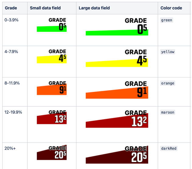

The feature set uses elevation data built into map files to provide anticipated grades and extended climbs.  Grades are categorized by a percentage range and assigned a color.  The colors are then used in a grade data field, an available elevation profile view, and chevrons on the map page to demonstrate the severity of upcoming climbs.

Grade color categorization

Grade data field with grade-categorized color background
The Grade (slope background) data field offers a color background to match the color of current grade. It can be added to any page with customizable data fields.  It can be found in the Climbing > Climbing section of the available customizable data fields in the Wahoo app.  See Customize workout profiles and pages for ELEMNT ACE, BOLT 3, or ROAM 3.

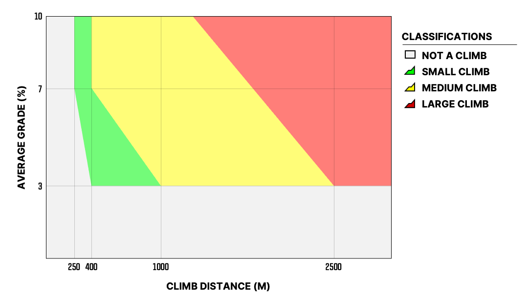

Climb detection customization
Climbs are classified as small, medium, and large by their average grade and distance. Uphill sections with less than a 3% average grade OR less than 250 meters in length are not classified/defined as climbs.
You can set which climbs (all, medium and large, or only large) are identified in the Summit Segments feature described below in the Wahoo app workout profile > Summit Segments > Climb Detection.
