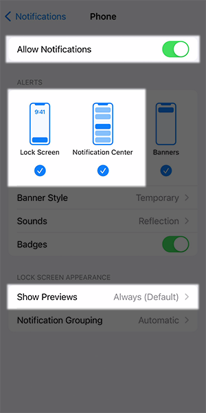

  6. Confirm that the following settings are toggled on/selected
    1. Settings > Notifications > Messages
    2. Settings > Notifications > Phone
      ios-setting-notifications-messages-hlight-300.png ios-settings-notifications-phone-hlight-300.png blanktrans300x600.png

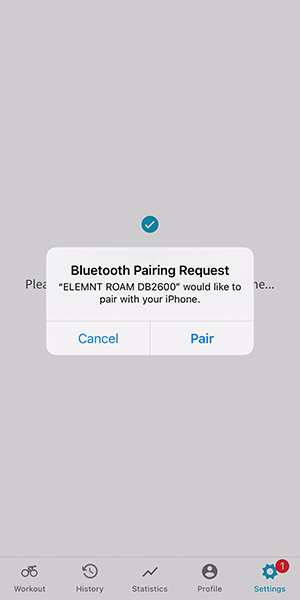

  7. If unresolved, Forget and the re-pair the ELEMNT computer, confirming both the Bluetooth pairing and notifications permissions when prompted.
    bica-btpairingrequest-300v2.png bica-pairnotificationsrequest-300v2.png blanktrans300x600.png

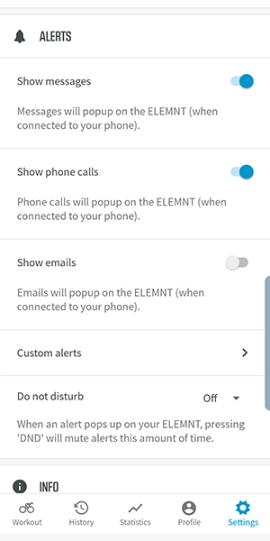

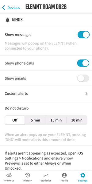

  1. Confirm you have the relevant alert type (messages, phone calls, emails) enabled in the ELEMNT app > Settings > Alerts and that Do not disturb is not toggled on.

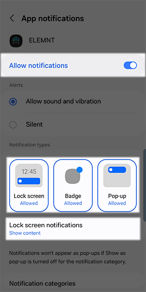

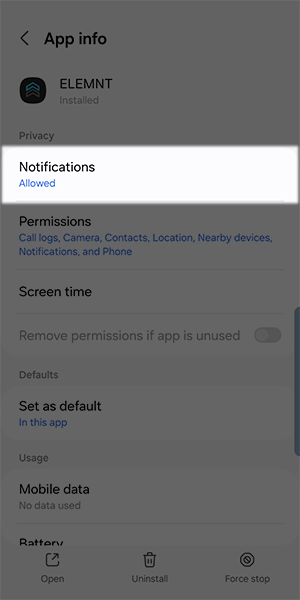

  6. Confirm that the following settings are toggled on/selected in Settings > Apps > ELEMNT Notifications
    android-settings-apps-baca-notificationsselected-300.png android-settings-apps-baca-notificationssettingsselected-300.png blanktrans300x600.png

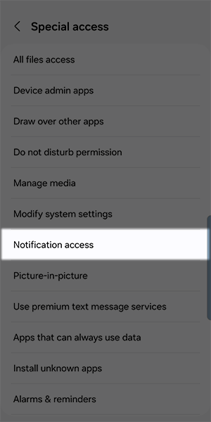

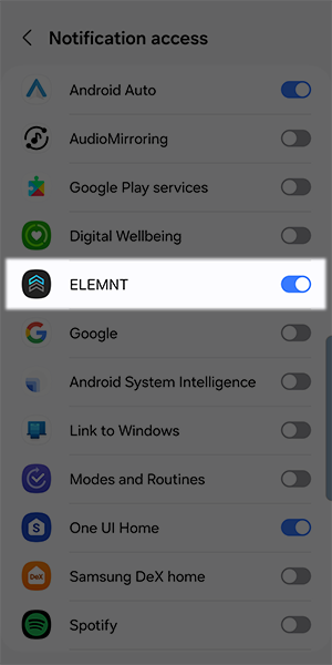

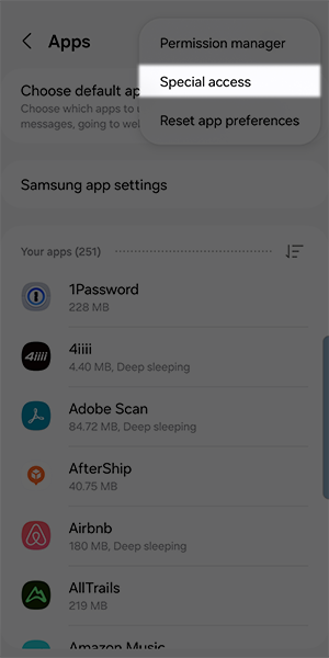

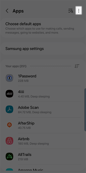

  7. Confirm that the ELEMNT app has notification access in Android Settings > Apps > Special Access > Notification access
    android-settings-apps-threedotsselected-300.png android-settings-apps-specialaccessselected-300.png android-settings-apps-specialaccess-notificationsselected-300.png android-settings-apps-specialaccess-notifications-access-300.png
