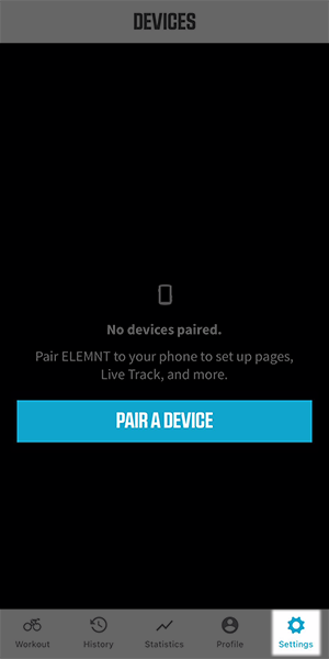

  1. Open the ELEMNT app.

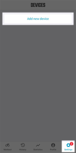

  2. Navigate to the Settings tab.
  3. Select Add new device or Pair a device as it appears.

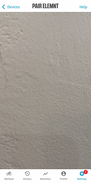

  4. The app will turn on your phone's camera. Hold the phone above the ELEMNT so that the QR code is fully visible in the ELEMNT app.  Move the phone closer or farther away as necessary.

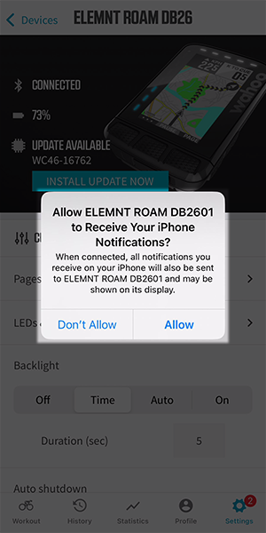

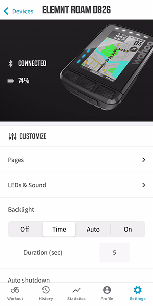

  1. Select Pair to authorize the phone to pair with the ELEMNT when prompted.
  2. Select Allow to authorize the ELEMNT to receive notifications when prompted.
  3. The ELEMNT is now paired and will return to the Settings tab.

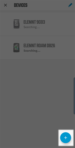

  3. Select Devices in the top right corner.
  4. Select the (+) add icon in the bottom right corner.

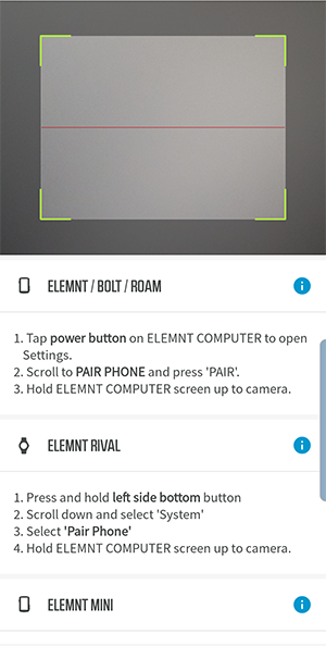

  5. The app will turn on your phone's camera. Hold the phone above the ELEMNT so that the QR code is fully visible in the ELEMNT app.  Move the phone closer or farther away as necessary.

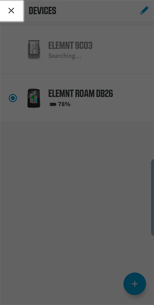

  1. The ELEMNT is now paired.
  2. Select the X icon in the upper left corner to return to the Settings tab.

  1. Move the phone camera farther from the ELEMNT. Often the correct distance is farther than feels natural.
  2. Make sure your mobile device's camera is clean and clearly focused on the computer.
  3. Keep the ELEMNT's screen clear of reflections and debris.

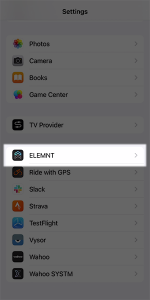

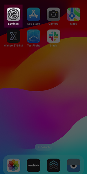

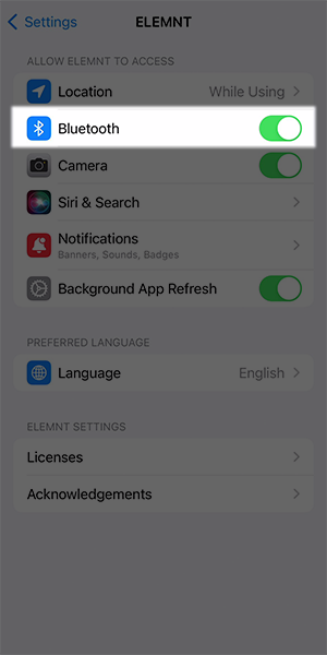

  2. On iOS 13: A new prompt to allow Bluetooth for individual apps was added to this iOS version, separately from the iPhone's main Bluetooth settings. If experiencing continued pairing issues, check the following:
    1. Open the main iOS Settings app.
    2. Scroll down to select ELEMNT.
    3. Ensure that Bluetooth is toggled on.

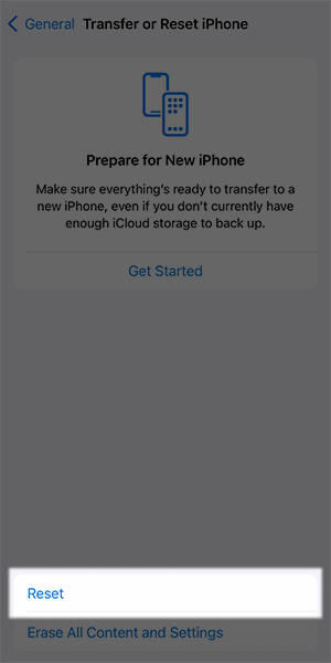

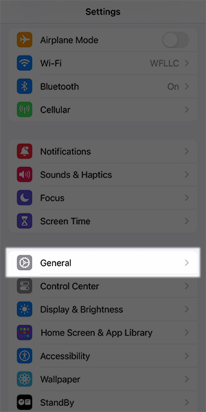

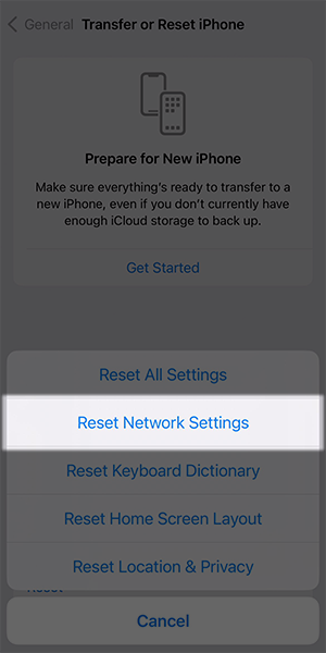

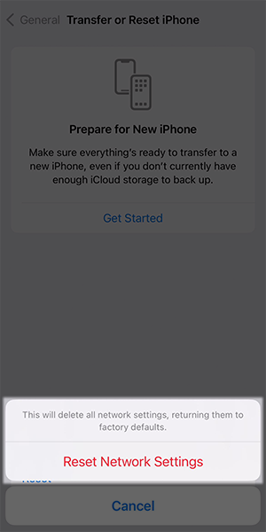

  3. Last resort -- Reset your iPhone's network connections -- This will reset all Bluetooth and Wi-Fi connections.
    1. Navigate to iOS Settings > General > Reset or Transfer or Reset iPhone > Reset > Reset Network Settings and confirm.
      ios-homesettings-300.png ios-settings-generalselected-300.png ios-settings-general-resetselected-300.png
      ios-settings-general-reset-resetselected-300.png ios-settings-general-reset-reset-resetnetworkselected-300.png ios-settings-general-reset-reset-resetnetwork-confirm-300.png
