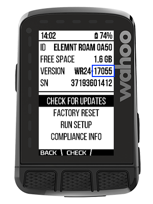

Like your desktop or laptop computer, ELEMNT computer firmware consists of two parts, [1] a lower structural level operating system layer (ROM) and [1] a top app layer that you interact with.
The | ROM | is identified with a two letters followed by two numbers (ex WR24 or WB17). The | app | layer is identified with five numbers (ex. 17055).
ELEMNT ROAM System Info screen with the ROM version WR24 outlined next to Version ELEMNT ROAM System Info screen with the app version 17055 outlined next to Version
ROM version app version

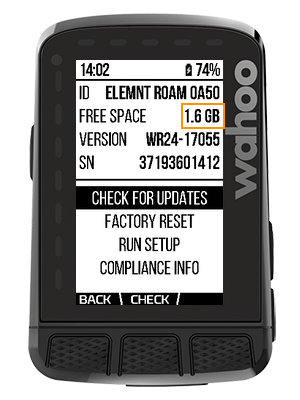

Check firmware version and free space
You can check your computer's current firmware version and free space on the System Info page of the computer itself.
ELEMNT ROAM Ready to Ride screen with Start Ride highlighted at the top ELEMNT ROAM menu scrolled down with System Info highlighted and OPEN above the middle button ELEMNT ROAM System Info screen showing Up to date with Check for Updates highlighted
  1. The computer should warm up to the Ready to Ride screen, with Start Ride highlighted at the top. If it doesn't, tap the button on the left side of the computer to access the Ready to Ride/Menu screen.
  2. Tap the upper button on the right side of the computer once to cycle up to the bottom of that screen. System Info should now be highlighted.
  3. Tap the middle button to select Open. You should now see ID, Free Space, Version, and SN, and Check For Updates should now be highlighted.
  4. Confirm that you have at least 500MB of Free Space.
    • This generally is only a question with the first generation ELEMNT, BOLT, or ROAM.  The computer needs at least 500MB of space to download the new firmware version to memory before loading it.  If you have less than 500MB, you should create a little more space by temporarily deleting some map regions that you don't plan to ride in soon. Details on how to do that are described in the Add, update, or delete Maps on an [ELEMNT] article.  Note that there's no risk of loss here, as you can always re-download those maps for free using the process described in that article.
    • If you have at least 500MB, keep reading.
ELEMNT ROAM System Info screen with the ROM version WR24 outlined next to Version ELEMNT ROAM System Info screen with the app version 17055 outlined next to Version ELEMNT ROAM System Info screen with Free Space of 1.6 GB outlined
ROM version app version free space

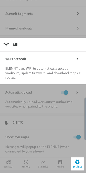

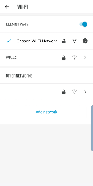

Check for a saved Wi-Fi network
To check that you have a Wi-Fi network saved to your computer, navigate in the ELEMNT app to Settings > Wi-Fi.
Connected networks are saved on the ELEMNT computer and will automatically reconnect when in range, regardless of the computer's pairing status with the ELEMNT app.
  • If a network is saved and connected, it will appear immediately below the ELEMNT Wi-Fi toggle with a check mark beside it.
  • If a network is saved, but not connected, it will appear just below the ELEMNT Wi-Fi toggle, but without a check mark.
  • Networks that are in range, but neither saved, nor connected will appear below OTHER NETWORKS.
ELEMNT app Settings tab with the WIFI section and Wi-Fi network option highlighted ELEMNT app Wi-Fi screen with ELEMNT Wi-Fi on and a saved network marked with a check mark
