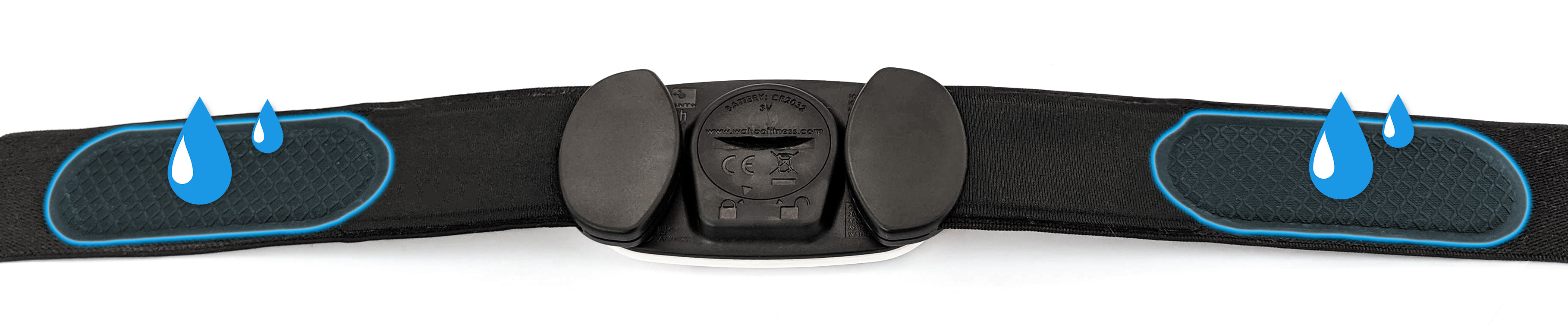

- Check the fit - ensure TICKR is worn snugly on the chest, directly against skin for the best connection (movement or slipping may disrupt readings). Always moisten the electrodes before use, as shown in the images below:
New TICKR & TICKR X:
Original TICKR & TICKR X:
