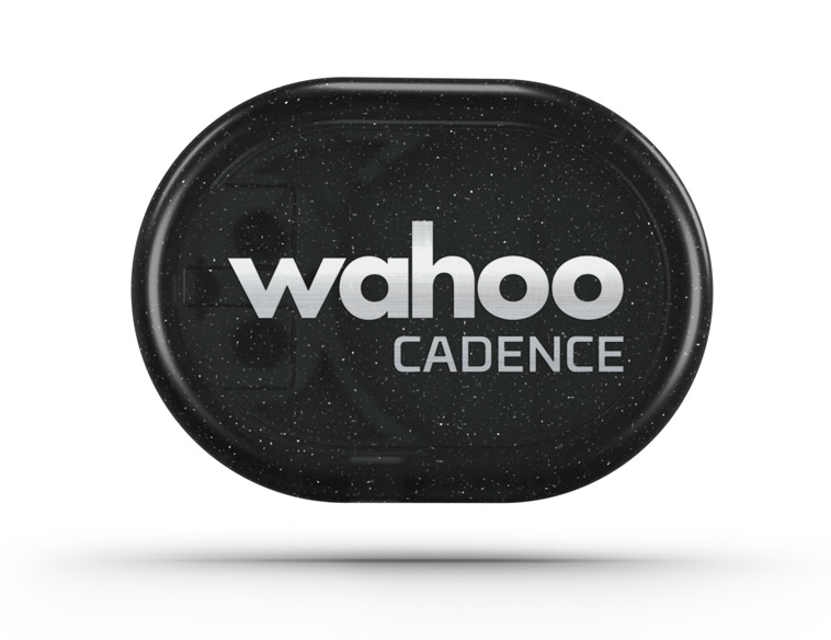

  • Wahoo RPM Cadence Pod

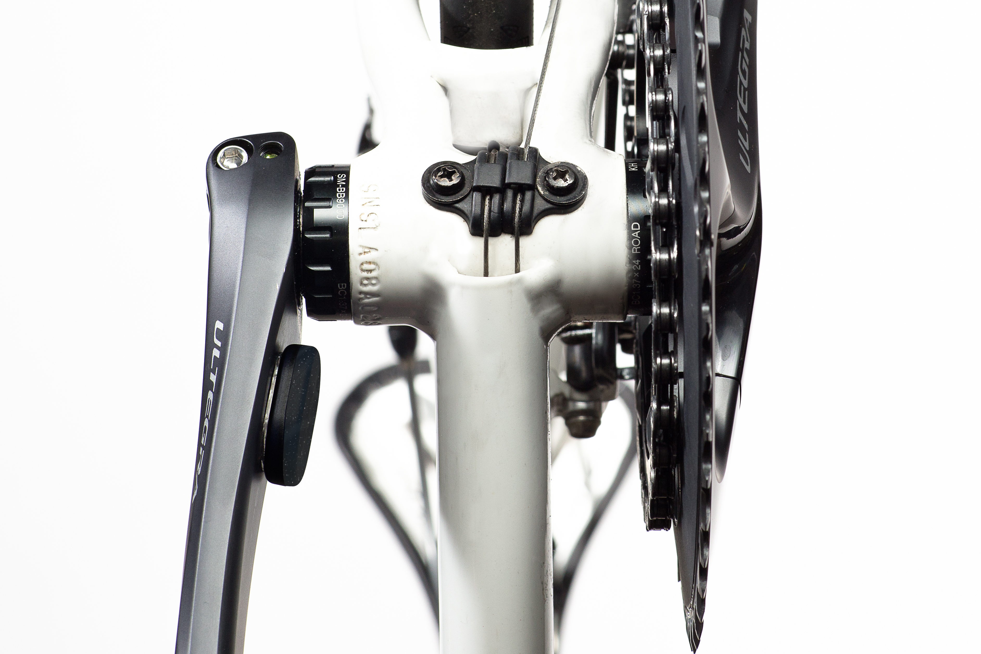

Using the Silicone Mount:
  • Slide the Wahoo RPM Cadence pod into the silicone mount. Make sure the silicone covers the Wahoo logo and the opening is on the back of the Cadence Pod.
  • Loosely thread one zip-tie through the slot on one side of the silicone mount and connect it around the crank, without tightening fully.
  • Place the Wahoo RPM Cadence on the inside of the non-drive side crank arm (side without gears) as close to the center of rotation as possible without rubbing. Spin the crank around to make sure the Wahoo RPM Cadence does not interfere with the chain stay or rub other parts of your bike. Tighten once correct positioning is achieved.
  • Slide the second zip-tie through, tighten, and trim the excess length on each zip-tie.
Using 3M double-sided tape:
  • Ensure the RPM Cadence and the inside of the non-drive side crank arm are clean by wiping with isopropyl alcohol and a soft cloth.
  • Peel off the tape's backing to expose one side of the tape and stick it on the back side of the Cadence Pod. Then remove the other side of the tape and stick the Cadence Pod to the inside of the non-drive side crank arm (side without gears) as close to the center of rotation as possible without rubbing, as shown below.
  • Spin the crank arm to make sure the Wahoo RPM Cadence does not interfere with the chain stay or rub other parts of your bike.

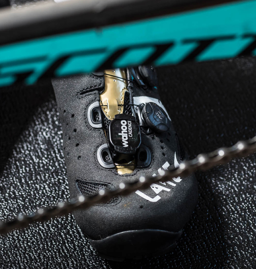

Using the Shoe Mount:
  • The shoe mount makes it easy to switch between bikes, shoes, or riders.
  • Start by inserting the hard plastic mount in between the laces of your preferred cycling shoe, parallel to the length of your foot.
  • With the logo facing upwards, insert the Cadence Pod into the mount and twist to secure, as shown below.
