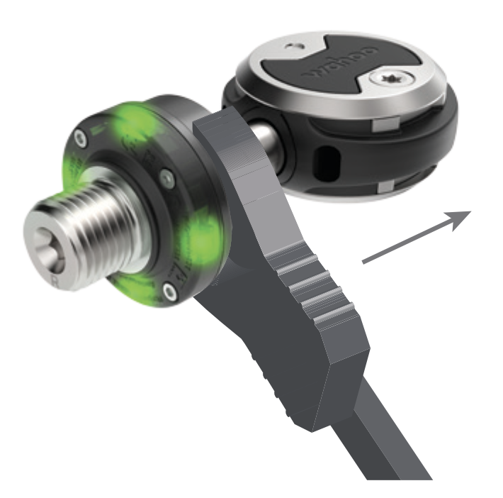

    3. Thread the pedals onto the correct crank arm
    • Use an 8mm Allen Wrench to ensure a snug fit.
                                     Recommended tightening torque: 30 Nm.

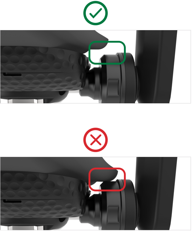

  • Ensure clearance between shoes and Power Pod
    Check that the SPEEDPLAY POWER Power Pod and your shoe do not touch. Repeat these steps for the opposite shoe. For more information on shoe compatibility, please see the SPEEDPLAY POWER Shoe Compatibility Guide.
      1. With the pedal on the crank arm, clip your shoe onto the pedal. Remove your foot from the shoe.
      2. Rotate your shoe around the spindle to check for clearance.
    • If there is adequate space between the shoe and the power pod (they should not touch at any point) you do not need to use the Spacer.
    • If there is not adequate space then you will need to use the Spacer to provide more space and prevent potential damage to your shoe. Go back to step 2 in the cleat installation instructions to install the Spacer between the Base Plate and Housing.
    Caution: Failure to check for pod and shoe clearance may result in damage to your shoe and/or SPEEDPLAY POWER. DO NOT use SPEEDPLAY POWER if your shoe comes in contact with the Power Pod. This will void the warranty.

  • 1. Ensure the power cable is securely connected to a power source and to the charging clips.
    2. Attach the charging clips to the Power Pod. When firmly attached, the green LEDs will illuminate.
    Note: The Wahoo logo on the charging clip should face outwards toward the pedal body.
