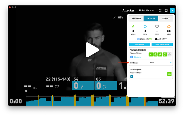

How do I select ERG mode for my trainer?
Connect your smart trainer to the app following instructions found here.  ERG mode should appear in the Settings box below your trainer connection.
