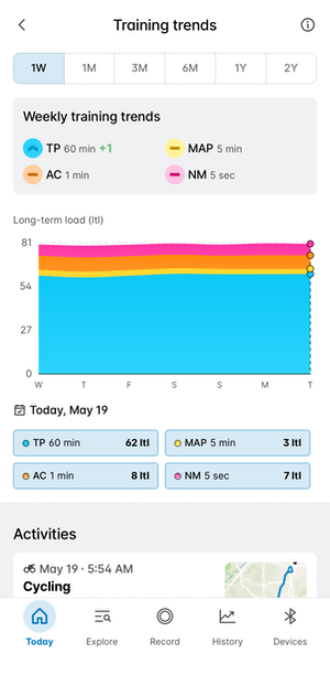

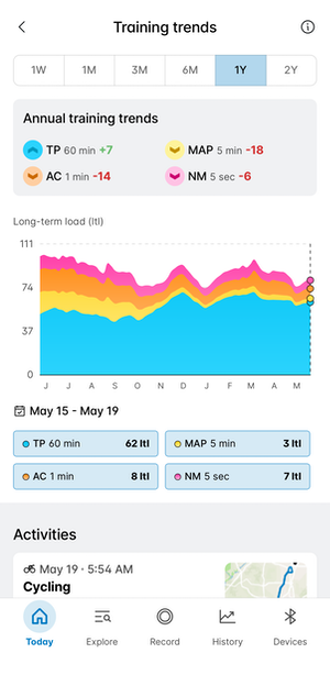

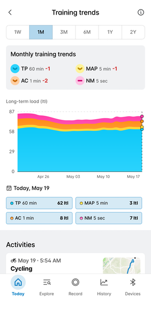

Technically not a metric, the Training Trends data visualization presents your composite Long Term Load (total LTL broken down into the four key 4DP®/3DP® dimensions: Threshold Power/Pace (TP), Maximum Aerobic Power/Pace (MAP), Anaerobic Capacity (AC), and Neuromuscular (NM)) on a given date and across a time window (looking backward from today) that you select (1 week, 1 month, 3 months, 6 months, 1 year, 2 years). It allows you to view the impact of your training to the 4DP®/3DP® component categories over time.
The Training Trends panel will display a gain (from training load accumulated by workouts) or loss (due to adaptive decay) value for each 4DP®/3DP® category across the time window currently selected (1 week, 1 month, etc).
You can also select various points in time along the X axis of the graph, which will then display the Long Term Load [LTL] value for each 4DP®/3DP® category at that point in time, and provide a list of activities completed in the interval immediately before that date with their total DTL score, duration, and 4DP®/3DP® training load distribution with a link to the Activity Details page for each activity.

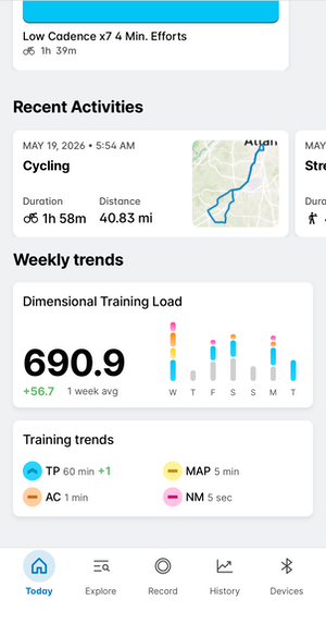

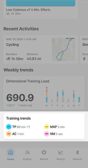

To access the Training Trends data visualization panel, navigate to the Today tab, select the Training Trends button. Once on the Training Trends page, you can select your preferred time window for analysis.
Wahoo app > Today > Training Trends
